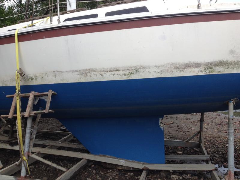

The first question I have is regarding the hull paint job I'm doing. I used a transition cleanship antifouling blue paint for the part under the waterline, and the white part on top is looking pretty weathered. It's the original paint and I'm not sure I'll be able to make it shine again. Someone is recommending a new product paint called 'fast dry?' But I'm not sure about that. Any ideas are highly appreciated.

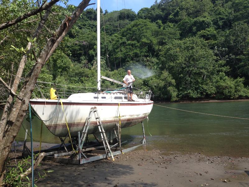

Anyway, some pics here. That in the boat is my friend and boat co-owner power washing the deck. It turned out pretty nice. And If you think the outside looks trashed, i will eventually post pics of the inside.... :-(

The hull will likely shine nicely again with compounding. Check the polishing link on MaineSail's section of this forum.

I second njlarry's comment. No need to paint the topsides, just a really good compounding and polish and it will come back.

At first glance your cradle looks better than you describe. Closer inspection seems to reveal that the keel isn't sitting on anything more solid than loose soil. The bottom of your keel is where most of the weight of the boat should lie, with the perimeter supports providing stability. There should be little weight on the perimeter supports and where the the supports meet the hull, there should be plywood squares of at least one sq. ft. each, built up to roughly conform to the curve of the hull, and covered with thick carpet. Otherwise, it's likely you'll deform the hull at those areas, and risk significant damage.
You have much more important things to do right now than painting or compounding the topsides (portion of the hull from waterline to gunnels). Scrub it clean and call it good. The best and easiest way to clean the topsides is with an acid cleaner like Mary Kate On Off. You really should have done the topsides before putting your bottom paint on though, as the acid will eat the bottom paint. You can use tape and thin plastic sheeting to create an apron around the waterline, so the acid doesn't get on the bottom paint. See MaineSail's (this forum) advice for cleaning before compounding polishing for details. You brush the acid on, and rinse it off seconds later, and the scum is gone. You would be wise to call that good enough for the topsides right now.
