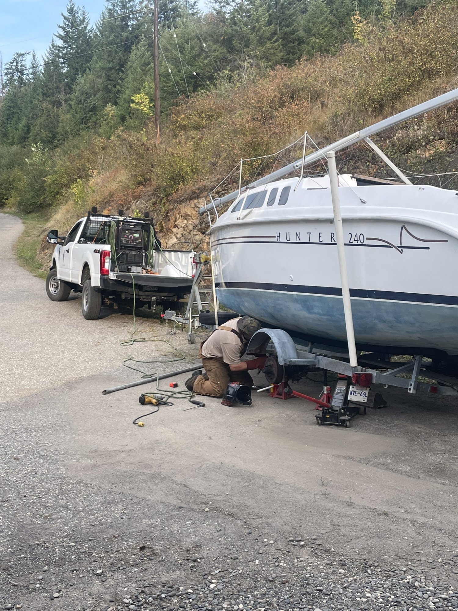

We unstepped the mast, (so nice to do) packed everything up, did a walk around and Michelle says, UHOH. Turns out a bit too much force was applied pulling and obviously a weak weld let go. The shackle broke off the left side of the trailer and the axle moved back 3 inches jamming the left tire against the fender. We hugged and laughed, what a bad ending to a great day lol. Michelle made it home way before me thanks to her sister rescuing her. I did make it home eventually with the boat and trailer. I now have a quick weld to do lol.

We’re fixed and ready to go again. My son came by and we welded the trailer shackle. We actually strengthened both sides. I was talking with another gent, he said be careful if you ever unload at paddle wheel. He said they hit a large hole pulling out their pontoon boat. I said, that’s where we were when this happened.
