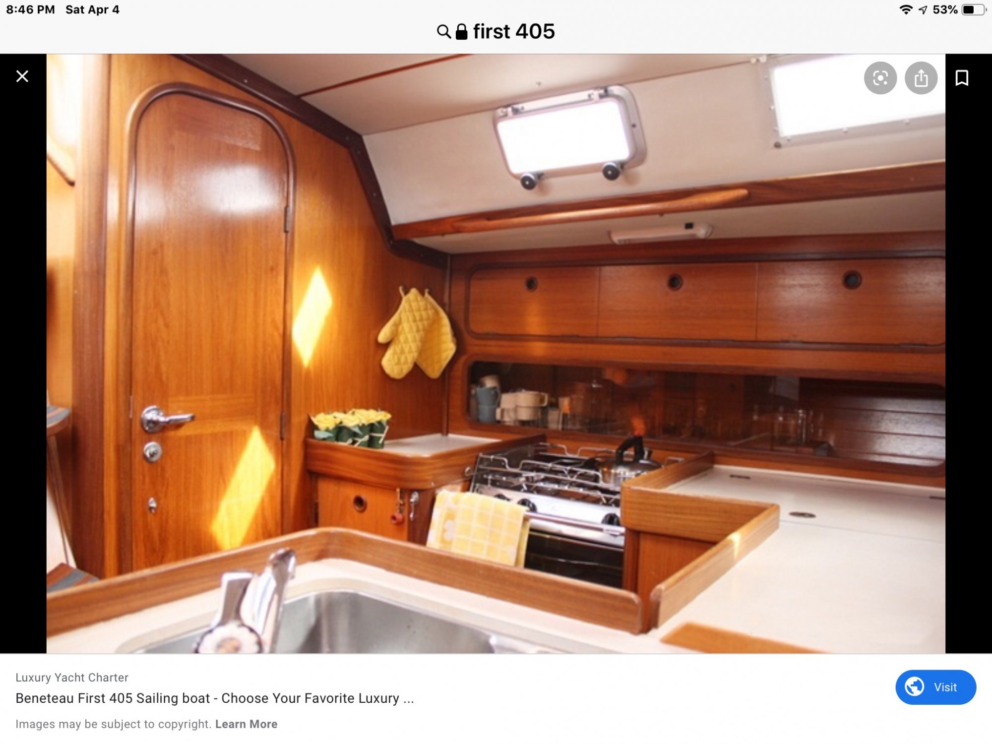

I am rebuilding a 1987 first 405 and need to know if anyone knows what type of wood beneteau used for the interior. There is a clear diference between the flat panels( bulkheads, cabinets,etc) and the trim around cabinet doors which is much darker( teak or mahogany). I need to order thin veneer to recover bulkheads since they are glassed in and sheet goods for cabinet construction. I do like the contrast between the light cabinetry and the cabinets trim. I has a hunter 37 that was all teak and the interior was very dark.

Thank you for your replies. I think stain may be the way to go. It wood keep the teak plywood from darkening over the years. Also, using waterborne finish would keep the wood much lighter over time. Petroleum based finishes yellow and darken over time.
I had not thought of playing with stains.

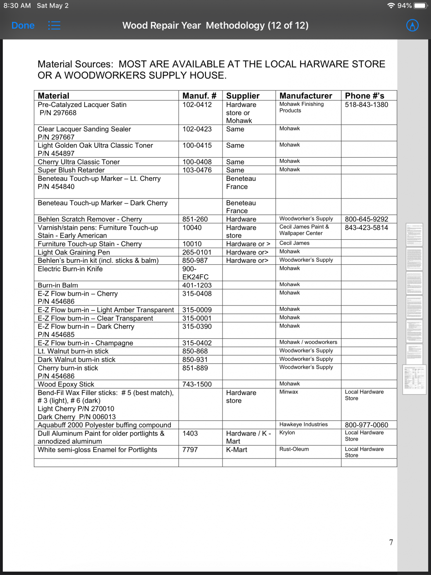

Beneteau definitely uses stain mixed with catalized/precatalized sealer in their factory finishing process. Certainly makes it more difficult to match, when refinishing Lowe’s used to custom mix Cabot stains to match your specific application; however they no longer offer that service. Perhaps you can contact an independent paint store for a custom mixed stain that will make it somewhat easier to obtain a good color match.
Beneteau also recommends Mohawk laqor spray for use as a sealer; however, I wasn’t pleased with the outcome when refinishing my companionway ladder. Resorted to using min wax helmsman spray poly and was very pleased with results.

I don’t have any info about the wood itself, but I do have some information on the finish products that I got from Beneteau a few years ago
