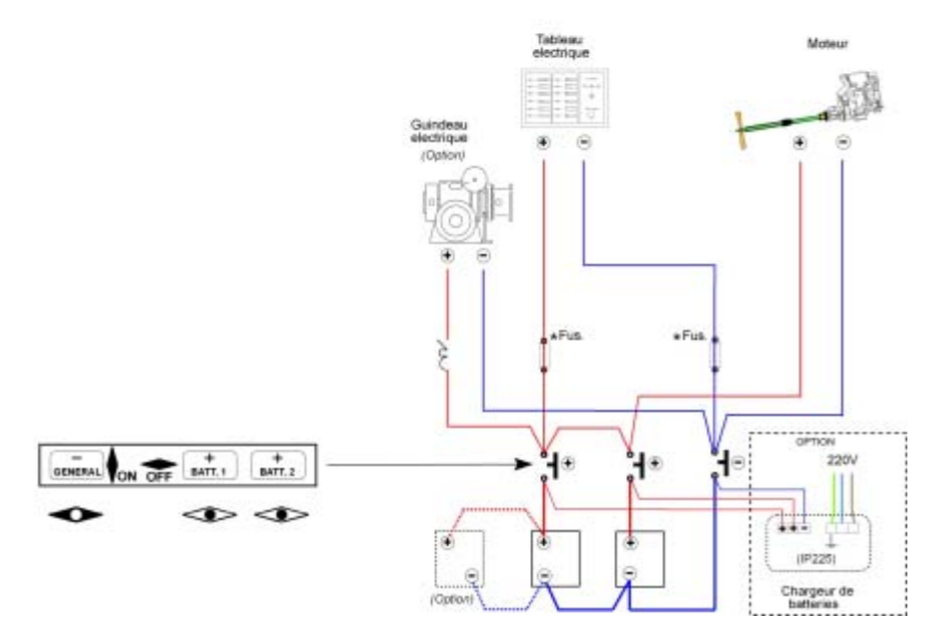

This is a very common mod on the 367, and indeed on most modern Benes. Normally if you remove just the jumper, BAT1 becomes STARTER and BAT2 becomes HOUSE. If it will not start with just BAT1 on, something strange is going on. Like your engine panel being wired to the house?
Note that the switch on the picture is backward because it show it looking aft and the schematic is looking forward.

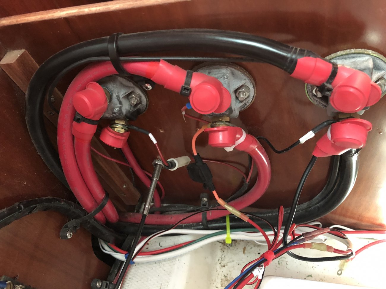

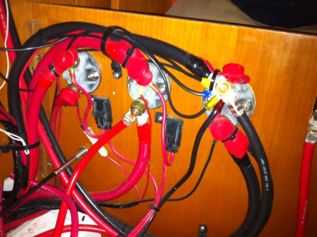

I agree... with further refection I can't see how a blown fuse would effect only one of the situations. Here is a pic of the area on the 367 with the jumper removed. One of the smaller red wires might be the panel wire (which IIRC is code) attached here instead of at the battery. Is one not on?
But it is strange. The fault would imply that the panel wire was powered by one switch behind a relay energized by the other.

Looking at your picture, you have two red wired with inline fuses I don't have. The small red wires with white fuses, I'm pretty sure, are for the voltage meter on the breaker panel. You then have two other red wires with black inline fuses, I don't have those. I attached a pic of my switches. The orange wire with the fuse was added by me, it's for my auto pilot RAM.
Sorry for not posting the image inline, I can't figure out how...
