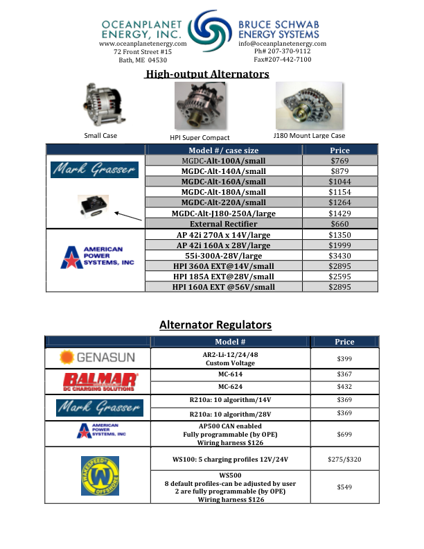

Since you will have to run the engine about every other day to charge the batteries when you’re out on the hook, I’d look into upgrading the alternator to reduce engine run time and make more efficient use of the diesel. Maybe a CMI-80 with external regulation.

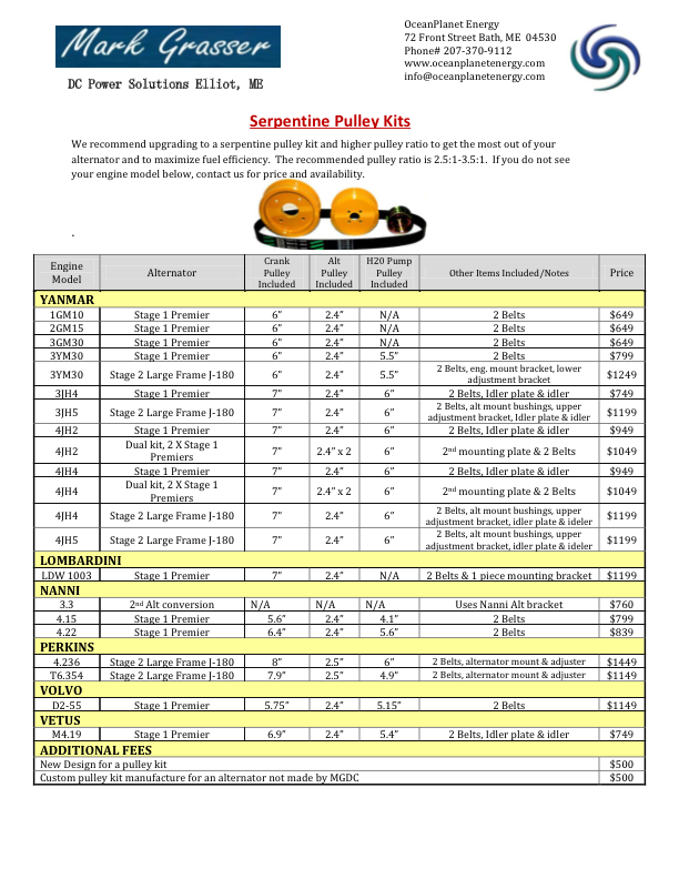

After thinking about it, how about going for a 150 amp Balmar with a serpentine belt, and leaving the shore charger alone? You will typically be deep cycling on the hook, so why upgrade both the shore charger and alternator when I think it would be about the same cost to just go big on the alternator.

I'm with @Stu Jackson on this. Why spend the extra money on Fireflys? True deep cycle FLA batteries will do just fine. Think about 6v golf cart batteries, 4 of them will give you ~440 amp hours. It will need a new charger, one that can support about 50 amps, like a Sterling 1250. A larger externally regulated alternator will be helpful too, but no need to go with a 150 amp Balmar for your usage. The CMI 90 amp should be sufficient for your plans. 4 new GC batteries, a new charger, and a new alternator and regulator will set you back about the same as 3 Fireflys alone.

If you go Firefly you will want at the very least a new charger and at a bare minimum external regulation. This makes the whole cost a rather big pill to swallow, about 3.2K to 4K in total and that is if you DIY the entire thing....
