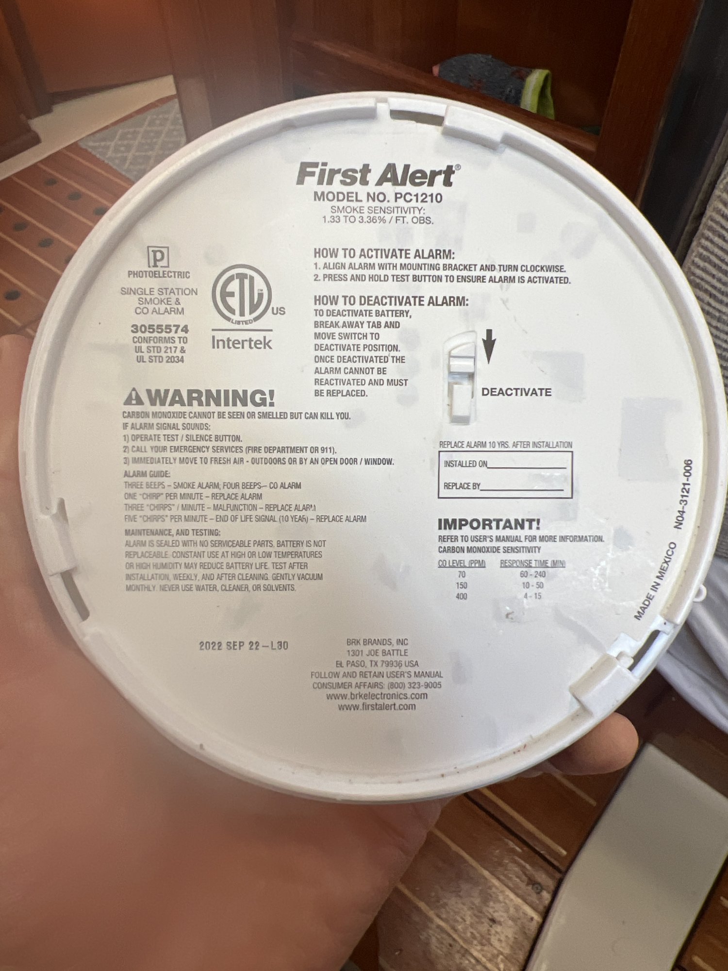

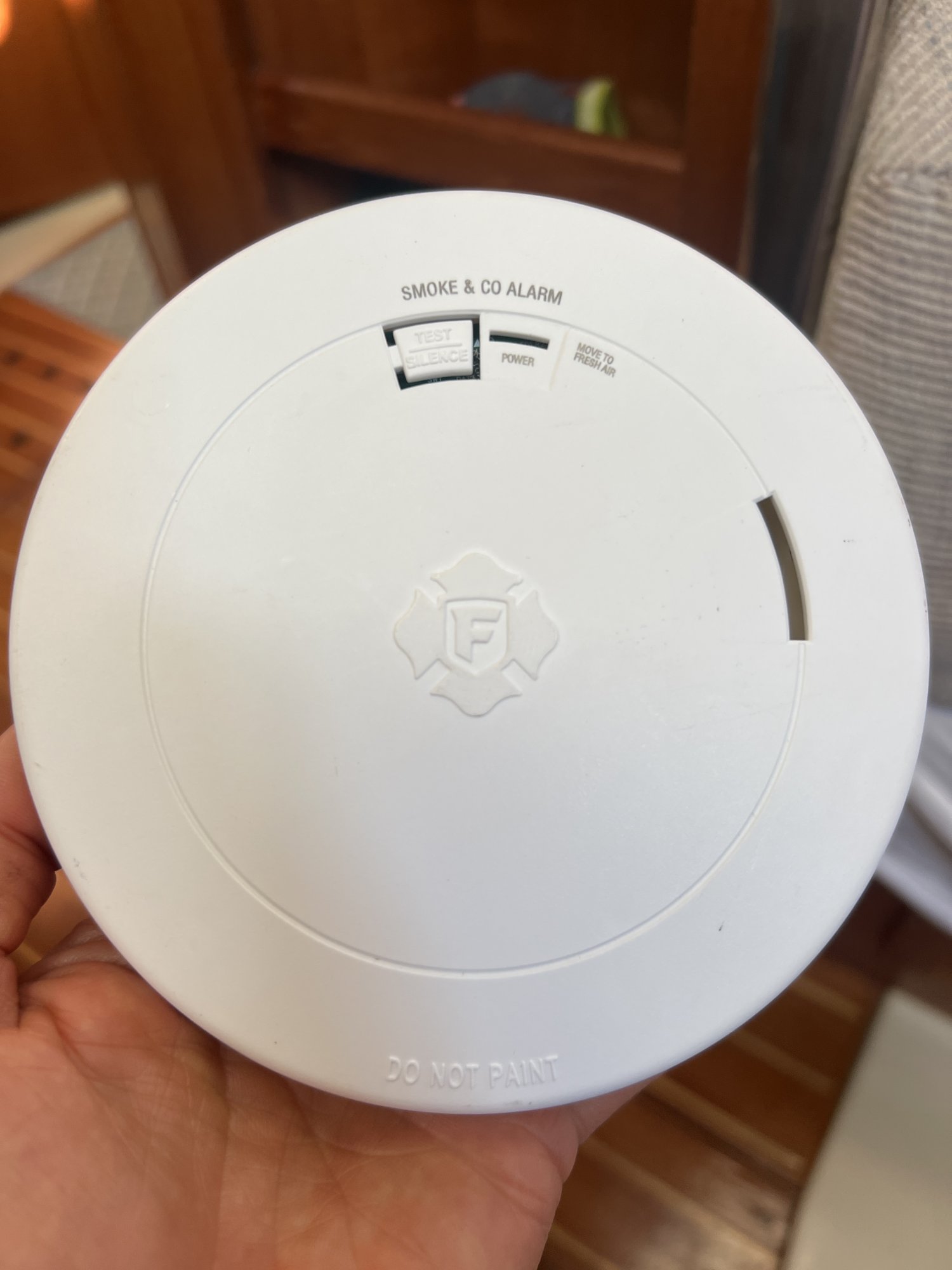

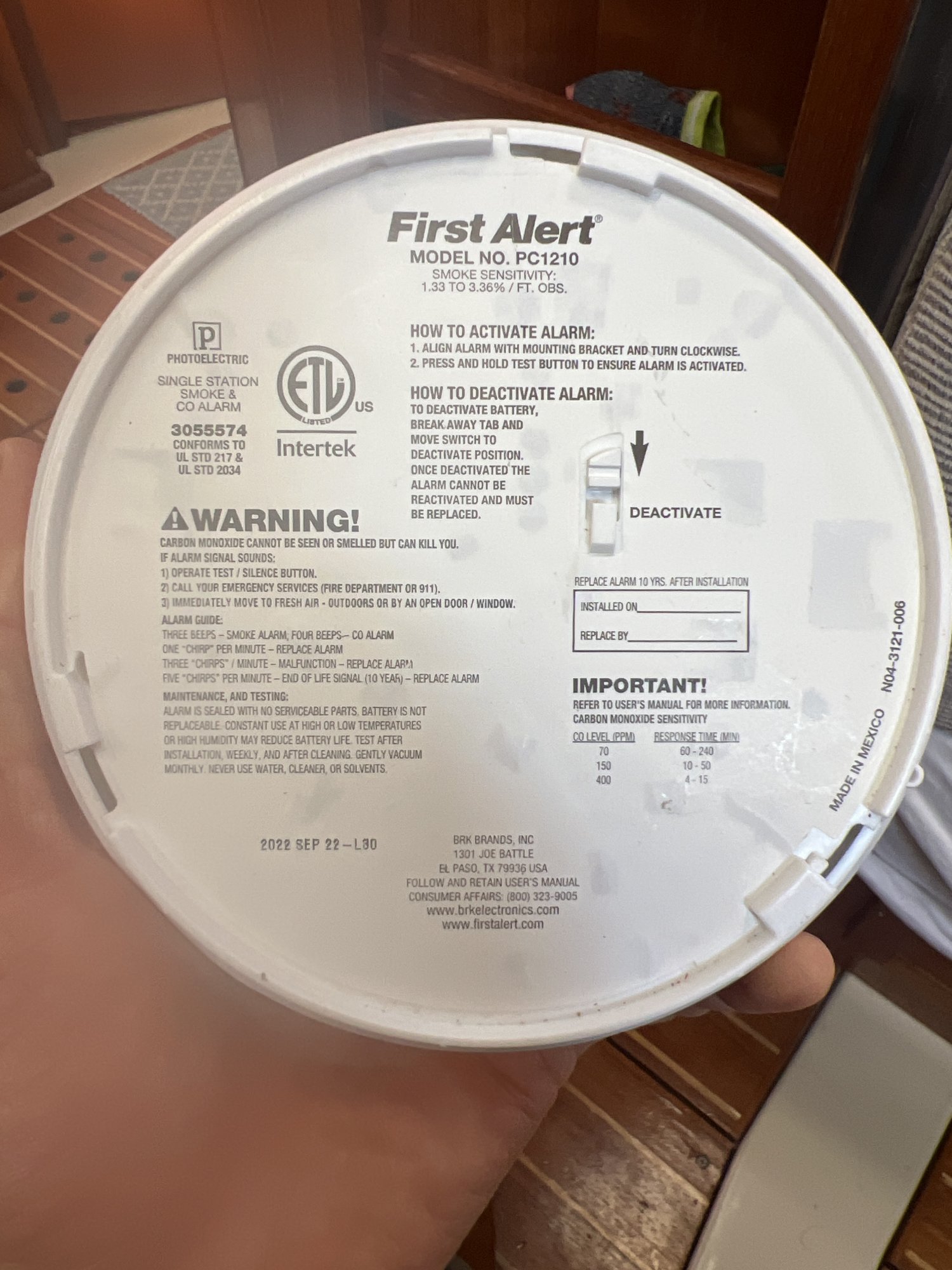

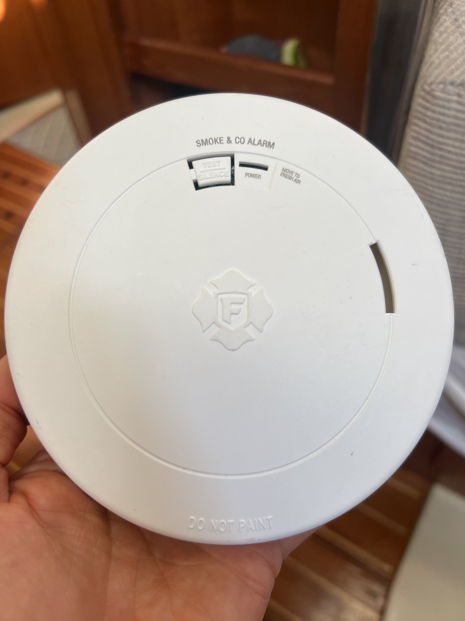

Has anyone found good smoke/fire/co2 alarms to use onboard? The FirstAlert ones we have keep going off randomly, sometimes in the middle of the night. Maybe due to humidity?

Do you have lead acid batteries? Or stored solvents? Are the alarms near them? Outgassing batteries and solvents will cause false CO alarms. I don't think humidity plays a part unless it is actually steam in the air.
Otherwise, I think we have the same combined units as you do, and don't get false alarms (no lead acid batteries and solvents all stored outside living space).
Mark
Lead acid batteries, but stored outside in the aft cockpit locker, so likely not the issue. No solvents onboard.
