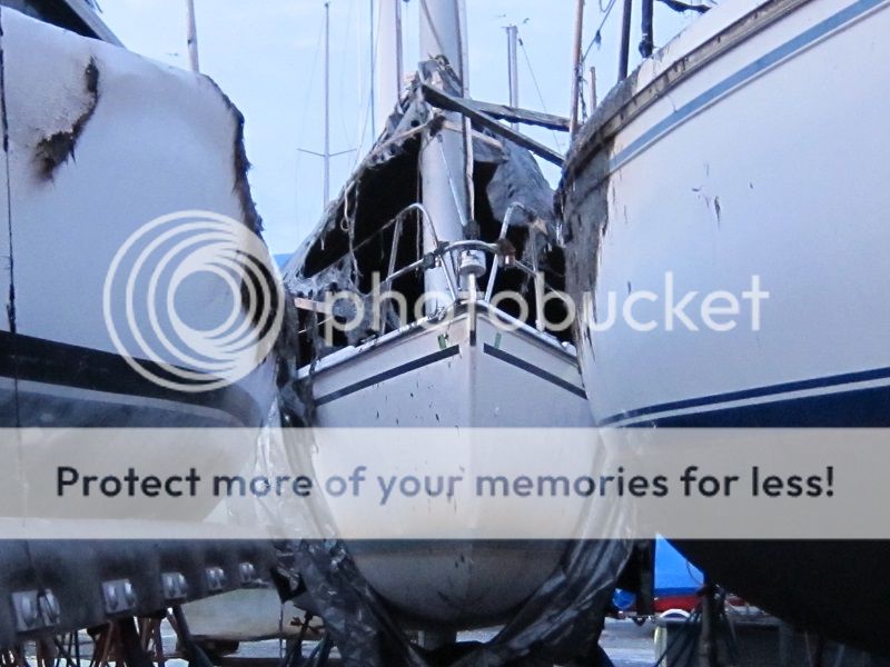

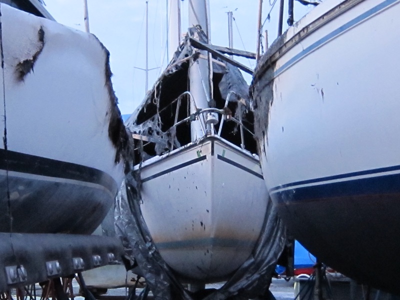

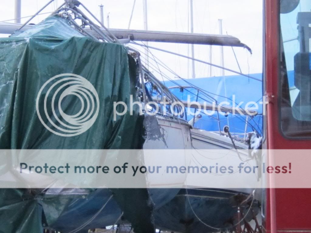

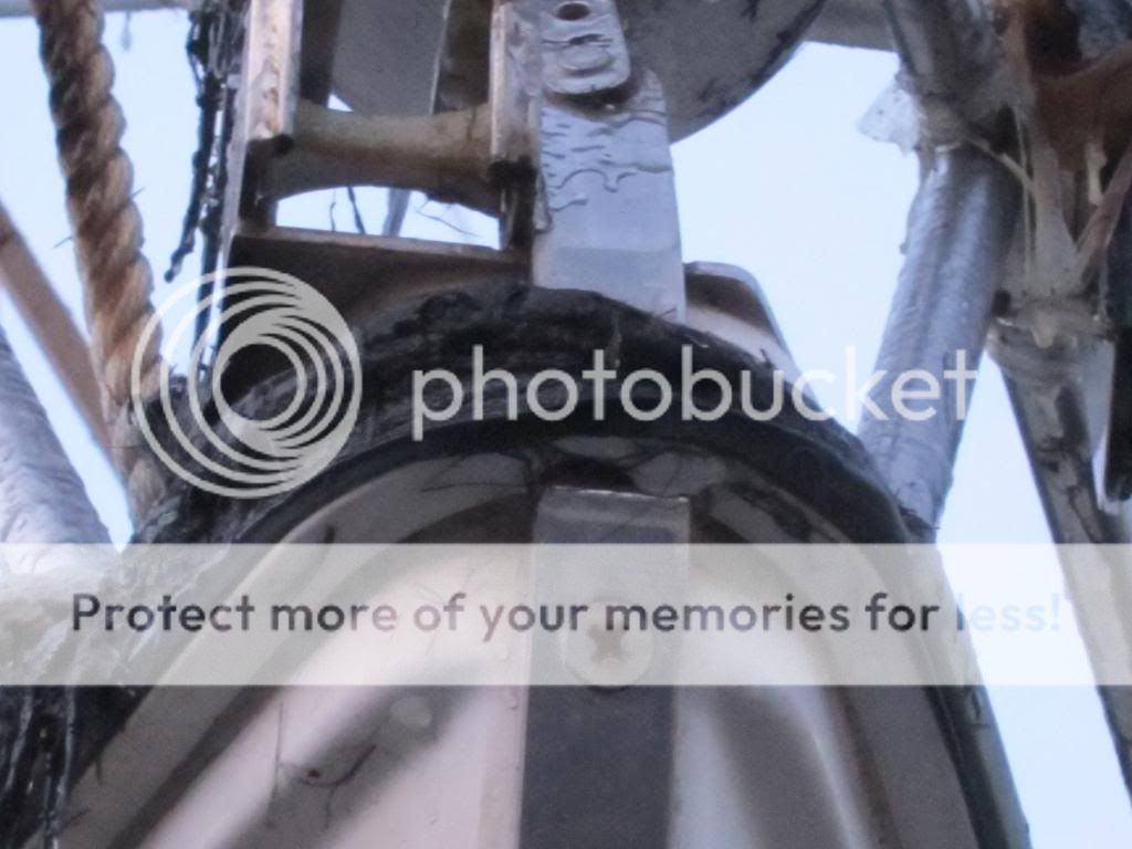

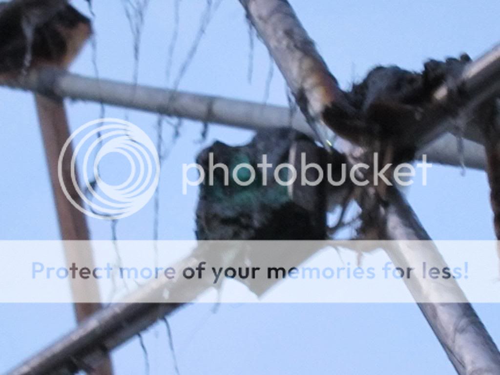

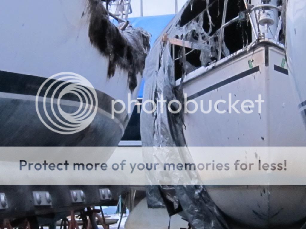

There was a fire at White's Hudson River Marina last night. A couple of boats near mine were destroyed. Mine got, at the least, some heat damage. Furler luff melted, nav lights melted, winter cover half burnt off, rub rail looks shot.
For all you experts out there ... could there be hidden damage from the heat? Insurance company will get a call but I want to go into this with a little knowledge under my belt!

You will have a pretty big claim but I suspect any hot spots in the glass can be easily repaired. Matching the gelcoat, good luck with that...??
This is a PRIME example of why most marinas and yards have rules that specifically ban boats being left plugged in while on the hard. Up here many yards send guys out to yank the plugs out of the power posts..
I can almost guarantee the boat that burned had shore power connected and this was either an electric heater, overload of the Twist-Lock shore inlet socket or battery charger related...

Do a close inspection of your rub rail and the hull/ deck joint underneath wherever it was exposed to high heat. There's one bow pic in there that looks particularly bad if that one refers to you boat. Sorry for your loss.

update on the survey ....
Surveyor found some glass delamination on the starboard bow. With that repair, new furler, nav lights, anchor rhode, rub rail and insert, etc., the total came to about $6,400.
The claim remains open in case they find additional damage to the hull-deck joint after they take off the rub rail .....
