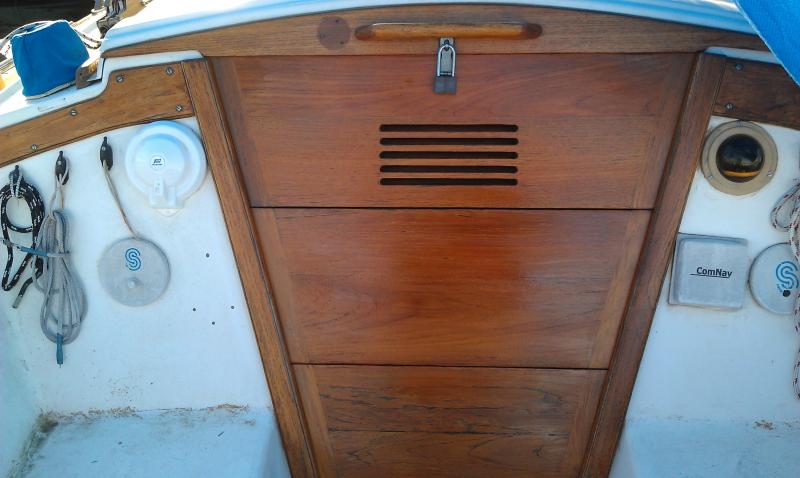

I have been having good results with Min-Wax's Helmsman Spar Urethane. See pic below. About $20/qt at Home Depot. I'll never use Cetol again...But if you're lucky Rich H. might post a few pictures of his boat's magnificent brightwork
