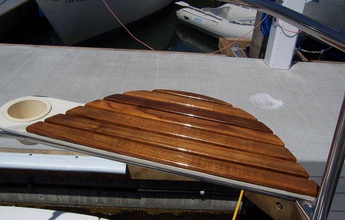

........ and you'll see that such things as amine blush are from a previous generation of epoxies. System Three can be thinned with up to 10% lacquer thinner for a primer which makes it like water and takes hours to cure. It still cures to a hard consistency. I usually apply about five coats. Just remember to finish with varnish (2-3 coats) for UV protection and it will last many years. Follow the book religiously and you'll get something like this:
The stairs are covered with glass cloth for wear resistance and the rail seat has not been revarnished for many years.

Nice stairs. Who made them.
The treads are the original varnished (about 1/2 coat) teak stock (1") that came with the new boat. They were starting to look pretty shopworn after a few thousand gritty little feet pounding up and down over five years. I took them off and dadoed out the original grooves they used for non slip and filled them with black epoxy. I've always looked back and thought I should have made them holly in colour. I have 20/20 hindsight. Glassed them for wear resistance and covered with five coats of epoxy resin. Still look like wet varnish today and the gritty little feet are now teenage girls so not quite as much wear and tear as before.

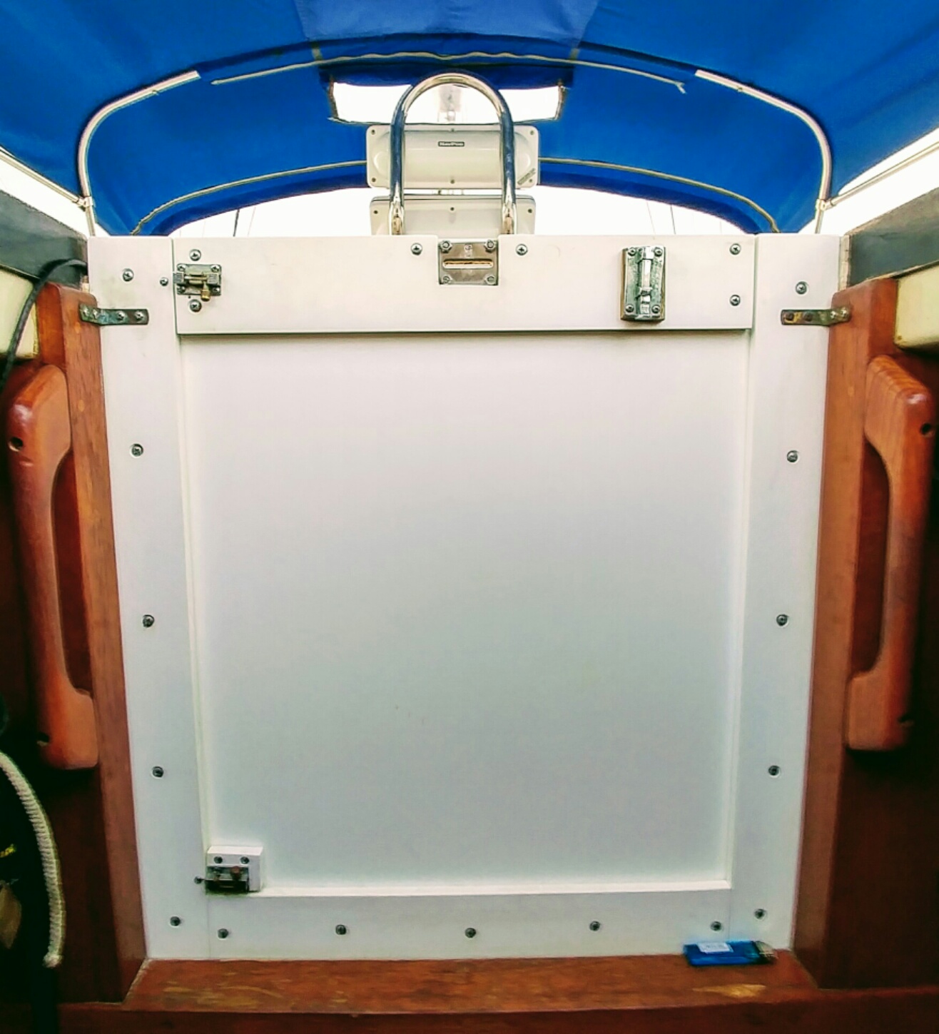

You might want to consider Starboard. Zero maintenance and plenty strong. It comes in a variety of colors, as well. Personally, I prefer a door, as below, but that might not work on a 25 footer.

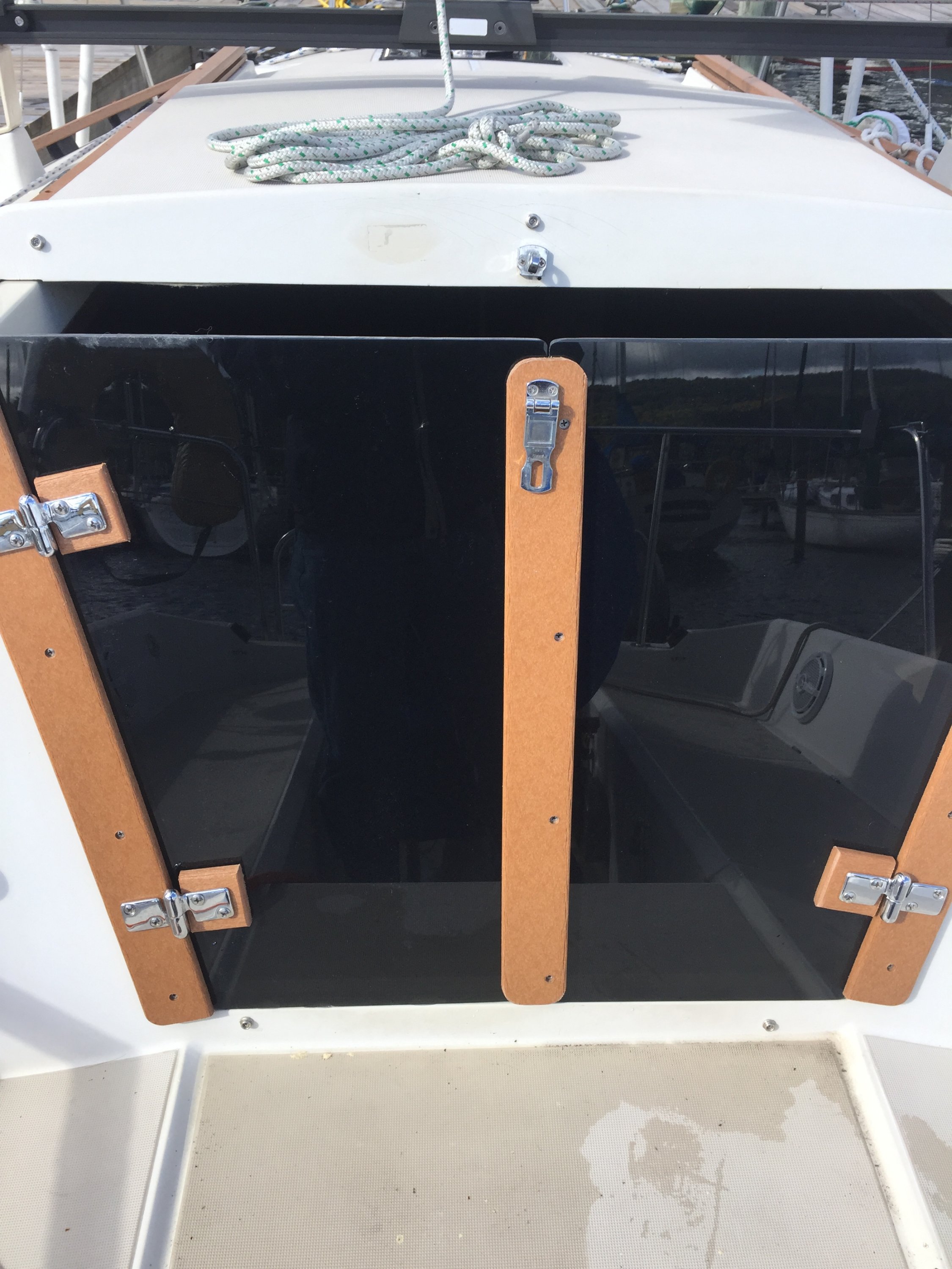

Do not bother with plywood. Make them from King Starboard, or make nice plexi opening doors:

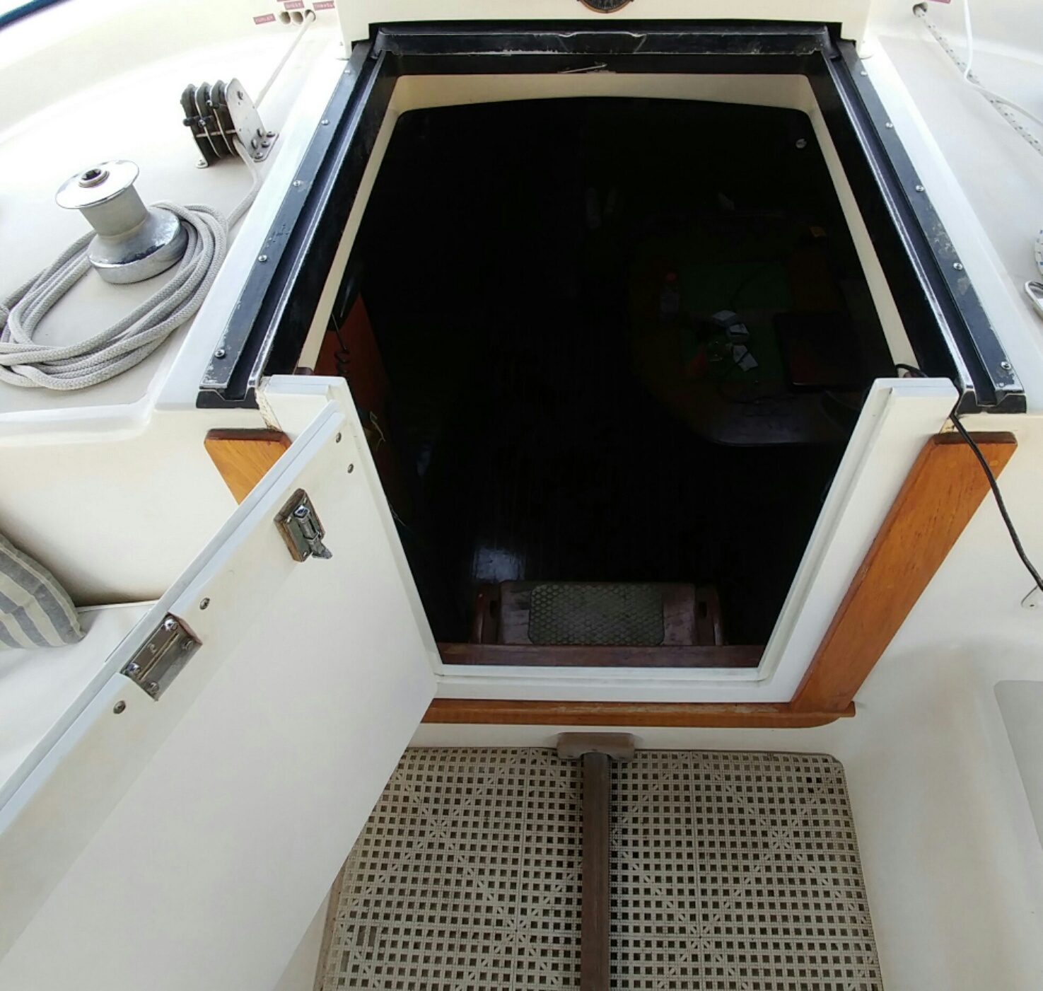

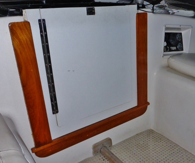

Finally got you a couple of pics. Sorry for the wait. If they don't give you what you need, let me know.
Sorry, can't figure out why it duplicated a picture.
