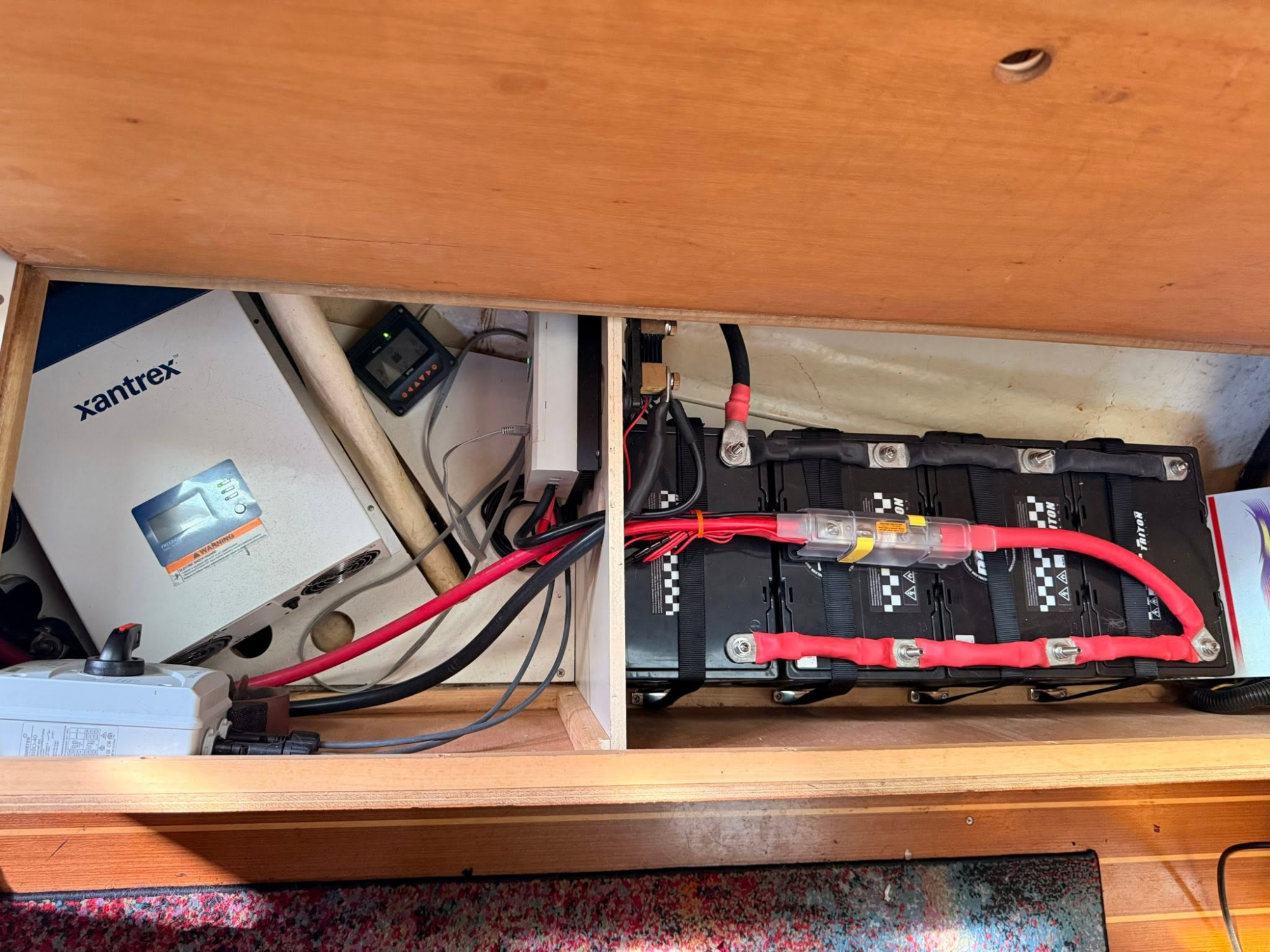

I'm at the last step of figuring out how to deal with lithium battery shutoff after charging is complete and need some advice.
Boat is: 2000 Hunter 450 Passage.
Status Complete
-12v 400ah lifepo4 house bank on bank selector one. Bank two currently unused.
-Xantrex Freedom XC Pro 3000w
-450w solar and 60amp charge controller and Solar Panel DC Isolator switch.
-Replaced all Studs and Buss Bars on 12v side and added conformal coating to all exposed connections.
-Rewired all pos/neg wires with 2/O AWG wire from batteries to bus. Also greatly shortened the wire run by moving batteries under port settee, and rerunning wires through shorter pathing to DC Panel.
-Added Victron Smart Shunt with bluetooth for battery monitoring.

-Add fuse to Solar Charge Controller lead to battery bank (Panels are currently off)
-Route and mount solar charge controller remote panel
-Relocate T-Fuse to safer position away from top of battery.
-I can further reduce battery wire run from battery to selector switch, I made them a little long.

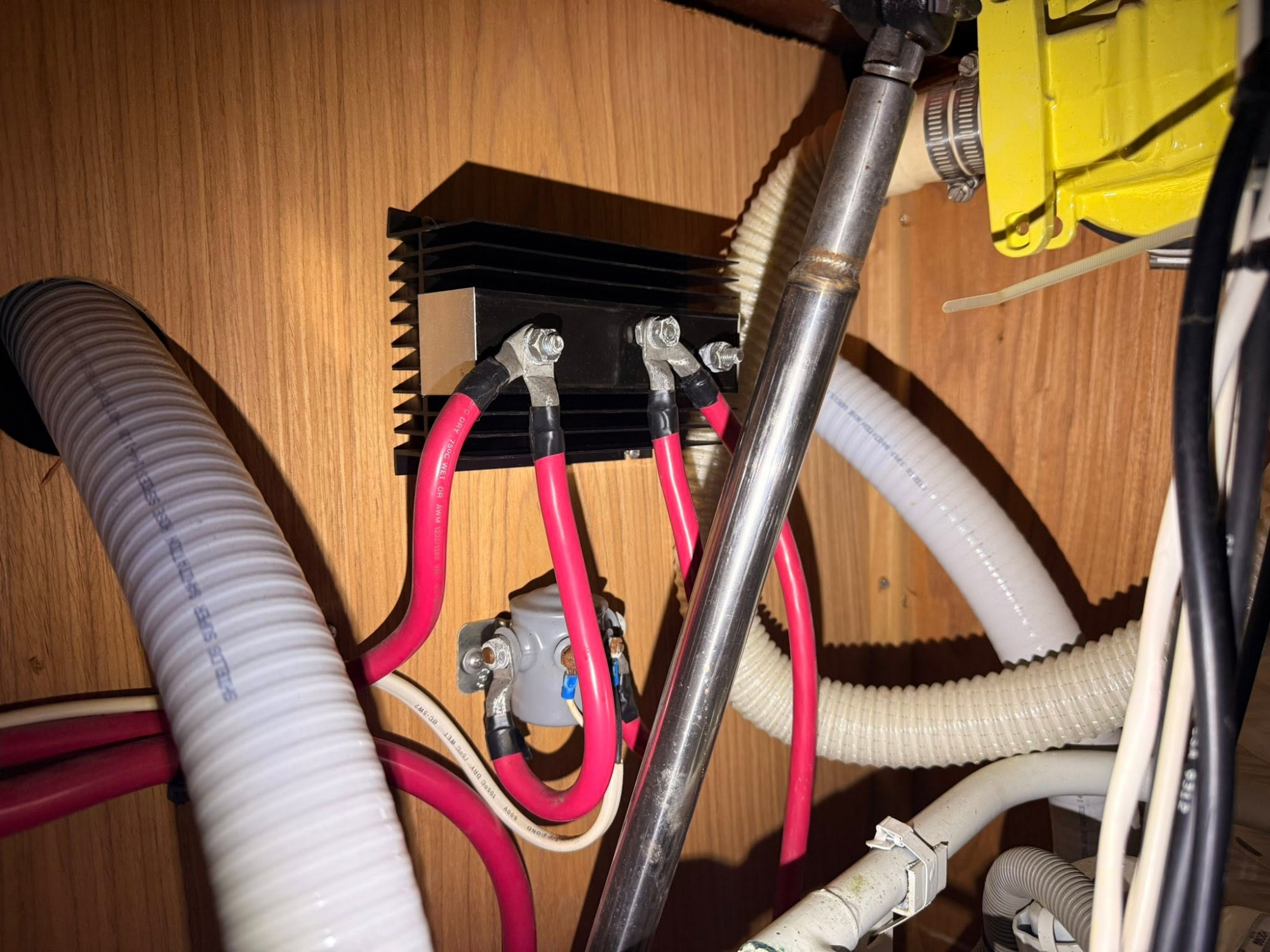

-Battery Isolator and Solenoid behind DC/AC Panel
What I'm confused on is how to deal with the Battery Isolator and Solenoid, and how to prevent lithium battery shutoff and Alternator current being redirected to my 12v systems. Do I remove it and wire the alternator directly to the starter battery then use a DC to DC charger wired to the 12v bus for charging the house bank? What does that look like?

Since you are installing an externally regulated high output alternator you would typically connect the alternator to the LFP house bank and charge the start battery with a small DC-DC charger. Then the solenoid and battery isolator can be removed. As far as BMS disconnects the two main types you can avoid are HVC (high voltage disconnect, either pack or cell), and FCP (full charge protection). Do the batteries have Bluetooth access to the BMS? Do you know if they have FCP? Some do and some don’t.
Absent any details you should be safe setting the MC-618 absorption voltage at 13.8V, float at 13.4V, and adding an APM.

Get rid of them. Wire the alternator to the house bank and use a small DC-DC charger to keep the start battery charged.

No Bluetooth access to the batteries themselves unfortunately. The BMS charge voltage cutoff seems to be 15v, no mention of full charge protection.
This is the information provided by the place I bought these batteries like 4 years ago. I can not find any additional information on these cells at all.
If i can't determine FCP, do I scrap the cells and find something that doesn't have it? Or does the APM solve this issue for me regardless of having FCP on the battery?

The APM does nothing for the batteries, it protects the alternator in the event of a load disconnect on the alternator output. Load disconnects can happen because the BMS shuts the battery down, which is the load or the main battery switch is turned off while the alternator is producing power.

FCP is a recent “feature”, I doubt anyone had it 4 years ago. The datasheet says balancing voltage is 14.0V so you should be fine with 14.0-14.2V absorption.
