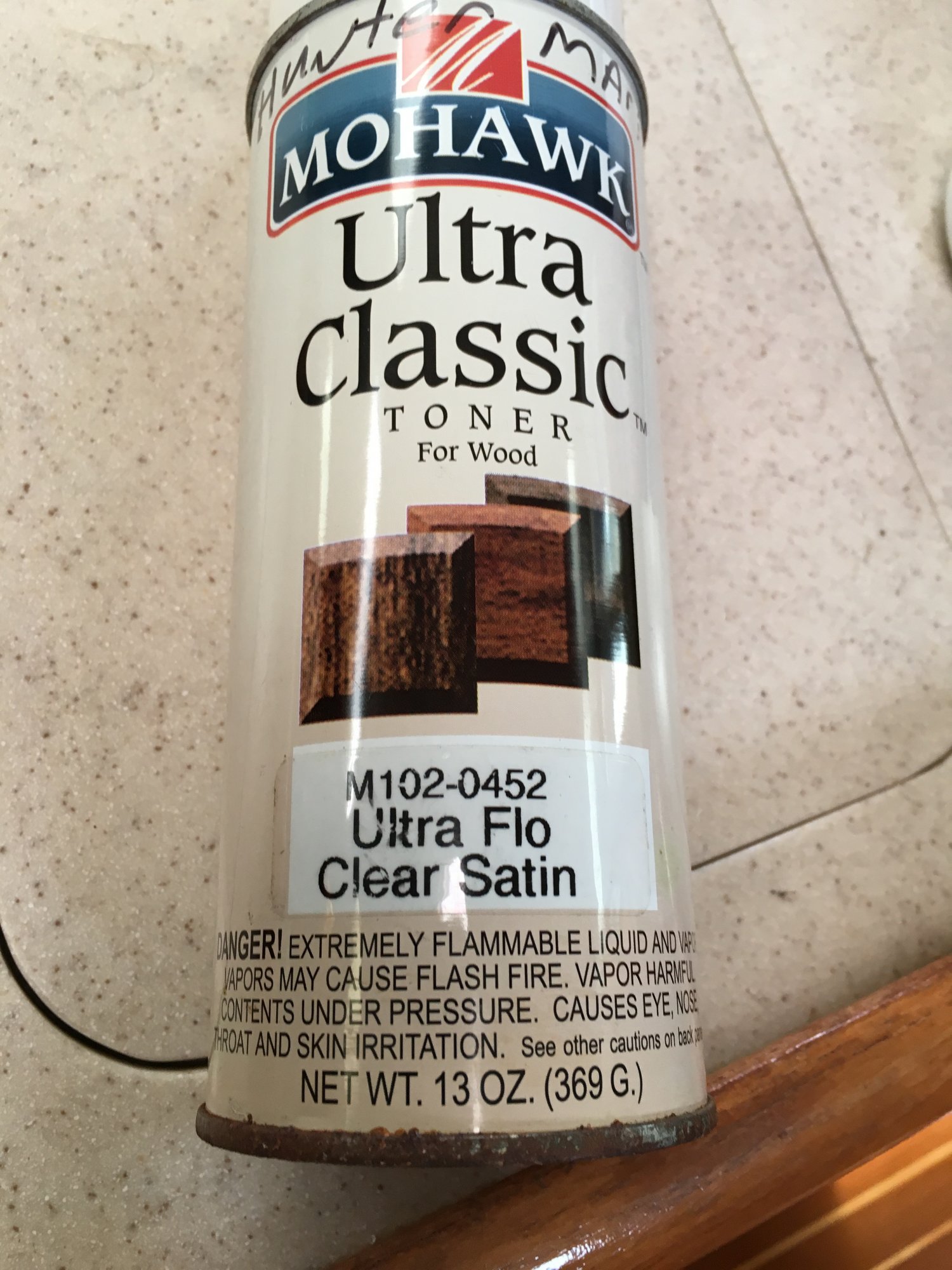

It's the mohawk product, spray lacquer on the 356. you will have to clean off the teak oil, sand very lightly, and restain- either use a teak stain or some people have had success with minwax, I think it was dark cherry #356. The final finish is Mohawk Ultraflo clear lacquer, satin, M102-0452. it comes in a 13oz spray can, can be found on Amazon. Check the archives here, I think the color match for the stain has been posted.

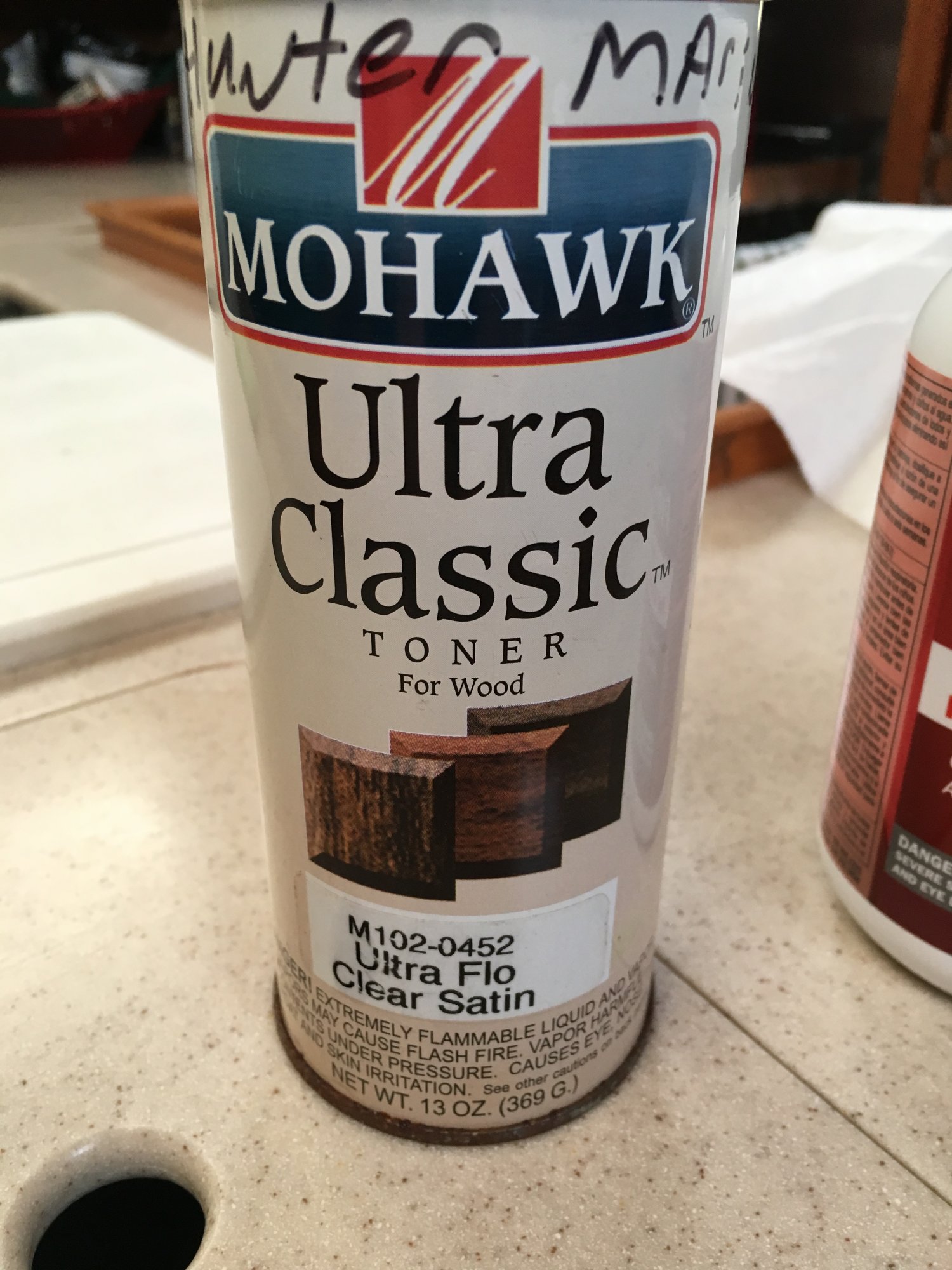

Chucks correct - Here is a picture of the product Hunter used. Get this, spray on and walk away for a while. Has a lot of lacquer and smells strong for several hours. Will touch up all finished on board. Came with my boat at Commissioning and I have bought in the last several years on Amazon. I think the original can lasted me about 15 years.
