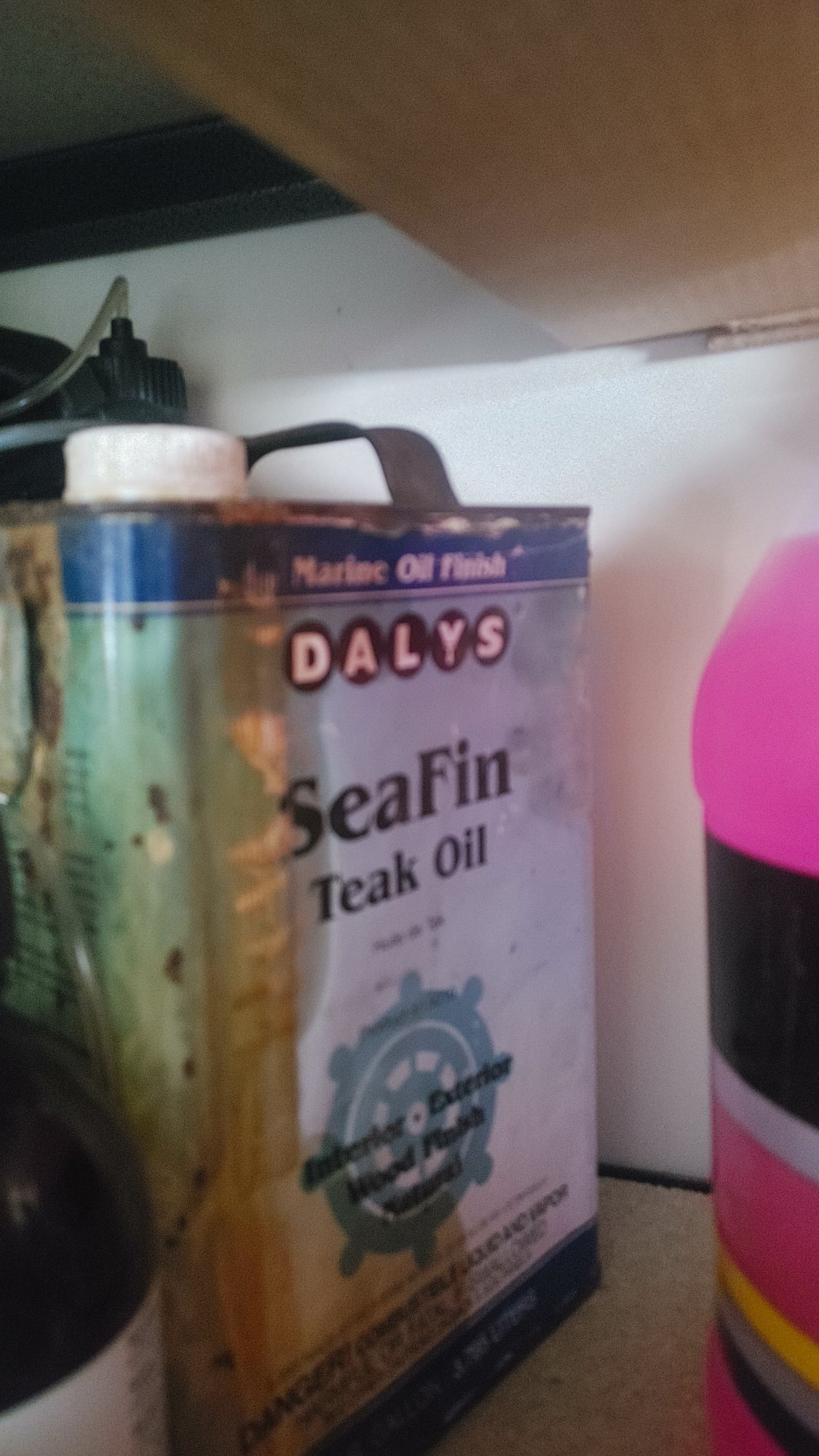

What year of boat early on they Used Dalys SeaFin Teak Oil. I really liked was easy to maintain and do small touch ups
