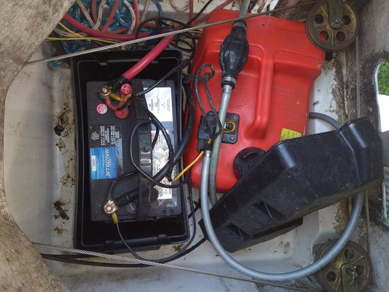

My newly acquired Hunter 260 has a battery selector on the false bulkhead at the back of the aft bunk. Circuit #1 goes to the house battery sitting just beside the selector, no problem there. Circuit #2 goes to a cranking battery mounted in the gas lazarette, beside the gas tank.
I see two problems with this installation. First, the steering wires coming from the pedestal rub on the cranking battery box cover. Second, the power cables from this cranking battery go loosely into two 2’’ open holes through the lazarette/aft bunk wall. This gets me worried. If a big wave hit the stern, water could freely enter the cabin. And I can only imagine what would happen if these holes ever get underwater…
Is this a stock configuration? Am I right thinking this is a hazard?

From your description it sounds like your second battery is near GAS! Yes, I would call that a problem

Thank you all for your answers. I was so concern with the holes that I missed the obvious. Potential sparks and gas!
This is a picture of the lazarette on day 1:
The choice is easy now. I will move the battery inside, grind a wedge and fiberglass the holes and buy some "Terminal Feed Through" for the motor. And gain a bigger locker in the process.

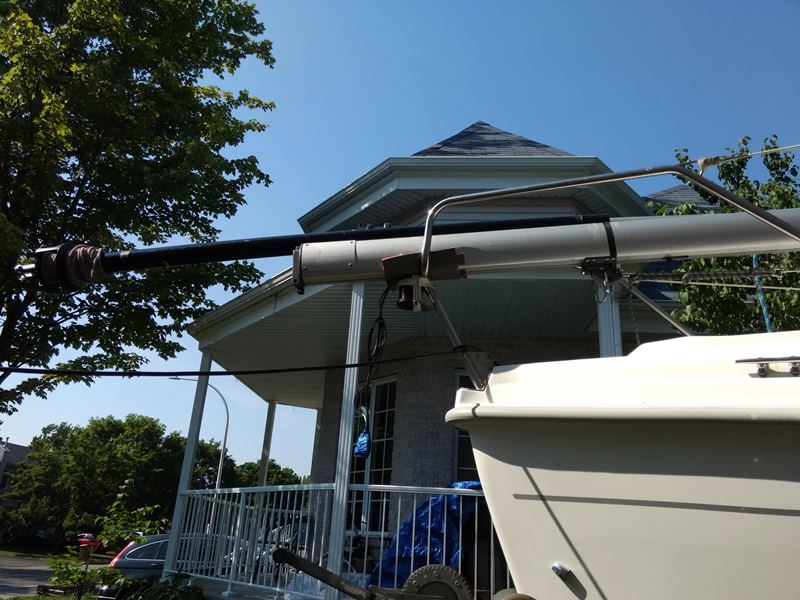

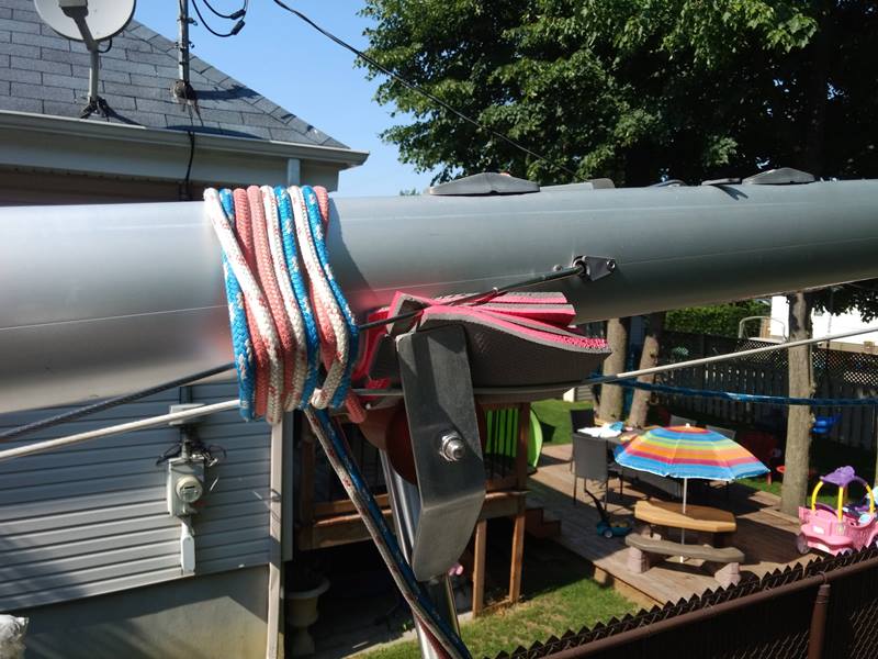

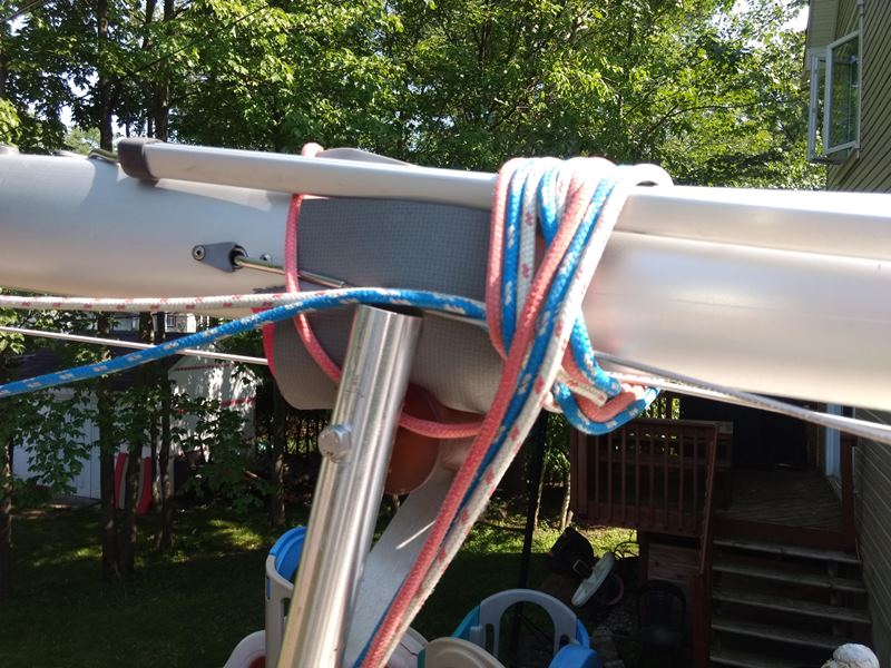

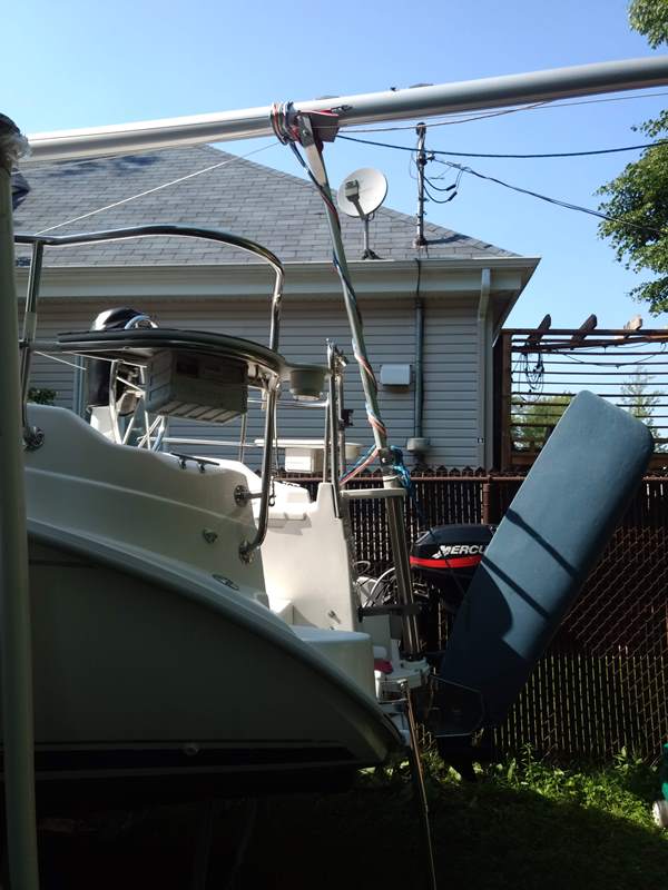

These are pictures of the mast resting naturally on the pulpit and the support crutch (with the mast struts in place). As you can see, I had to put 5 layers of high density foam over the roller in order for the crutch and the roller guard to clear the stays. This is surly not working as intended.
I first thought that the crutch was reversed, bending fore instead of aft. If rotating it 180 degrees will help in “storage mode”, the problem will still be there when I slide the mast aft at raising time. What is the problem with this set-up?
I could bend the crutch even more fore to clear the stays (unequipped for this). Or I could cut the tip of the crutch and the roller guard, again to clear the stays (seems reasonable, but I shouldn't have to). As of now, my only option is to unscrew the mast struts in order to move the mast a bit aft. But I don’t like this option. Any suggestion?

A fairly standard mod that earlier owners did was to drill new bolt holes in the mast crutch and add a larger diameter roller to get the shrouds away from the crutch. I’ll send photos in a bit.
Likes: Kermit

The battery is gone now. Pfiou!
twalter, you are right, the shrouds, not stays! Thanks, I still have to learn the proper lingo in English :). Your idea is interesting. Since the Hunter 260 raising system is so thougful, I am just surprise that we need to do such a fix to make it perfect. But if this is what it takes, I am glad that it is relatively easy to do.
shift the mast forward about 8 "
What do you mean by that rgranger? With the mast struts in place (screwed), the present position is the natural one. In order to move the mast forward, I would need to unscrew them. Surly possible for storage and transportation (although I like the fact that the mast can't rotate with the struts in place). The the problem will remain during the raising prep. What do you have in mind?

Here is a link to where I got my info from on the crutch modification and a lot of other great info. A former site member.
http://kobernus.com/hunter260/mast_crutch/mast_crutcht.html
The advantage with this is if you need to you can always lower again for lower bridge clearance.
