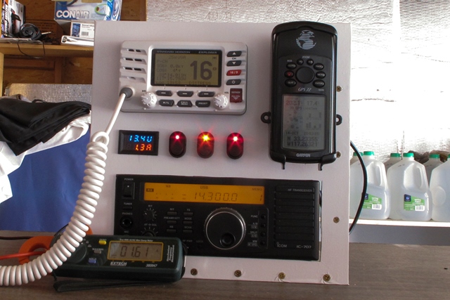

I present to you, my new "comm" station...
I have added power switches to ensure I did not leave something on to drain the battery. The three switches are not labeled yet but the will be (L-R) SSB - VHF - GPS. The small meter under the VHF (far left) is power/current. The GPS is used for the VHF's DSC.
Now, to finish this up, put it in the boat, and get the antenna project done. Motivation has returned.

Power on test!
Everything seems to be OK. Didn't test the Tx function of either radio. I'll do that on the boat. However, I do have one issue that is bugging me. I do not have an accurate shunt and it is showing 300ma lower than what my clamp on amp meter is reading. I am sure there is a way to fix that so I will have to do a lot of research. But for now, looks like this project can be put to bed.

Whoot! Sounds good @Rick D. I have to test using dipoles when I get to the boat. I still need to run coax and tuner control cables aft. I have all the parts for an external 35.5' (plus GTO-15 cable) install. Now that "winter is coming" I can work without dying of heat. LOL
My research is showing me that I will need to nip some of the shunt resistor to bring the current value on the meter up. Have to be careful not to nip too much. I don't think I have a spare one. I thought I bought 2 but does not look that way. We'll see.

If you haven't adjusted it yet, use a file to <slowly> adjust that shunt. I've had similar problems with Chinese shunts - you're lucky you aren't trying to make it less resistance :)

Hi @Hartley! Yeah, I saw a Youtube video of a guy who had the same issue. Not quite ready to apply a hacksaw yet, but the thought has occurred that that could be a simple fix. One day. But seriously, an exact current indication is not all that important. It is just something cool to look at. LOL

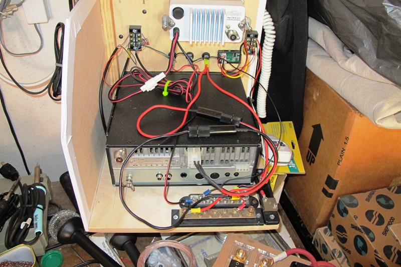

The box is only three sided: bottom, right side, front. But it will rest against one of the bulkheads so that leave the top open and the very back.
The switches are rated at 30amps. I also made sure that the used to feed each switch/radio matched the original. So the 707 is being feed 14AWG from the distribution block, into the switch, the 14AWG to the radio. I was very keen on making sure that each path was capable of support the current requirements.
Tomorrow I will take a photo of the back so you can see the rats nest.

A photo as promised. Please excuse the lens distortion.
