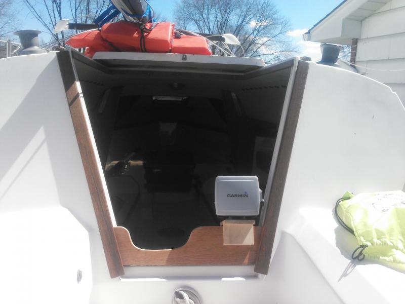

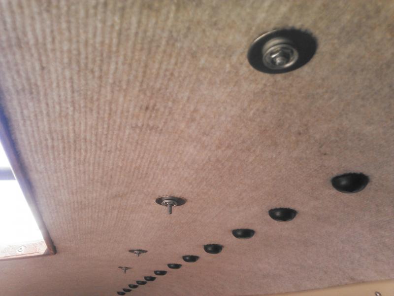

The GPS holder made this winter fits perfectly. When I reinstalled the hatch side trims (in basement for teak oil) I countersunk a small hole in the wood and the fiberglass to make a small pocket for the butyl tape to compress in.

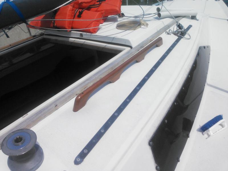

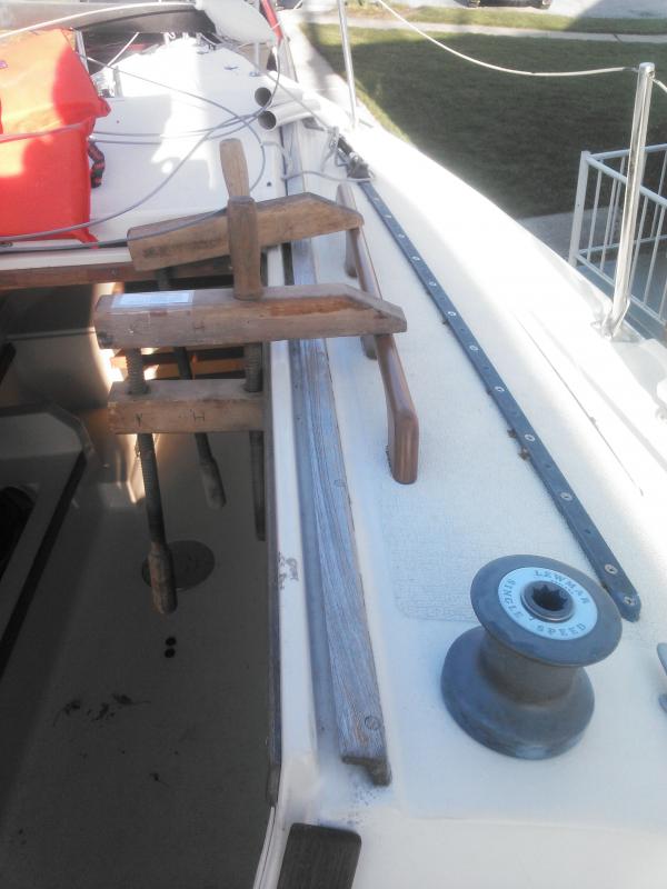

Clamped down the new rails , ran a small drill bit up into them from inside the cabin to mark the locations. Now off to my cabinetmaker buddy this week to finish the bolt holes in his drill press. Plan to countersink holes here for butyl tape also.Also bought oversize S/S washers for inside cabintop. (Wooden clamps courtesy of my Great grandfather, Warsaw/Baltimore 1875-1957. Thankfully , my grandmother was a serious pack rat!)

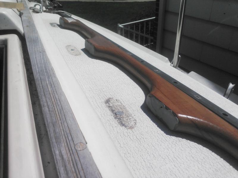

After dark, installed a stow-away system on the boom from John Balch (Balchboats) that I bought Annie for Christmas. (Still paying for that one, by the way
). It comes from him with #6/5/8 long screws. After breaking 3 of them , I switched up to # 8`s and I recommend hand screwing them in, easy to crunch the little white plastic brackets using a screw gun.

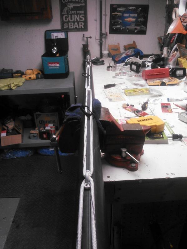

Felt great to be working in the driveway again instead of cleaning up the work bench for the 5/6/7/8th time !
