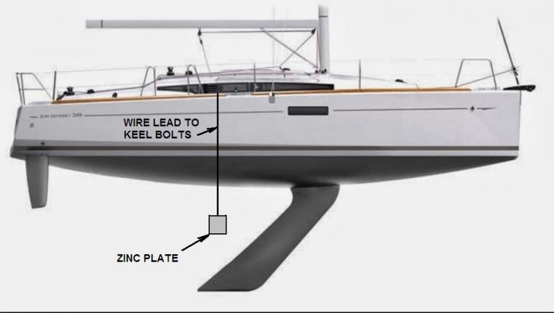

My description of an overboard zinc may have been a little abbreviated.
As shown below, when the boat is not under way, the zinc is lowered overboard in the vicinity of the keel to be protected. The attached wire is lead back into the boat to the swing keel bolts, device or whatever means of attachment and permanently connected. This MUST provide good electrical contact ( 0 ohms).
Before the boat is to move, the zinc plate is brought aboard and stowed. A plug can be used as long as no (almost zero) electrical resistance is present in the wiring.

Oh, that makes since. So it is primarily for when boat not underway. Is the assumption being the most electrolysis happens while a boat is not underway? I guess that is generally true. Thank you for the clarification / explination on how it works.

So it would seem Ralph has a good approach (zinc over the side) because most the time the boat is sitting still - unattended. Thus the keel material will be protected while the boat is sitting still and that is pretty good protection because the boat is parked most of the time.

CAN"T BELIEVE THIS NEVER OCURED TO ME, D'OH!!! LOL:eek:
