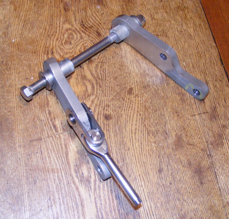

Here are the new lower tangs roughed out and trial fit.
After the riggers use them to template the new stay lengths, they will go back for finishing, polishing, and passivating. The bushings will be drilled out for a 1/2" bolt to replace the 3/8" bolt shown here.

Did you do a FEA on the design by any chance? The parts look really nice. Did you end up water jet cutting them or a milling machine?
No fancy engineering. The thickness is dictated by the cross section at the sides of the hole for the attachment bolt. The outer dimension is restricted by needing to fit inside the existing tubular spreader. Since I'm not going to pay the cost of tapering and shaping to save a few ounces of metal, that leaves me with extra metal in the other portions. Some simple approximations show the worst case stresses even in the asymmetrical aft shroud attachment (longer leg) to be low enough that it's not worth finding out what lies out in the decimal places.
The parts were water jet cut, 50 bucks to cut these and four other parts in two different metal thicknesses. If you can provide a CAD file, it's magic.

I know I'm late to the game on this but I have been reading the posts as your design matured. My question is have you looked at the bending load on the threaded end of the through bolt? That load appears to be transferred to the bolt in the vicinity of the threads, which would not be the best.

Rodger i have one thing that is of concern to me.....the edge distance around the mounting bolt hole ....should it be 1 and 1/2 times the diamater of the hole size.... mind you this is just a laymens rule of thumb in my mind but i just had to ask .....
Roger,
Those don't look to bad to polish.For some reason I thought they'd be longer. Let me know it you want me to give it a crack. I also have enough Spotless Stainless to soak those in to passivate after polishing..
Yes, based on a thinner standard thickness. Cross sectional area of metal is the same as standard chainplate proportions.
That's the old bolt which is being replaced. A vital part of such a design is a custom made bolt so that nothing bears on the threads.
Phil had a ScotchBrite disk that fits on a grinder. He hit the very rough tang with it for about 10 seconds and, zing!, 3/4 way to a decent finish on that half. He's going to get the disks in the range of grades and I think they will be very close to ready for final polish in pretty short order. What I was expecting to be hours of work should be less than one.
