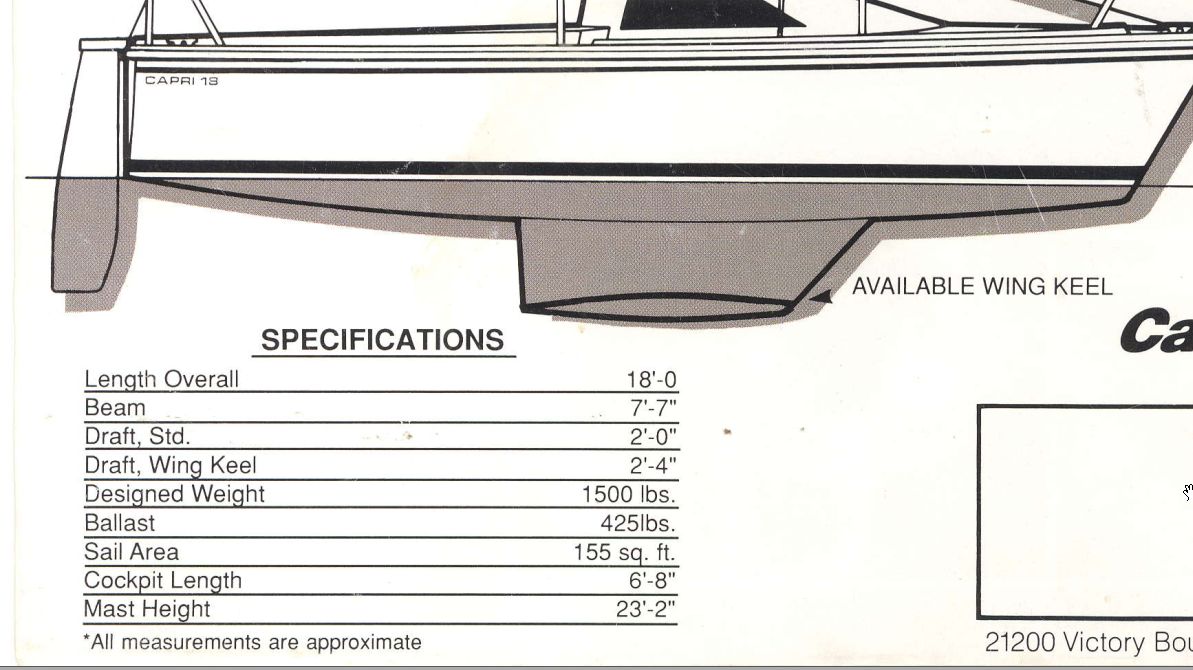

Hi All - I am looking for a Capri 18. Here's what I am puzzled by. The wikipedia entry says: "The boat has a draft of 2.33 ft (0.71 m) with the standard wing keel fitted or 2.00 ft (0.61 m) with fin keel." The implication of many of these threads is that fins come with deeper draft than do wings. Is this Wikipedia entry incorrect? Looking at some online photos of fin keeled 18's it doesn't look that much more than 2 ft from the bottom of the fin to the waterline.

On the Capri 18 with the standard "fin keel", the draft is 2'. I would consider it a shoal keel. My Capri 22 with the fin keel has a 4' draft.
I owned a Capri 18 for about 5 years before I purchased the 22. The sailing experience is significantly better on the 22. Maybe I never had the 18 dialed in properly but the boat always wanted to heel excessively, and gusts would cause it to head up into the wind. It was a constant fight to keep the boat steady in any amount of wind. I sail mostly single handed and I find the Capri 22 to be a much easier boat to sail.
The 18 with the short keel, whether wing or "fin" will be easier to launch. But find a marina that serves sailboats and you should be able to get the launch help you need.
