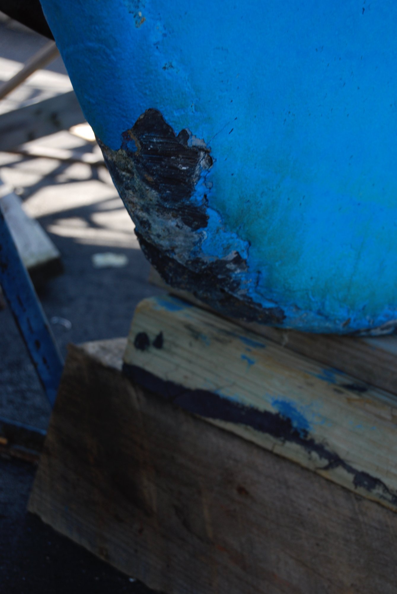

Attached are photos of a boat that ran aground.
This is some of the visible damage to the front of the keel.

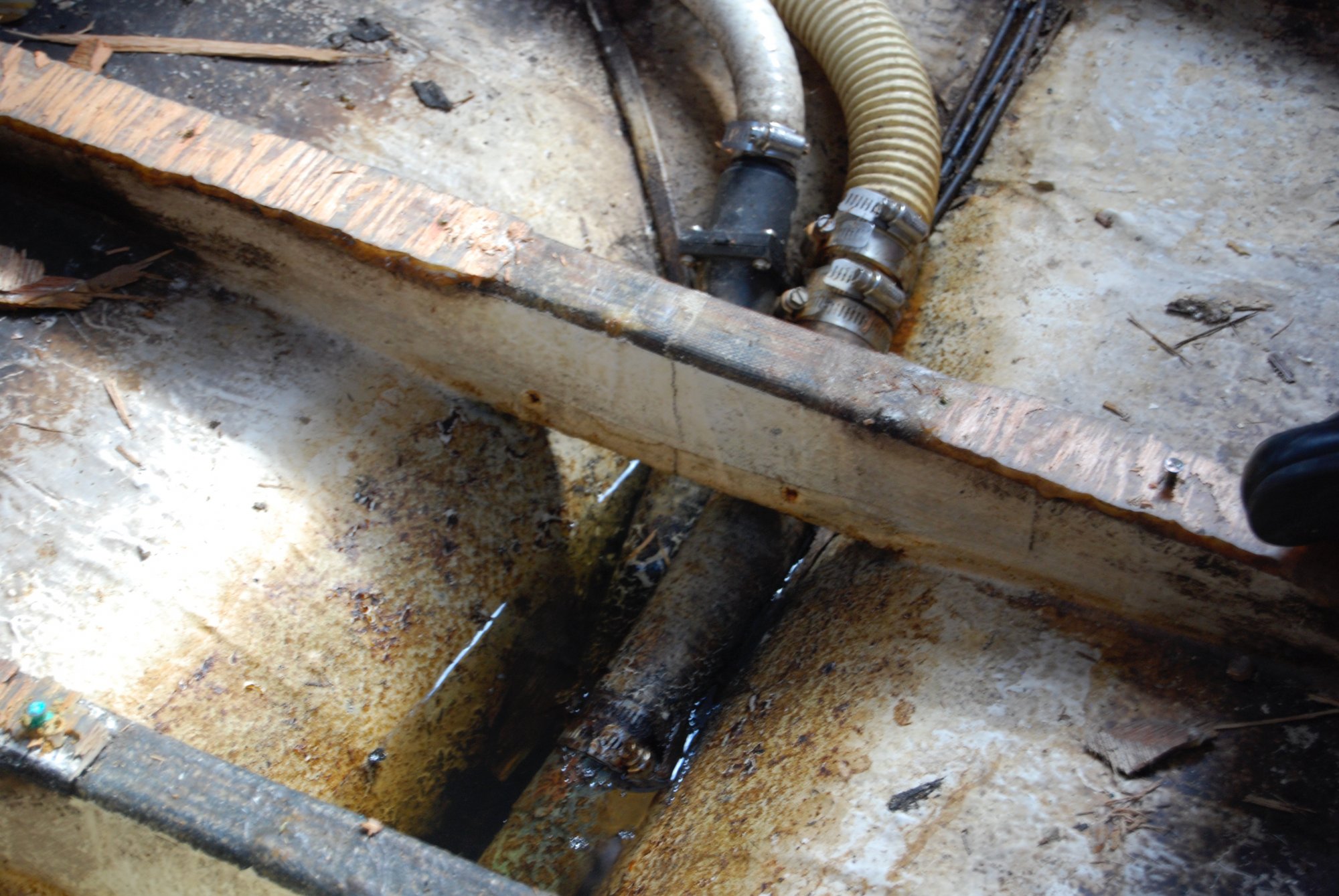

Here's part of the damage done to the structure inside the boat. Notice the crack in the floor timber.

@thetone it helps to have pictures of the damage. Are we to assume you have the boat out of the water and on the hard?
You state the damage to the rudder. Are any of the attached parts of the rudder also damaged? Items like the rudder shaft, the rudder shaft log, the steering quadrant. Depending on how hard you hit what ever was beneath the water it is advised to examine the surrounding or attached boat parts for damage or out of alignment.

As dlochner suggests, this could be REALLY serious. We don’t know how hard you hit, how fast you were going, or exactly what got bumped or at what angle. We’ve had taps that only involved using a hammer to bang the lead back into shape, and other hits that called for rebuilding the trailing edge the keel/hull joint and retabbing/relaminating floors with new layers of mat & roving. Having an experienced yard worker give it a look might be a good idea.

The boat hit bottom while under tow. The visable damage to the keel looks a little less severe than in the photo. The rudder hit bottom while underway. Both impacts were with rocks. I'll send some pics. The boat preformed fine after this. No water intrusion I can see. I'm wondering what I should use to fair the keel and fill in the chunk that came out of the rudder.
