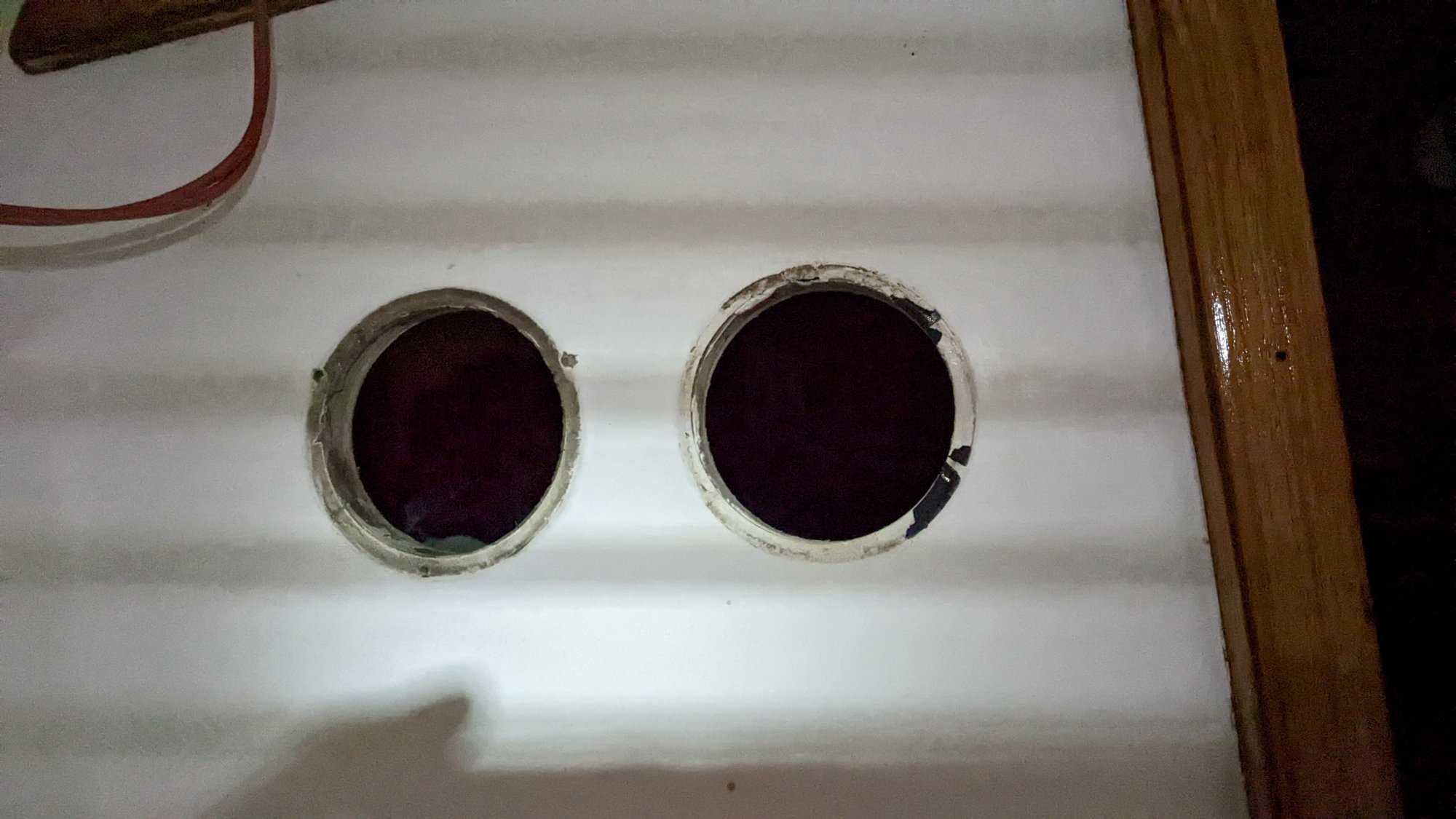

No, sorry, I wasn't clear. I just want to glass over them to match the rest of the cockpit wall. Thanks
14,174

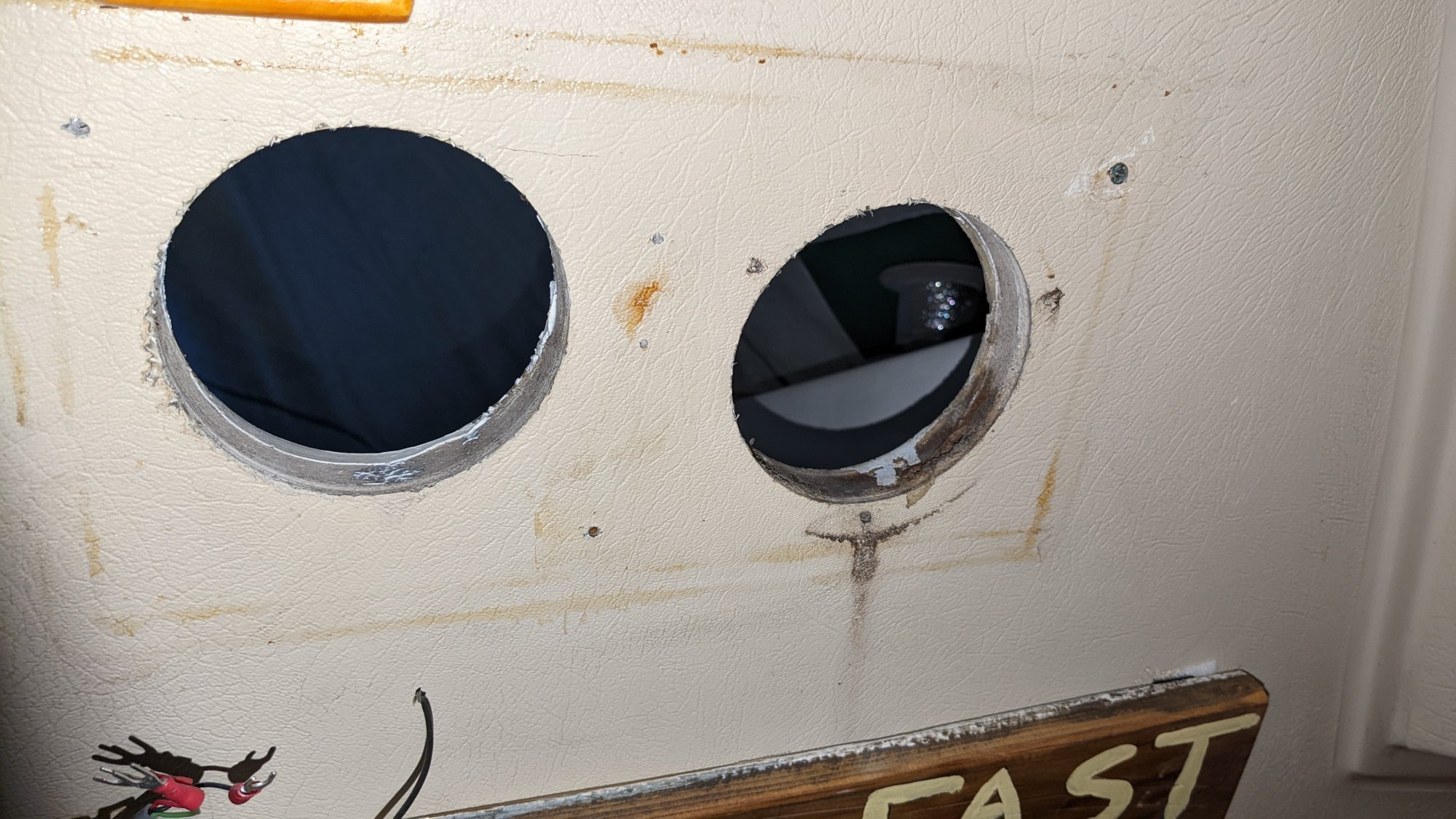

The inside of the bulkhead appears to be covered in vinyl, there will be no matching that.
To fill the holes on the outside it will be necessary to grind a bevel around the holes, lay up glass to cover the holes and then applying gelcoat. A lot of work. Many people faced with the same situation just put a piece of teak over the holes and mount new instruments or perhaps hangers for lines led back to the cockpit.

Hello, I removed an old SR Mariner depth sounder and knotmeter in my Catalina 27. What's the best way and products to use to fill these in? I have easy access to both sides and they are 1.25" thick. Thanks

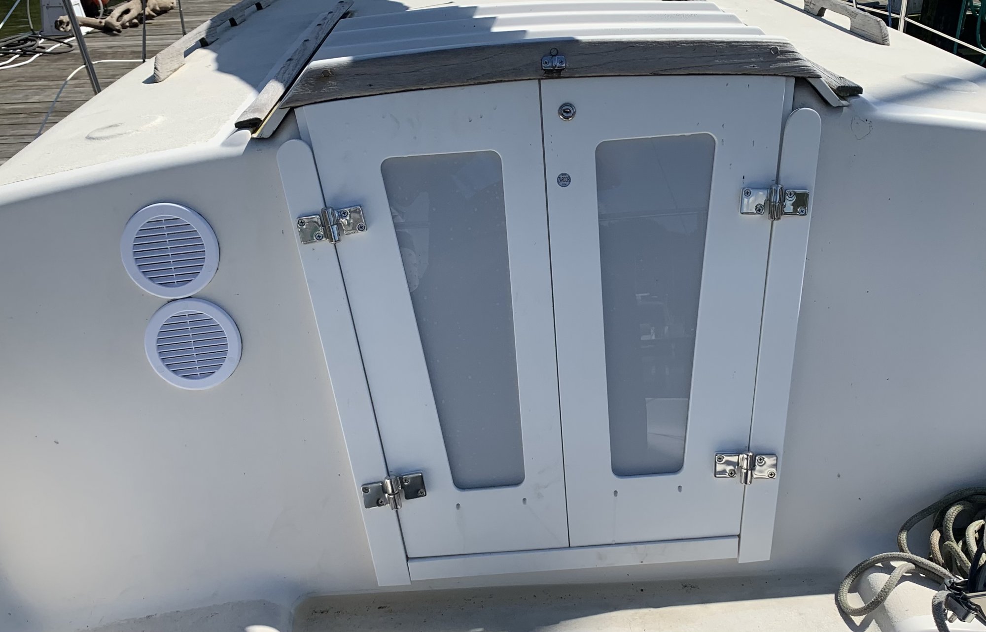

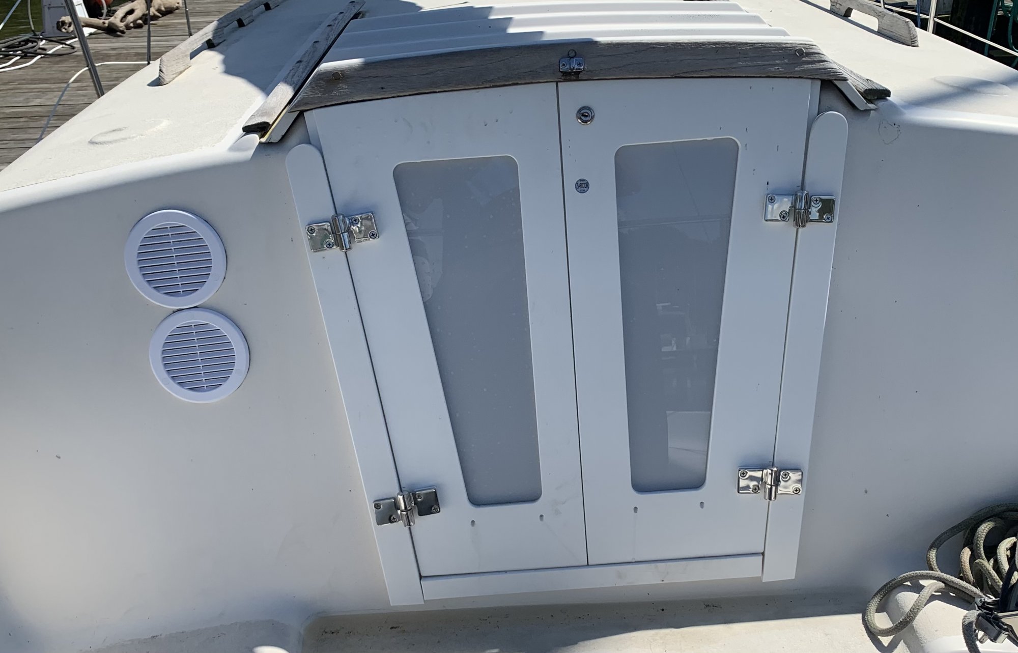

I think I had the same aged instruments on my boat and had the same issues with decisions for those holes. I opted for a simpler approach:
I put the same vent covers on the inside as well.

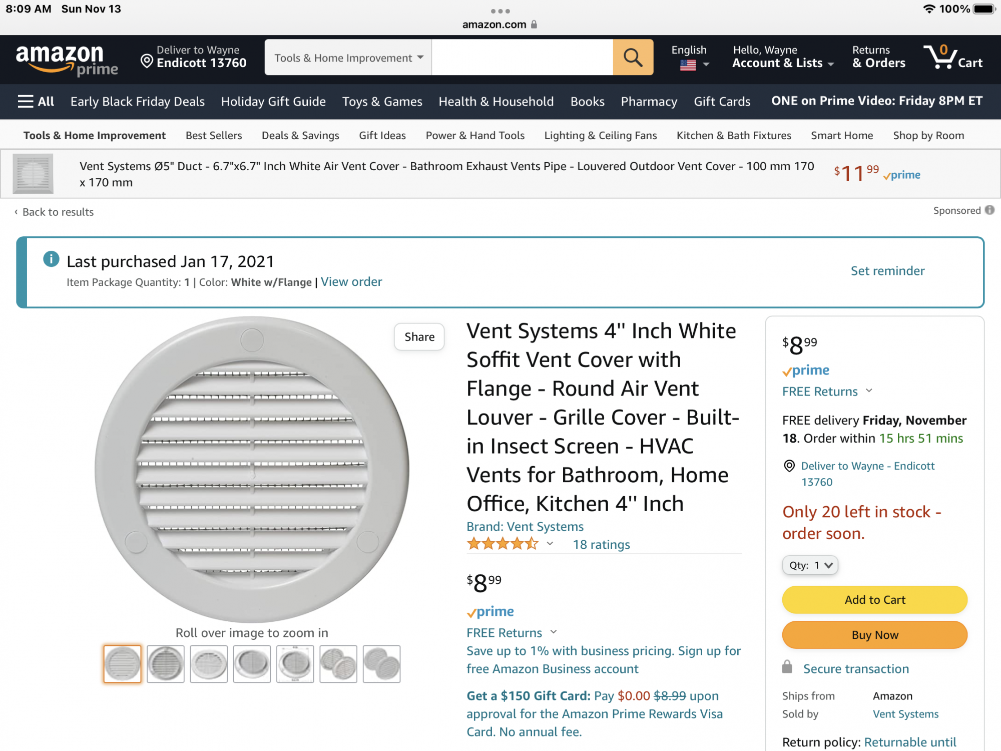

Do you remember where you bought those vents? Have you had any trouble with moisture getting in? Thanks
Nov 30, 2015
1,343
I found the vent covers on Amazon. They were installed easily and I used butyl tape as a sealant. We had quite a lot of rain early in last years season and there were no leaks observed. I think they also reduced condensation inside the boat by providing better air circulation.
