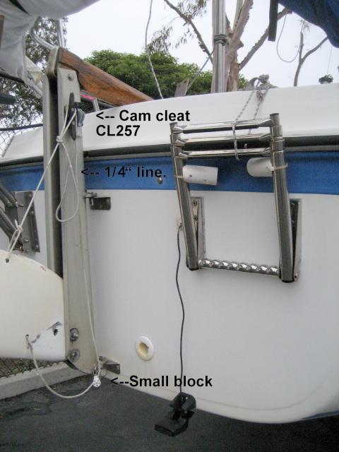

If you were worried about grounding your rudder there are a couple of things you can do. On the Mac25 I started out using a nylon bolt that could sheer in case of a grounding. I later switched to using a downhaul that was secures with a clam cleat that releases if the rudder hits anything. It is a Cl257. Here is how it is rigged.
