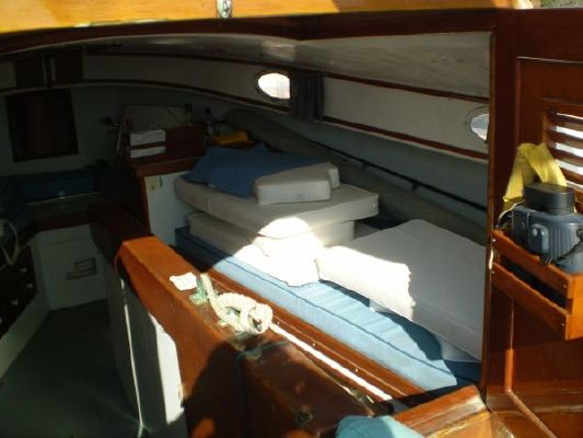

It’s not around any bolts (there are none through the toe rail, only the cabin top). Its a completely flat horizontal surface about 16” wide and 6 feet long, where the cabin top meets the hull, basically the underside of where you walk when going to the bow on deck. Its completely accessible, when lying in a bunk you are staring up at the area in question (does that help visualize it?).
The entire flat surface gets moist like a cold aluminum can on a summer day, it doesn’t get enough moisture to drip.l but it bugs me. Its probably concentrated there because someone is sleeping under it (breathing and being a moist human).
Maybe best to just keep a cabin fan blowing at the bunk all night? I was thinking a thin wood panel might transfer less cold from the outside- but maybe it would just condense on the surface of the wood?
Edit- not my boat but they are all the same basically inside- you see the curved cabin ceiling meets the vertical surface where the potholes are, under that is a horizontal surface that extends from under the “wall” with the portholes to the top edge of the hull (there’s no seam there all Marshall’s cabin tops are bonded to the hull). That’s the spot.
