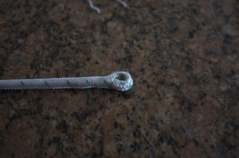

First try today
Very nice. Did you lock stitch the splice with whipping twine?

Well after about 30 feet of doublebraid and two weeks off and on, I have finally gotten three splices to work. One is just shy of perfect, thevpther two acceptable. I finally had to start using less than perfect before I ran out of rope! I found a Marlow eye splice splice video on YouTube that works best. I kept catching strands of the cover going by the crossover point. The Marlow guy says the cores should slide easy and they do if you don’t catch anything. After doing the crossing, pull and if the don’t slide, cut off the splice and start again. I used aluminum Sampson Fids. Go two sizes down when sliding the cores past each other. I used electrical tape and made smooth and thin wraps tonsecure the core to the smaller fid. At the end, after milking the core as far as you can, tie a small rope through the unfinished eye, attach that rope loopmpnto a cleat, and pull and snap the rope to yank theclast 1/2 inch of core inside the cover. I did my outhaul and bothbtraveler lines. Now i’m Moving on to the topping lift, spinnaker halyard next.

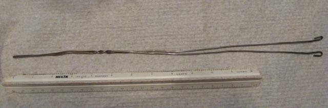

Use the magic splicing tool. Throw away those fids, they are a PITA. Get some small diameter wire, make it the length of the fid you are using and double it up by twisting it to make it stiff. Using needle nose pliers put two little hooks on the ends of the wire. Now use the hooks by hooking strands of the cover and then use painters tape or electrical tape to tightly wrap where the hooks are. You can now easily push the wire through the core and pull the cover through. Fids with pushers are a pain. There is a tool you can buy called a super snake splicing tool. Mine broke with a few uses and I realized it is the same thing as my wire method and that is basically free. Here's a picture of a coat hanger magic splicing tool used for larger diameter double braid. For smaller line just use smaller and shorter wire and twist it to make it rigid. Spending money on splicing tools does not help, this tool is free and works better. I have done dozens of splices with this tool and they come out great. Tool will last longer than me.
