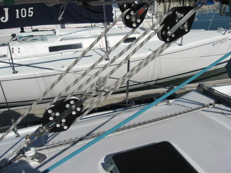

I utilized my rebuilt main sheet fiddle block as part of a new boom vang system. Its the one in the upper right in pic attached. Now painted black. Old tech blocks work fine for this application because boom vangs don't require a lot of run-out and they aren't being constantly adjusted when sailing. Still can't figure out how my 36' sailboat made it through several PO's over 27 years (boat age when I purchased) without a boom vang!
