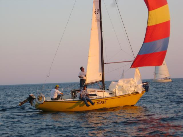

Here is a picture of the 1976 San Juan 24 I used to own and still race on. It is original hull gelcoat. The deck is in good shape, the hardware is due for a re-bedding. Always kept waxed and still has a lot of good races in her. Cinched first over all again last night.
