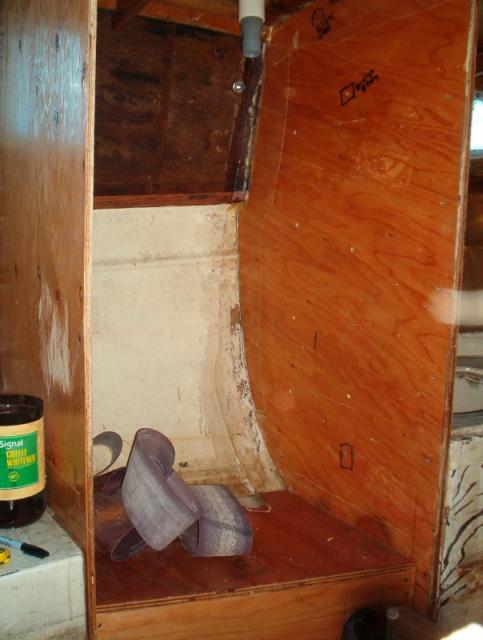

I'm preparing to secure the new salon bulkheads & stringers into place & was wondering what to use for a glass product. Would one use Episize Tape for this application?
Thanks in advance!
Bob
I used polyester resin and 6 inch wide 10 oz glass tape and used continuous length from bottom of the bulkhead right up to the cabin roof. Just remember to take a wire brush and scruff the hull surface where the new tape/resin will go and wash it with acetone.
The picture is the structural bulkhead and is covered by 1/4 birch for a finish.
The tape is a bit difficult to see I guess.
