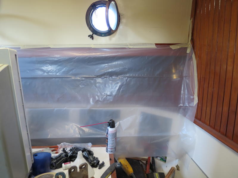

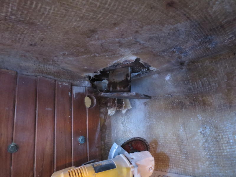

I used plastic drop cloths and made little rooms around the areas I was grinding. Full face respirator is mandatory. Really cut down on the dust in the rest of the boat. I was removing chainplates embedded in the deck.
Of course I didn't think about doing that until after I had already covered most of the interior of the boat with fiberglass dust. :)
I also used a hepa filter to get the dust out of the air after I was done grinding to make the air more breathable more quickly.
