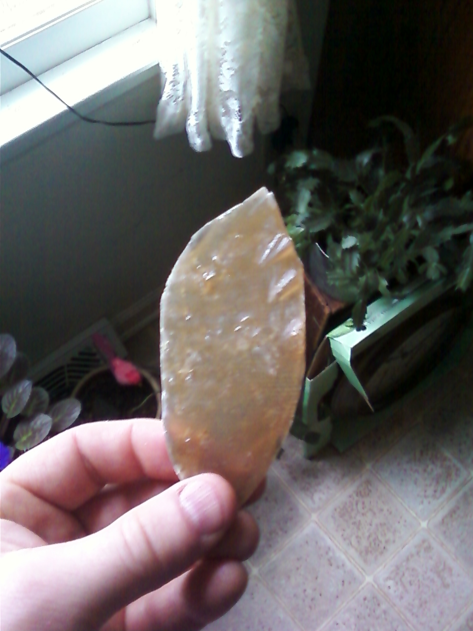

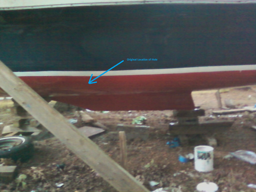

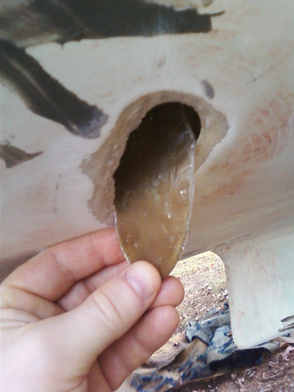

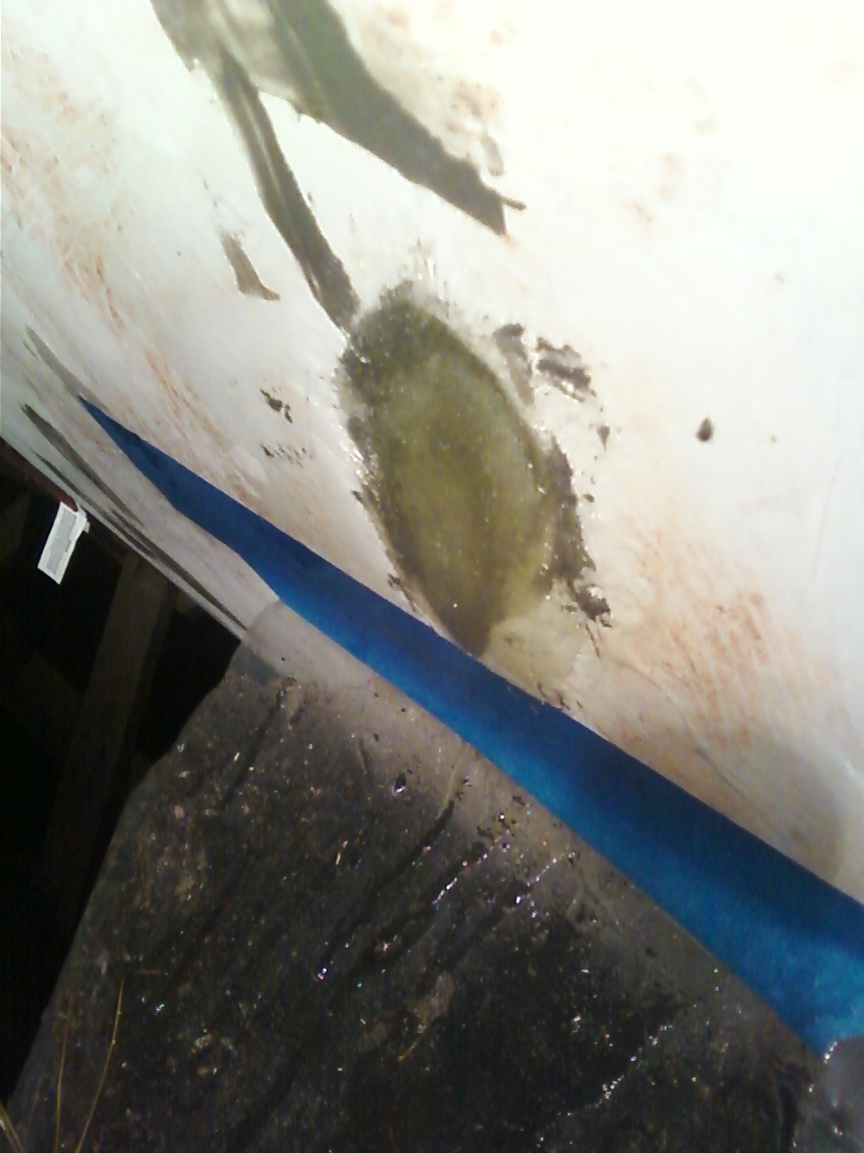

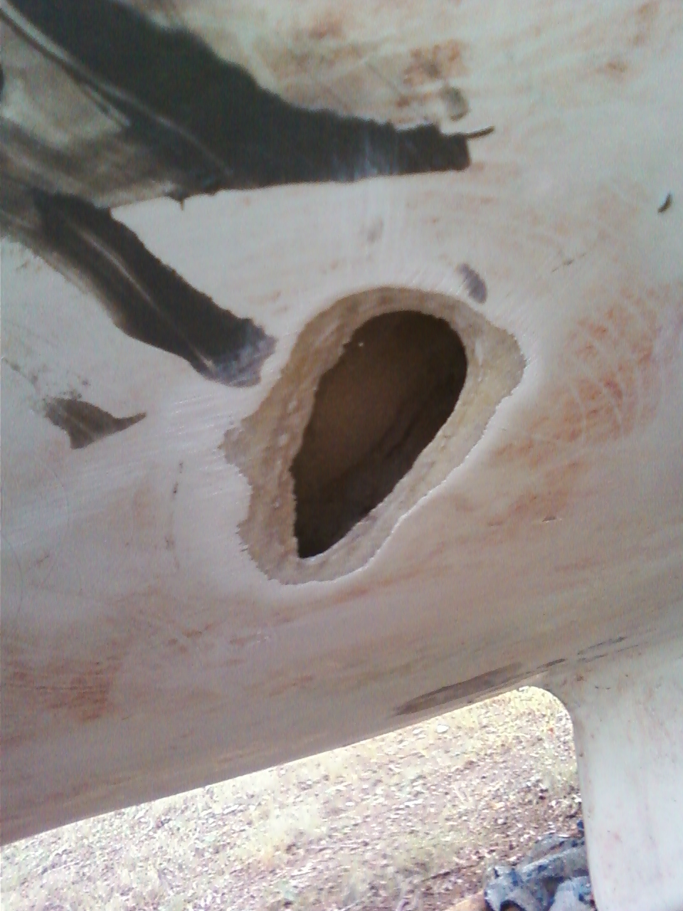

The only significant difference between what I suggested and what West System describes is that I wet all of the 6 or 7 pieces at once onto a piece of plastic sheeting... stacking them all up. This saves a bunch of time.... Your original piece can still serve as a template to trace onto the plastic sheeting. I don't know where your hole is and if you have access to the back to set up a backing plate. If you don't here are some pics of a hole I fixed where I had to jerry rig the backing plate
The first pic is the hole I fixed... I could not access the back without removing a laz.
So I traced the hole onto some vellum and then cut out a piece of fiberglass cloth slightly larger than the trace and wet it.. (next pic)

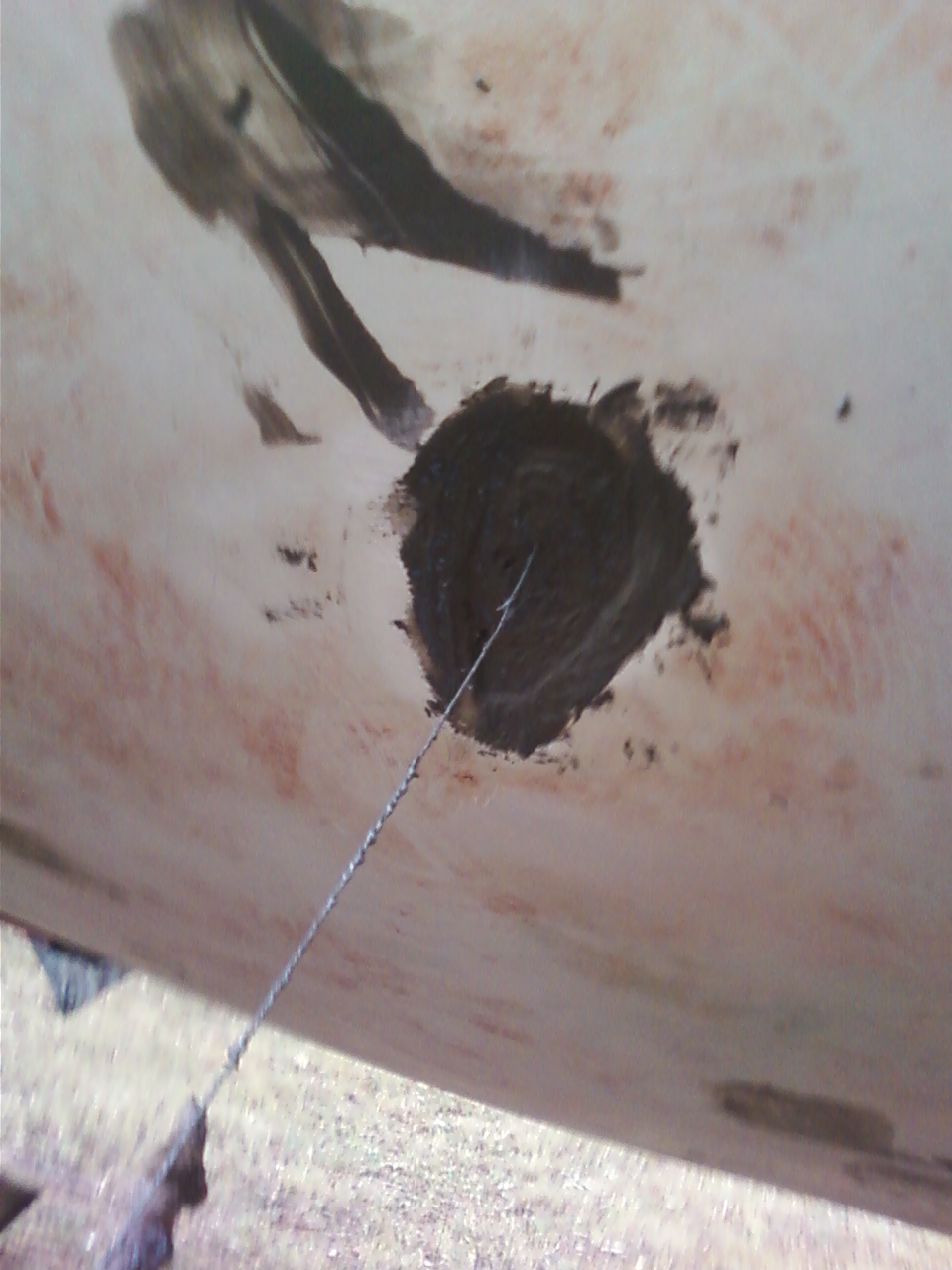

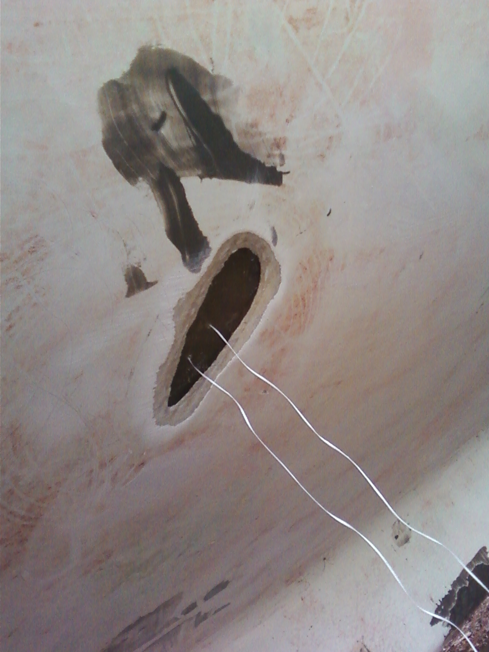

... then I drilled two holes into it and threaded some dental floss (btw: dacron) and glued it to the inside of the hole and held it in place with the floss until the glue set (next three pics)
(glued in place with JB Weld)

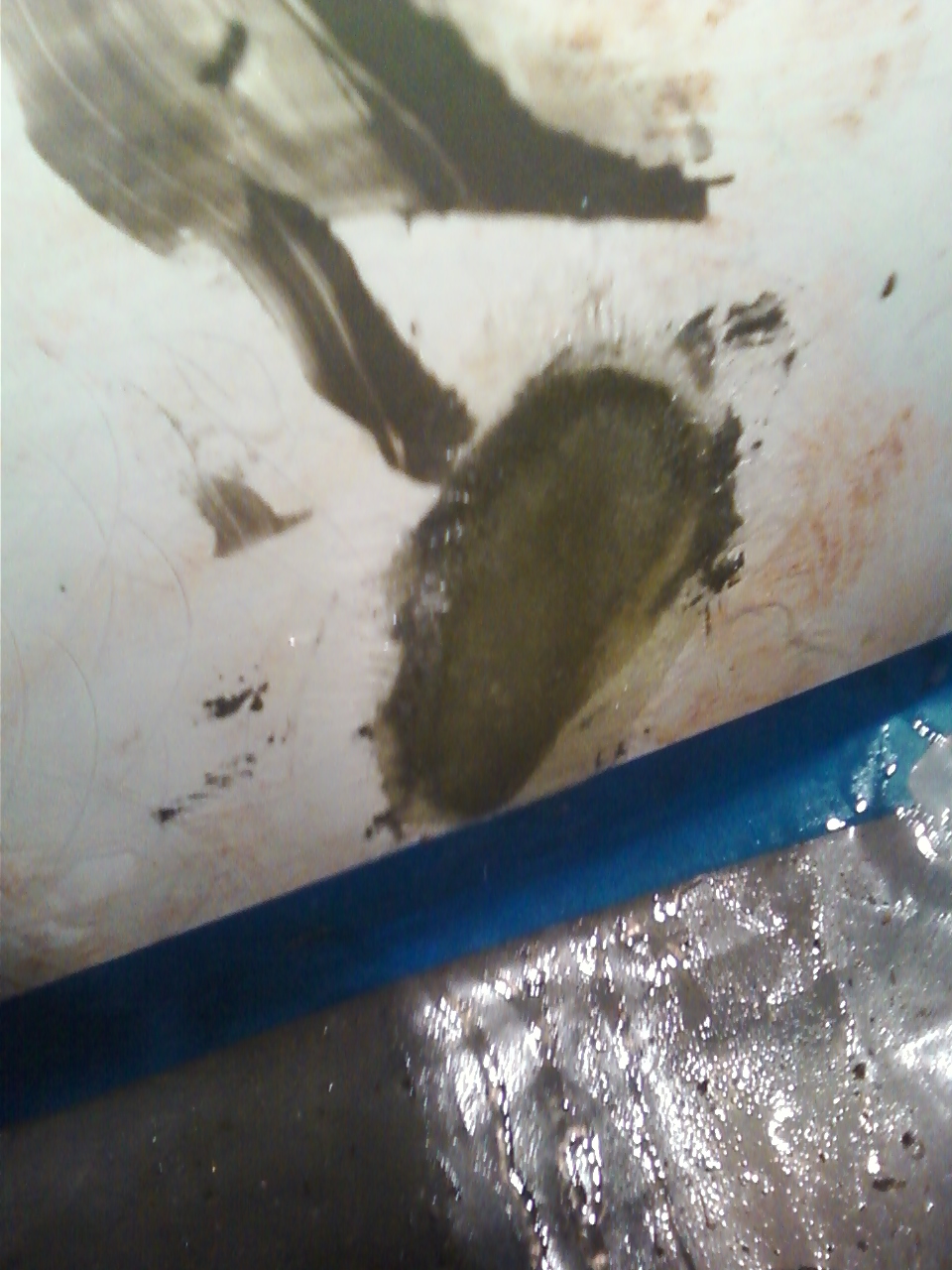

Next I cut out seven pieces of cloth... the largest was the size of the original trace and each one a little smaller. I wet them all and laid them out on a plastic sheet and taped it to the hull. Unfortunately, I did not pic the sheet all tapped up but I did get a shot as I removed the plastic sheet (next two pics).
It comes out very nearly fair with the plastic sheeting in place ... just a little fairing compound and some light sanding.... paint and....
13,088
In hind sight, it would have been a lot easier to make the backing plate out of some other scrap material, even plywood would have worked but I'm thinking a piece of plastic gutter or the cut out a piece from the lid of a PVC bucket (or even a yogurt container).
