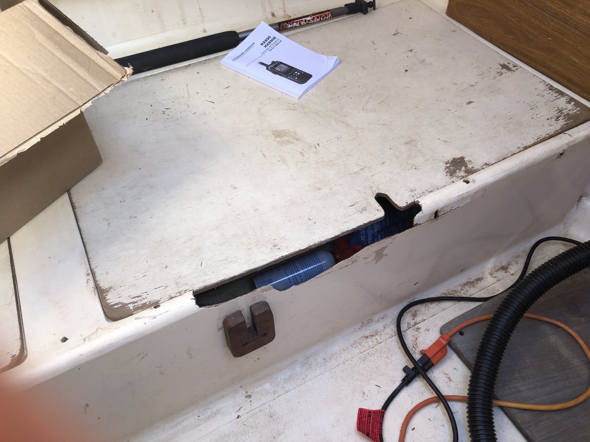

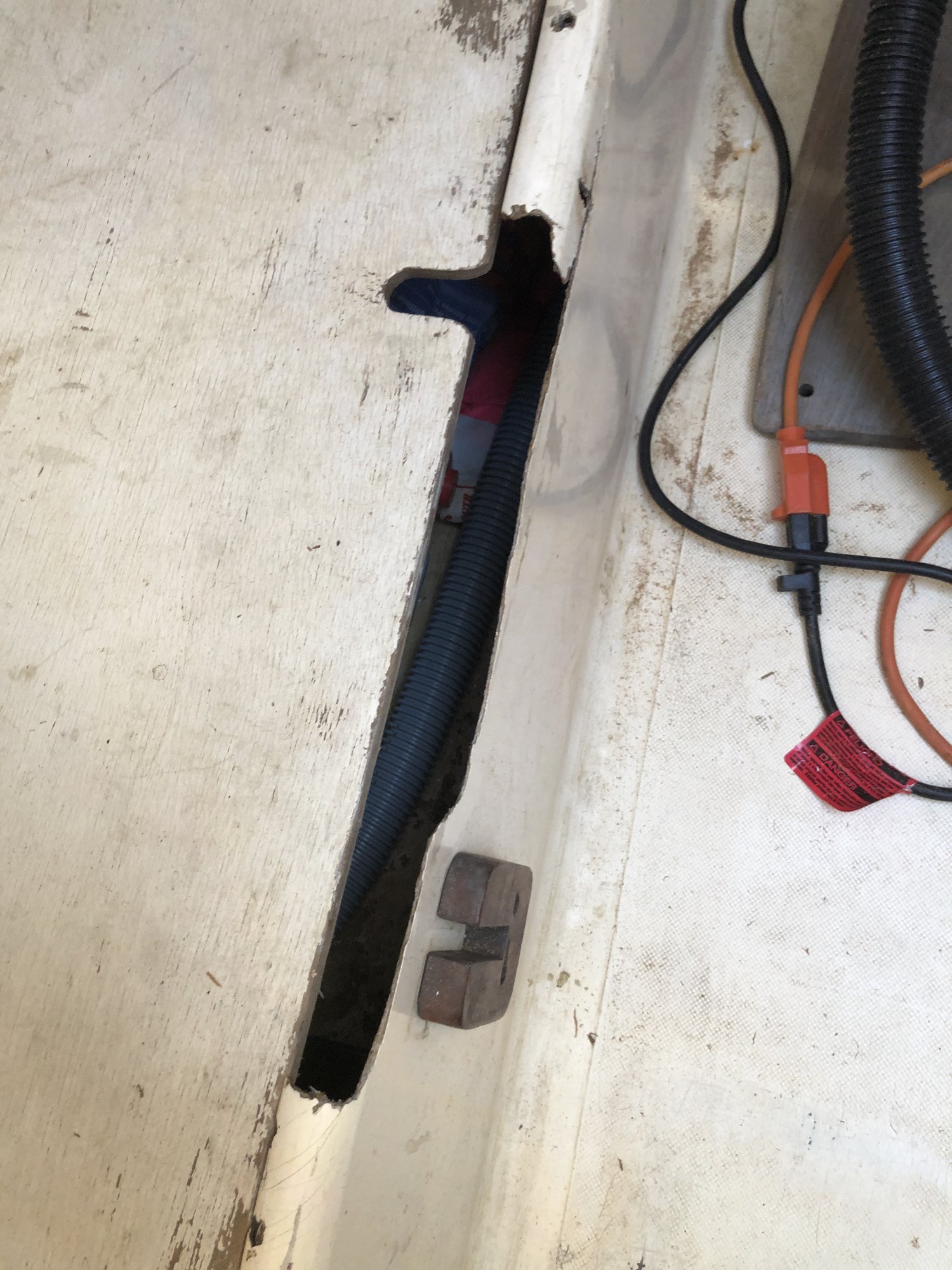

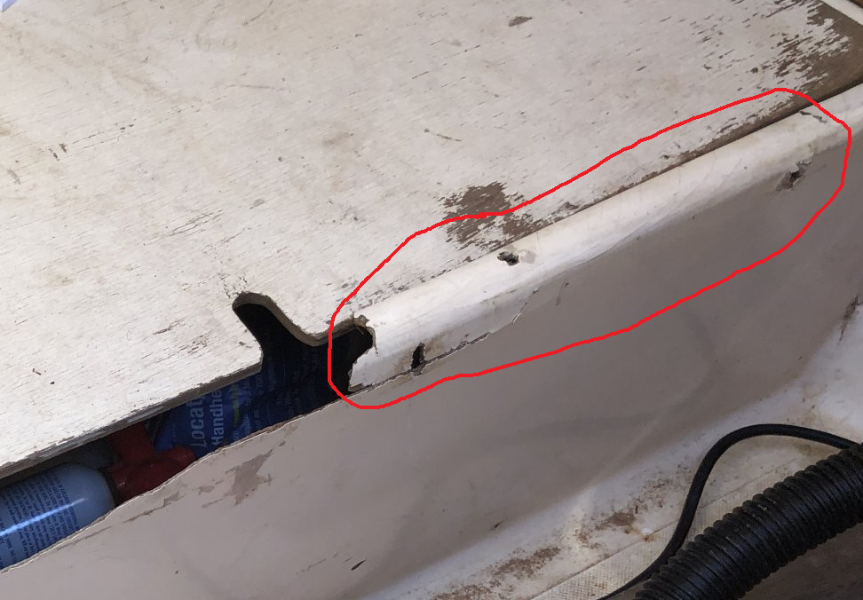

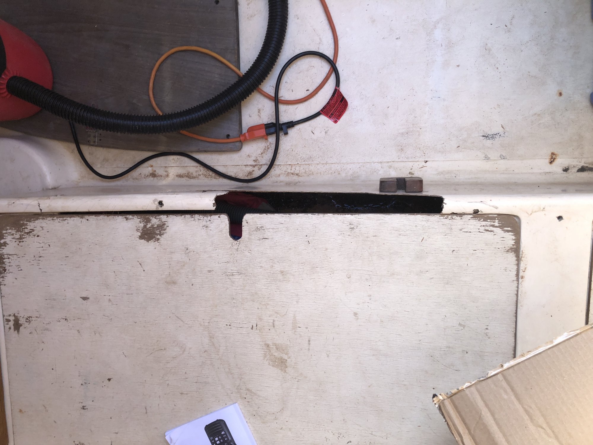

One of the lockers on the port side of my boat's cabin is cracked along its wall (see pictures). The biggest issue with this is that it won't support weight when using it climb in and out of the cabin. My plan is to screw a piece of 3/4" plywood to the back of it to stabilize it, but then can I just fiberglass over that to cover the cracks and then sand down until flush?
I haven't done any fiberglass work before, but it seems like this shouldn't be too terribly difficult. Would I also need to glass over the part of the plywood inside the locker? If so, would it make more sense to fiberglass cover the wood first, and then screw it in place and try to "fuse" the wood with the original wall so that it looks (sort of) nice?

The leading edge (the flange) of your locker that is not broken off (red circle) can be used to make a female mold.
Take a sheet of plastic and cover over that circled flange. Then wet out some fiberglass cloth and lay it over the plastic and existing flange. Once the resin sets, remove the cloth from the plastic sheeting and you now have a mold. Next put a sheet of plastic inside your new mold and lay up about four or five layers of epoxy wetted fiberglass cloth and let it set. Pull it out of your mold and you now have a perfectly formed piece that will fit your exiting flange. Take a hack saw and square off the edges of the broken flange, fit your new piece in (I'd add some JB weld along the edges and tape it in place until the JB welds sets. Then from the back side you can add a few layers of fiberglass cloth to overlap the edges to add strength. Sand smooth, paint and you will never know it was broken. If something goes a little wonky, cut it out... or grind it down and try again until it looks right. :thumbup:

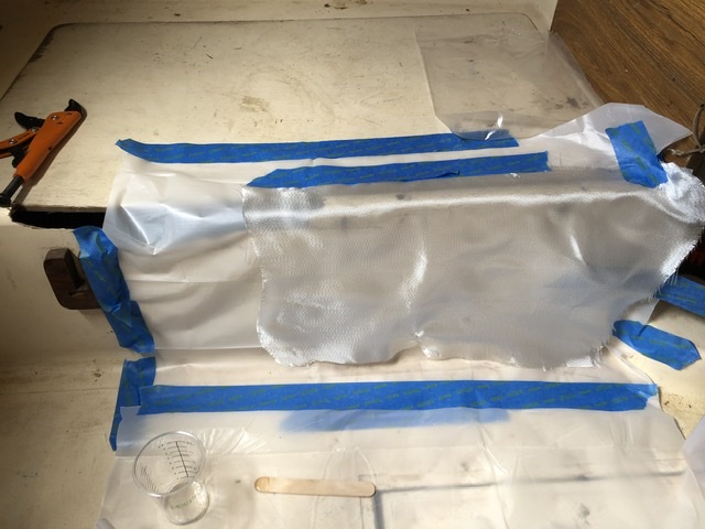

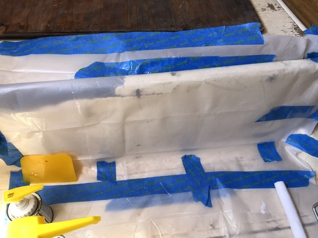

The mold turned out surprisingly well. I'm starting to think this might work!
I laid 4-5 sheets on plastic over the mold today. So, hopefully this will yield something that can start to fill the gap.
From the instructions above, my plan is to take what comes out of this mold and put it inside the locker and use some thickened epoxy to glue it up against the inner wall of the locker. Then I'll probably lay a few more sheets of fiberglass over the top and outer portion, then sand that back flush.
Depending on how robust the "lip" seems, I might try to tuck a few more pieces underneath that curve and hold them in place with the dowel trick mentioned above.
I took some pics today, but it's impossible to tell what they're showing.
