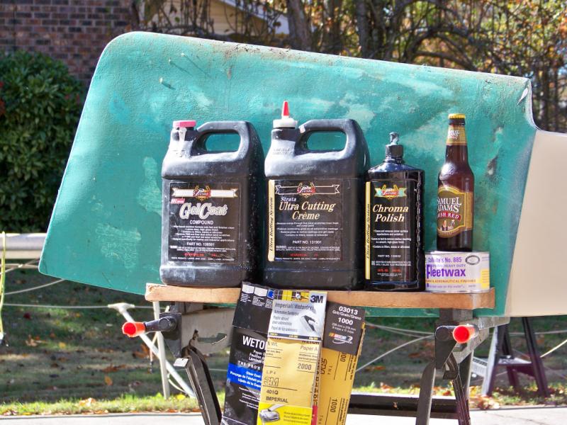

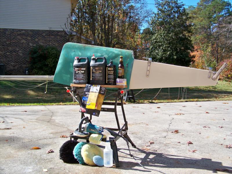

Stuff I used. Very indebted to Maine sail and this site. Thanks guys!
