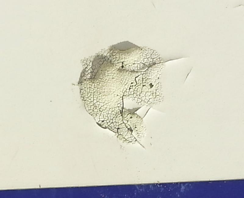

My h34 has developed Mumps or something... Fairly rapidly, this bubble (see attached Pictures) erupted from the Portside cabin top-side (sorry don't know the technical name of this location). How should I go about fixing this???? Thanks Jon

That is crazy Jon. From a distance it looks like a gel coat void that collapsed but close up looks almost like the gel coat was splashed with a drop of acetone or some other solvent. Only one spot ? Tom

Yes... Only 1 spot.. it is convex. almost like air bubbles. I never had any acetone or any other solvents that I can think of... maybe it happened early last year when the PO put the boat up for sale... I first noticed something small a few months ago, not it's like a Revenge of the Gel Coats.... coming to a theater closer to me.

Looks like some kind of foam goo was used to repair a gouge and the stuff is finishing its reaction.. Ya probably going to have to grind that out and re-repair correctly. New gel coat on top of the repair..

Do I need to lay it up with Fiberglass first? Can I fill it with chopped glass and resins? Also what do they mean when they say, when the fiberglass kicks???? Thanks... Jon...

Jon, it looks small and non-structural.. I'd guess that a good thickened epoxy or polyester would be fine .. "Kicking" is the term for the chemical reaction between the resin and hardener .. IF the goo is not mixed thoroughly, stuff like that can happen.. Rich may want to comment further about the reaction..

Had this happen to my boat, just lots of small blisters that developed over time in small sections of the topsides. The culprit was probably someone at the yard when the boat was being built got air bubbles in the auto catalyst/resin mixing 'gun' when applying. When I excavated the 'blisters' I found a lot of still uncured resin in the 'cosmetic' (non-structural) matting layer under the gelcoat layer.
For the repair, Id suggest that you fully grind out all the area until youre sure that youre into 'solid' glass. Then, epoxy-layup small layers of cloth (12 oz. cloth goes in and builds thickness quite fast) leaving about 1/8" space which will be then filled with epoxy filled with "CaboSill" or WEST System "colloidal silica" filler --- to 'mayonaise or peanut butter consistency', then flat sand with a 'long board' to a perfect surface to match the surrounding surface. Then you can eyeball 'match' the gelcoat - apply with a Preval Spray gun, etc.

I can't tell how deep it might be but you may be able to cut out the old and just fill the spot with gel coat repair. I recently purchased gel coat (with the catalyst and surface agent) that matches my boat from Spectrum Color and have repaired many spots on my boat. This stuff comes in a quart and only has a shelf life of 6 months. I keep mine in the frig and hopefully can extend the life some.

..................... and don't make a lot of work for yourself. From your picture, the area doesn't look to be much bigger than about an inch across which is just a cosmetic repair above water line.
Beg. borrow, or steal a small Dremel grinder and gently grind away the defective area until you are into solid FG. If the cleaned area is still quite small and not too deep, tape off the adjacent area with masking tape and fill the area with thickened, waxed, polyester resin. Use FG putty if you're really lazy. Don't worry about making a mess as it can always be sanded out. When satisfied, gently sand it out and cover with colour matched gel coat. Finally sand the gel coat with progressively finer paper and then polish.
This first defect will be a learning experience but as long as you protect the surrounding area, you can't really do too much damage as long as you take it slow and easy. You will also find a plethora of material on small gel coat repairs here and elsewhere on the web.

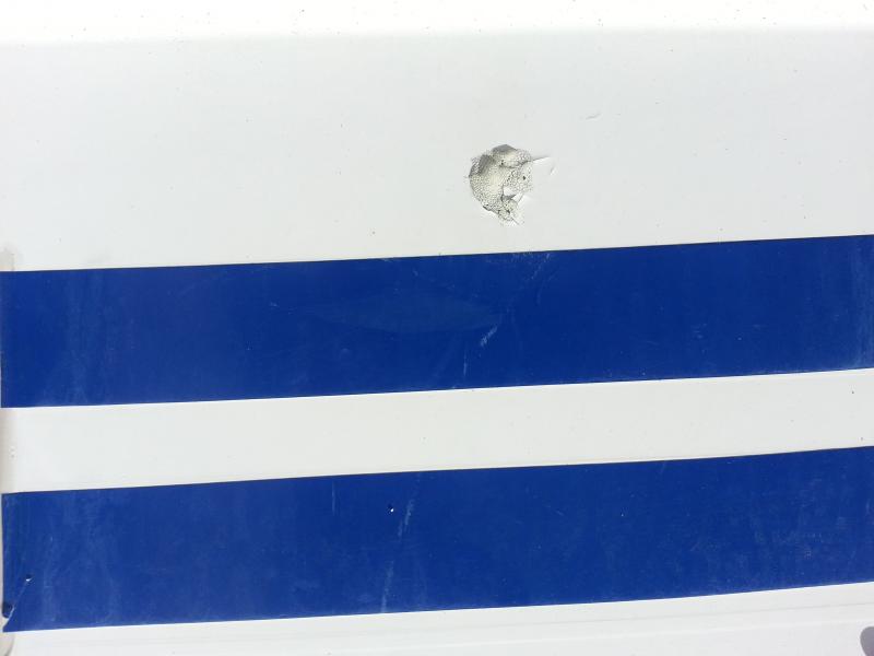

With any kind of fairing out the hole, this is going to run into those hunter blue stripes. Any idea how those stripes were created?
Jon, there seems to be a variation on how the top hull stripes were created. On mine they were decals so I simply removed them and re-applied new ones. some boats had the stripes painted in the gelcoat. Rejuvenating is doable, but might make it harder to repair. I suppose you could always applied decal stripes on top of the painted ones after you've done the fairing. Of course that would mean doing both sides.

Hi Claude... Maybe if I tack really slow, no one would notice the difference in the trim.... Hmmmmmm. Thanks, I'll take a closer look!. Jon
