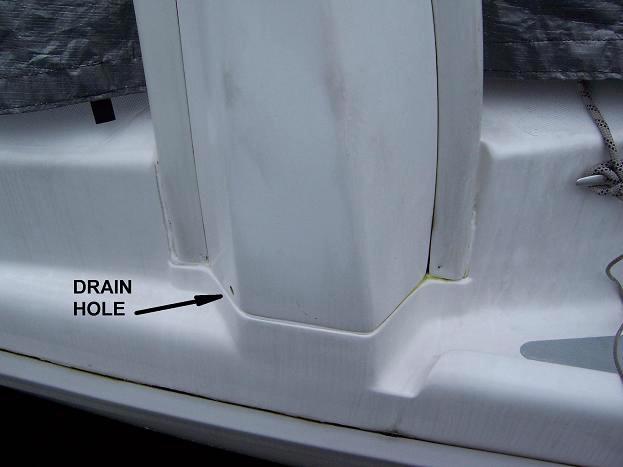

If so it is bolted on with vertical bolts going through the cockpit coaming
Adding to what Tim22 has said, I had occasion to be poking around at the interior base of the arch and the vertical bolts are an ideal place for water to leak through if they are not sealed properly. Pulling and re-caulking them may be a challenge as mine were installed with 5200. Yours may be on with something more forgiving. You can also ensure the drain hole at the outside base of the arch is clear to avoid water build up.
Again, as with Tim22, this is found on the '99 H-310 which may (or may not) be similar to yours.
