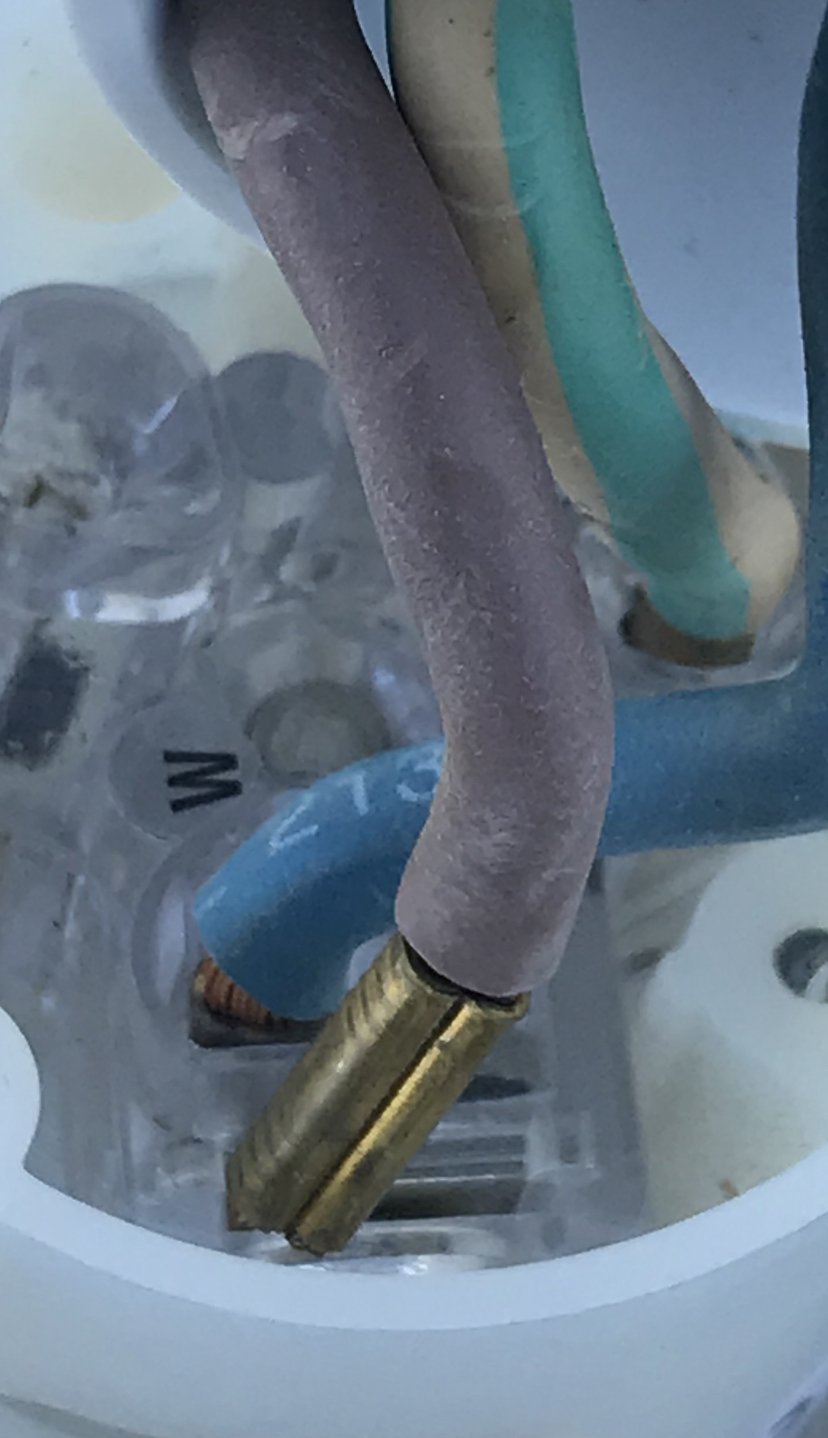

I’m replacing a Hubble shore power connector with a SmartPlug. Beneteau crimped a ferrule on the end of each wire where they go into the back of the socket. I presume they are there to help keep the strands of wire together when inserting in the back of the socket. Should I leave the ferrules there, or remove and re-strip. My only concern is whether the contact surface between the ferrule and the SmartPlug is good enough, or would the wire strands provide better contact?

Here’s the best pic I have. See the end of the purple wire -
The wire and ferrule all seems to be in good shape and clean. There’s just enough wire to redo it, but but the wire wouldn’t be long enough to run along the hull as neatly as it does now.
23,792
If the wire is good, and the insulation is not cracked or worn I'd be inclined to see about removing the ferrule. It looks more like brass than copper. But that is just me. Preserve the wire length.

The SmartPlug has a pressure plate under the screw, so you should be good with bare strands. Bare strands provide more contact area than ferrules, which lowers resistance and heat. The caveat is that the terminal needs to incorporate a pressure plate.
Personally, I like ferrules because they make for a neater installation and are easier to re-install if needed, but I limit them to small gauge wire.

Great choice on the Smart Plug. :dancing: Not only do the ferrules hold the strands together, but in most plugs I've seen the screws that make the connection crush and separate the strands of the wire, so the ferrules give the screw something to push into that does not give. When I first switched over to a Smart Plug, the screw connections in the new plug were such that it would not crush and separate the strands when tightened. This makes the ferrules rather redundant. I'd remove the ferrules. (Not sure they would fit into the new plug holes anyway) From the picture you should be able to loosen them a bit and slid them off. At worst, just cut them off and restrip the wire, but it doesn't have to be back any farther than the end of the ferrules so you would not lose more than an inch or so. (Assuming the wire is in good condition and you can pull it out of the old plug.) Or, if you are like most sailors and money is no object, get a factory made Smart Plug cable.

Thanks all for the input. I’ll probably do the socket install later this week. I’ll look at how the ferrules will fit and line up with the pressure plate in the SmartPlug, and make a decision then, but I’m leaning toward removing them. I retrofitted the shore cord end the other day and that went easily enough.
