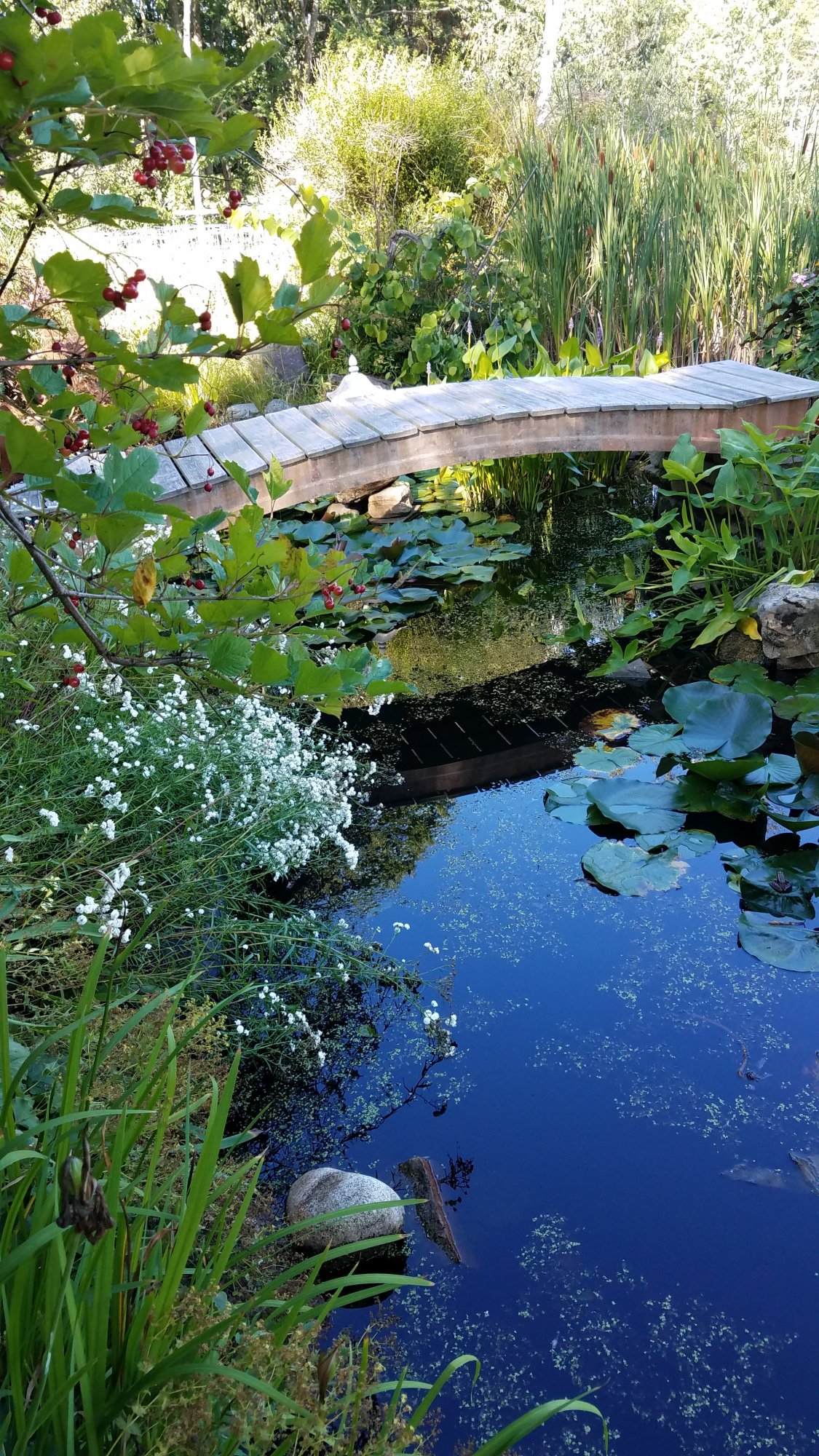

A concrete bridge I built, about ten years ago, over our pond. Concrete is cheap and easy to work with, but it is not strong in tension and is pretty inflexible. There are bonding additives that improve on that, somewhat. With poly and glass fiber reinforcing mixed into the concrete, it can be much stronger in tension. My concern would be about the weathering and the stress of use a sailboat is subject to. Ocean waves, wind and rocking on the rigging anchor points, Winter ice, ... all work to undermine the cement bond on the aggregate material. Tiny stress cracks in the gel-coat of fiberglass doen't mean the underlying glass is weak, but with a concrete boat, any surface cracking could mean there is no more tensile strength left clear down to the armature. It requires an enormous amount of rigidity and strength of materials to keep a 40 foot hull from flexing in a stormy sea. I don't think concrete is up to the task for more than a few storms.
