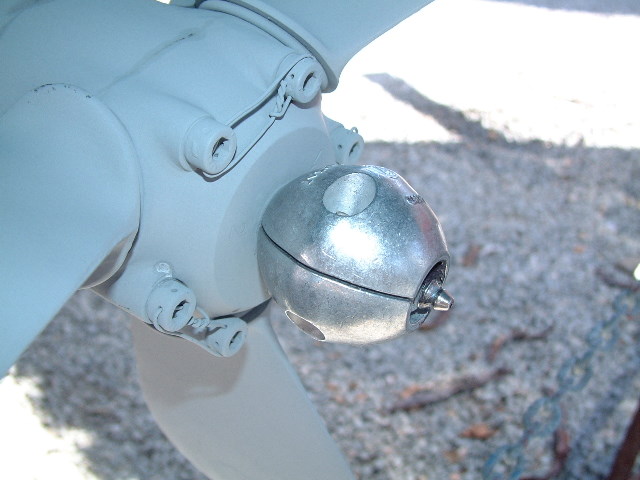

I went with the AutoStream. The deciding factors for me was that it had external pitch adjustment (at the time MaxProp did not), it was all stainless steel so that there was no dissimilar metal issue with the shaft, It can be greased in the water (I was not hauling every year at the time), and since it was a feathering prop rather than a folder the reverse performance would be excellent.
Remember when a feathering prop goes into reverse, the leading edge of the prop is still the leading edge in reverse. The stopping power is impressive. The first time I entered a slip i shifted to reverse at the normal stopping distance. I ended up stopping only half-way into the slip and had to go into forward again.
The only downside of the AutoStream (other than price) is that the custom zinc is about $40- very expensive IMHO. However, I solved that issue by machining an adapter that allows me to attach a standard shaft zinc that cost me only $7. See the pix of the original zinc and my el-cheapo solution.
