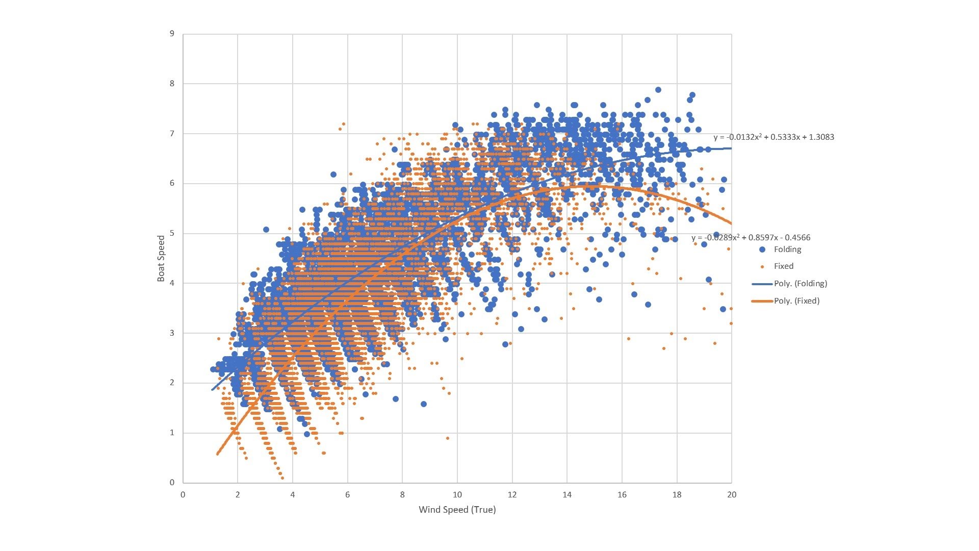

I have gotten a couple quotes, so far. Looks like it will be around $2200. Another question since I am planning on getting the prop mainly for inproving sailing performance, they advertise about 1/2-1 knot improvements in sailing speeds, would you say that is what you have seen?
That’s pretty consistent with what I’ve seen going from a 3 bladed fixed OEM prop to a Flex-o-fold.
Blue dots are from close-hauled sailing over a season with the FOF. Orange are from the fixed. At low wind speeds the difference in averages is about a knot, converging as the wind builds. At higher speeds the fixed prop was causing lots of turbulence over the rudder, stalling it out. The FOF doesn’t do that, so the speed difference opens up again at the upper ranges.
Likes: henrykorous
