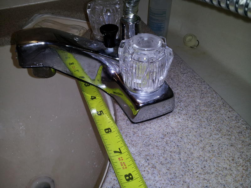

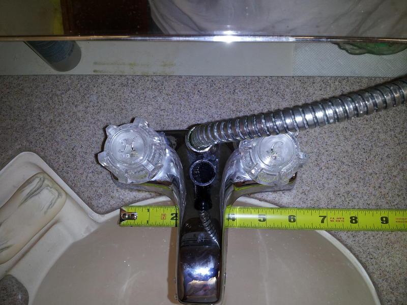

Phil, I installed the one you sold for the head sink about two years ago. Do you know those dimensions? It fit fine, but to remove the old one, I had to pull up the countertop.
Jul 29, 2004
413
Hunter 340 Lake Lanier, GA
Phil, here's a couple of pictures of the H340 head sink/countertop. As I mentioned above, this faucet is not OEM, but the replacement model you sold me a year or two ago. There appears to be plenty of room for the slightly larger fixture.

Thanks Ed, that is _exactly_ what wee needed to know!
