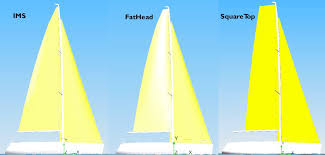

You have to remember that zero performance oriented masthead boats have been designed in the last 20 years, so the 'fathead' phenomenon has all occurred on fractional boats.
Backstay is the obvious first issue. You have your choice of no backstay (need 25 degree spreader sweep as a min) or running backs.
The extra area up high is best felt on a fractional boat, where it is out of the backwash of the jib. Notice I said jib. not really a genoa boat play; it really was designed for non-overlapping rigged boats. Want more area on a genoa boat? Get a bigger headsail.

If you main can be tacked with a single backstay in place, then by definition it is not a fathead. Like the performance version of the Swan58 shown. A roachy main for sure. That swan IS fractional BTW. 9/10s or 15/16. Non-overlapping.
I disagree.
You're right the Swan is frac but one still could, and I would, fathead a masthead rig.

By that definition fair enough. I always considered a fat head and a square top the same thing, but if you’re used to describe a roschy main sail then OK.
