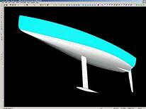

A really general question.. But.. Hydro/aerodynamics will lead ya to long and skinny.. For the hull, low wetted area and a good profile while heeled 10-15 deg..For the keel, long and skinny (high aspect ratio) is best for efficiency.. that is defined by lift generated over drag created.. .. sails are the same mostly as keels.. high efficiency looks like long skinny.. think wing sails on AC Catamarans.. Sails have a practical max height of around 50-60 feet for bridge clearance.. sometimes less.. so lots of times they aren't very high aspect ratio.. and they get force by piling on more sail area.. soooo your turquoise boat in the computer rendering will be "fast" compared to anything else in the pictures if fitted with a high aspect ratio sail set with lots of area.

Hey Everyone,
Good afternoon! I wanted to ask everyone today what they think is the fastest hull design and rig; keep in mind that the boat would have to be fast both upwind, on a reach, and on a run as well. What do you think?
View attachment 148032 View attachment 148033

The new sailboat on the left, with the deepest fin keel, is the least slow.
