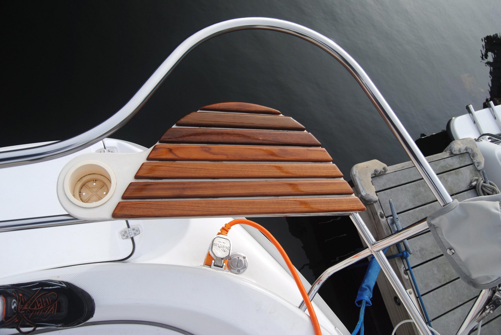

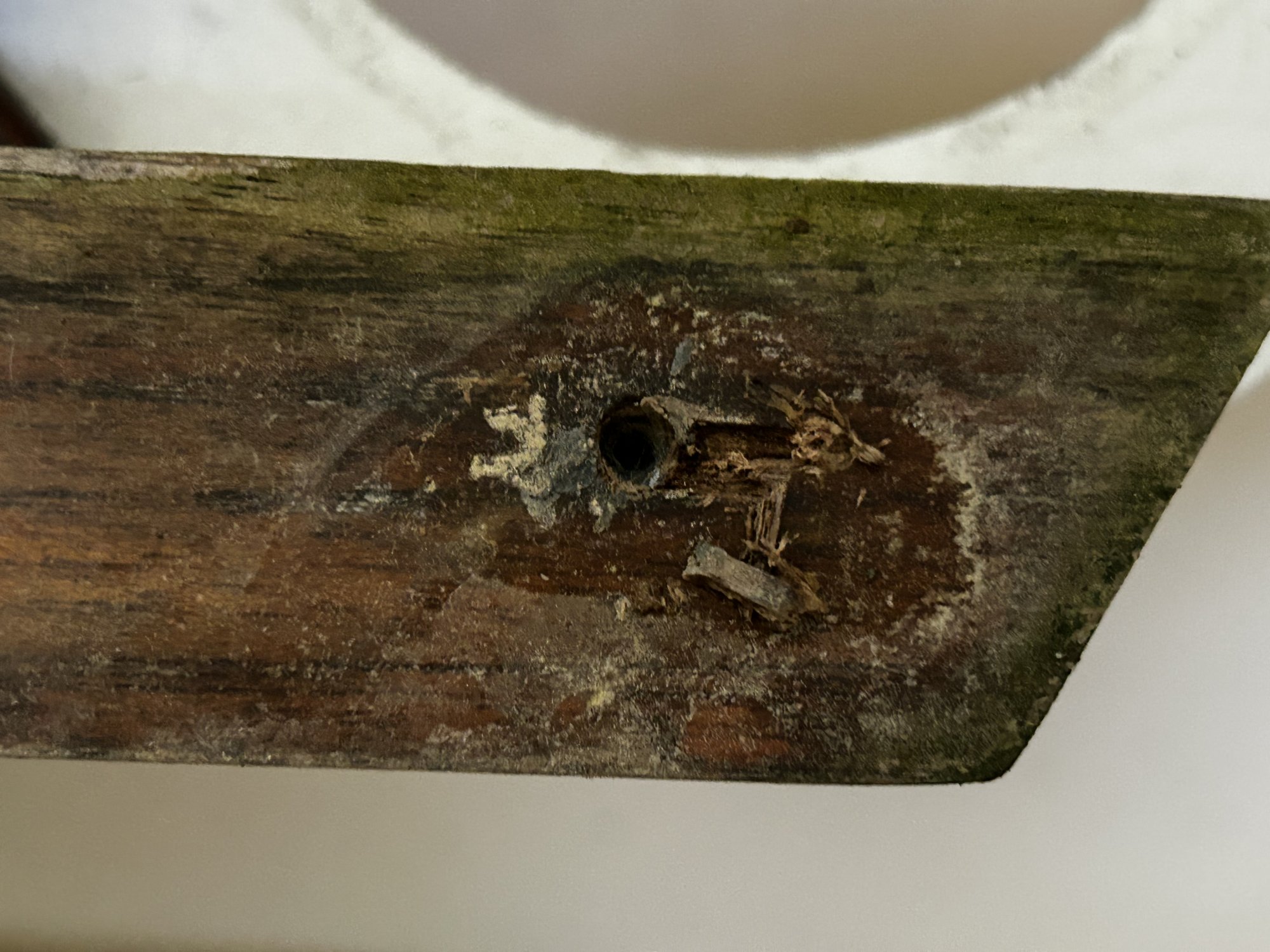

On my Hunter 340 I have 2 Wing Seats that have 1 1/2 inch wide x 3/8 inch thick Teak Wood Slats. They are screw down through the White Starboard and up into the slats to hold them in place.
A few of the screw holes in the teak slats have widen over the years and do not hold the screws in tight.
The teak itself is in great condition but some of the screw holes need to be filled and retapped for the wood screws to hold them tight.

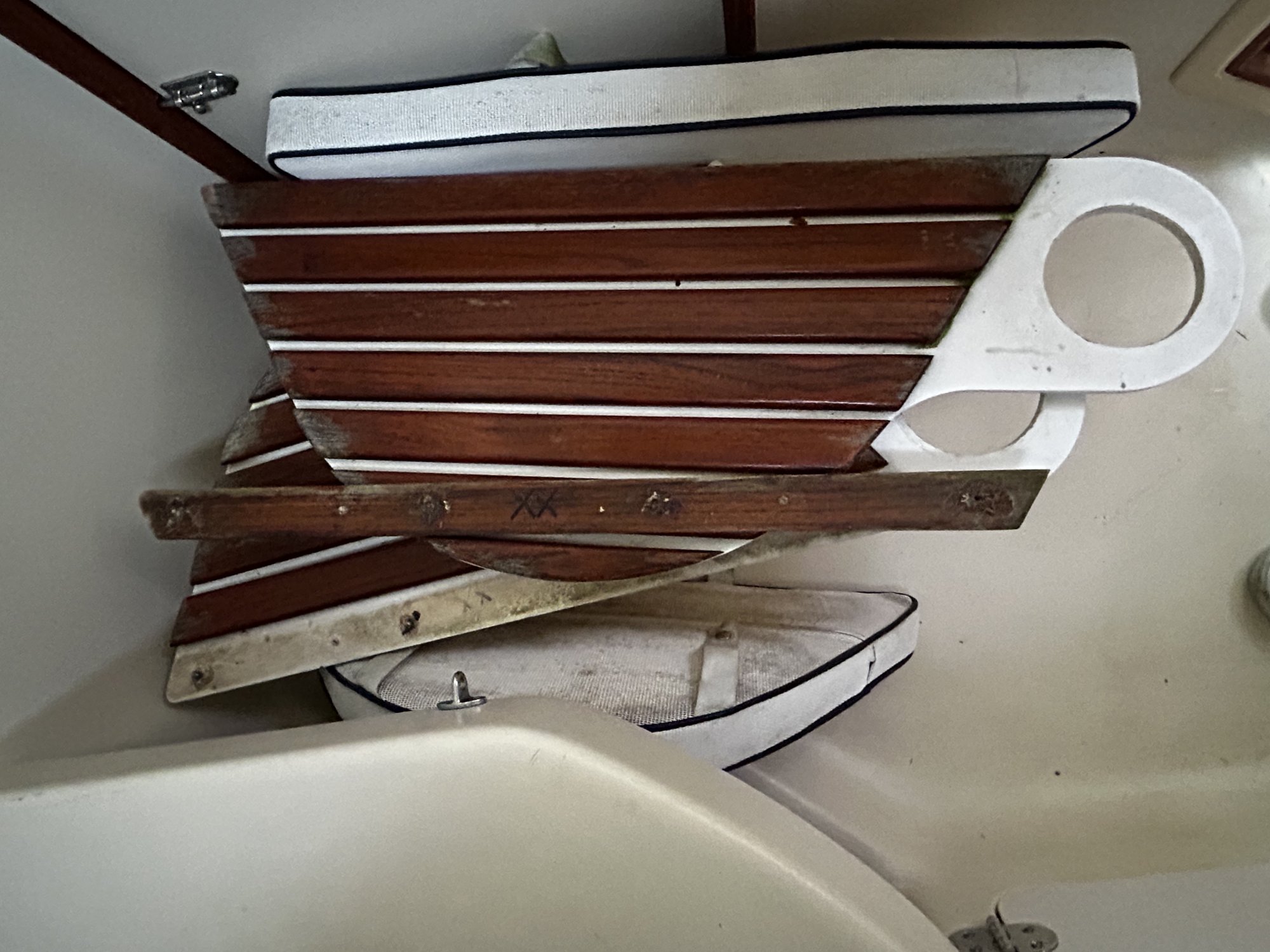

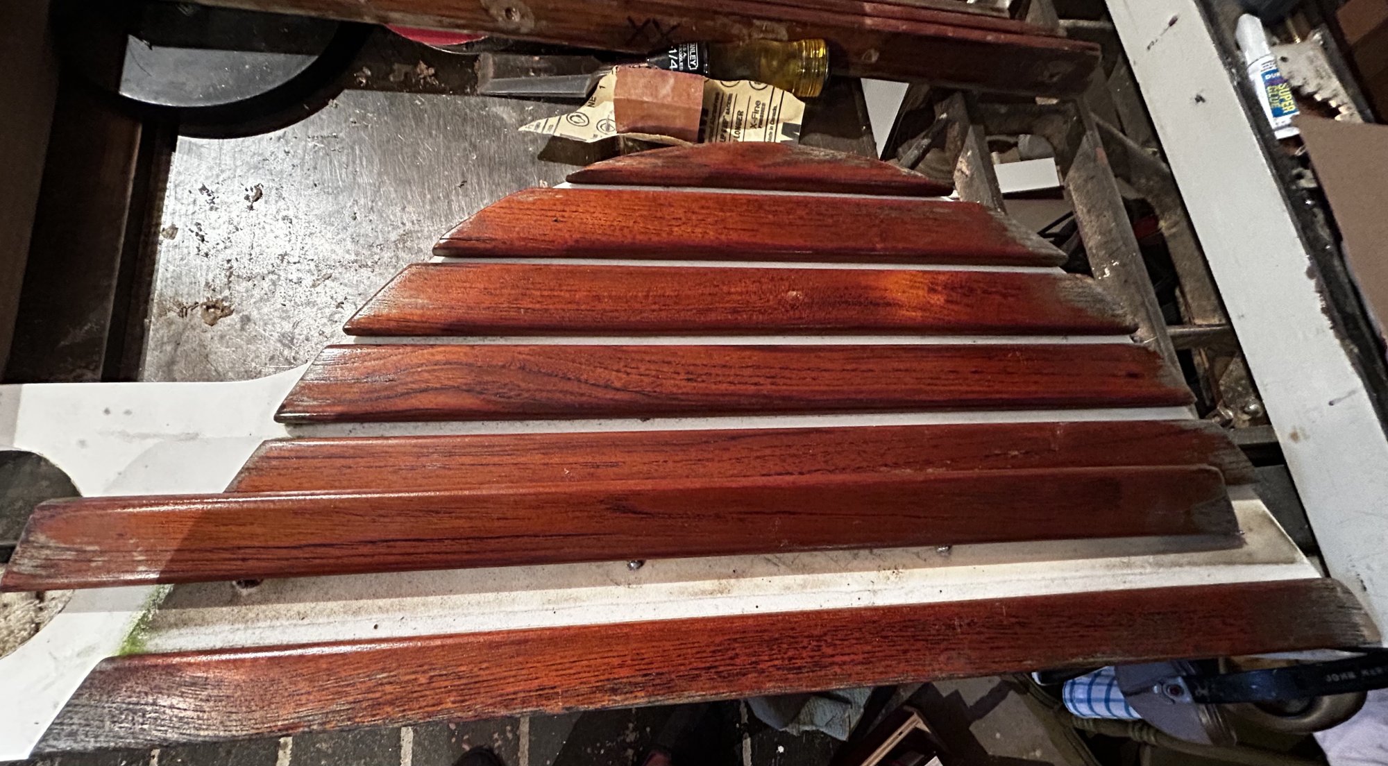

I took home the weather worn slats to refinish each one and fill in the screw holes the just don’t hold anymore. This is what they look like on my boat. They are covered with a cushion as well but they really need some care this year.
I will try the Total Boat Flex and enlarge the holes as well.
With the new material to grab, rather than plain wood, the screws should hold well.

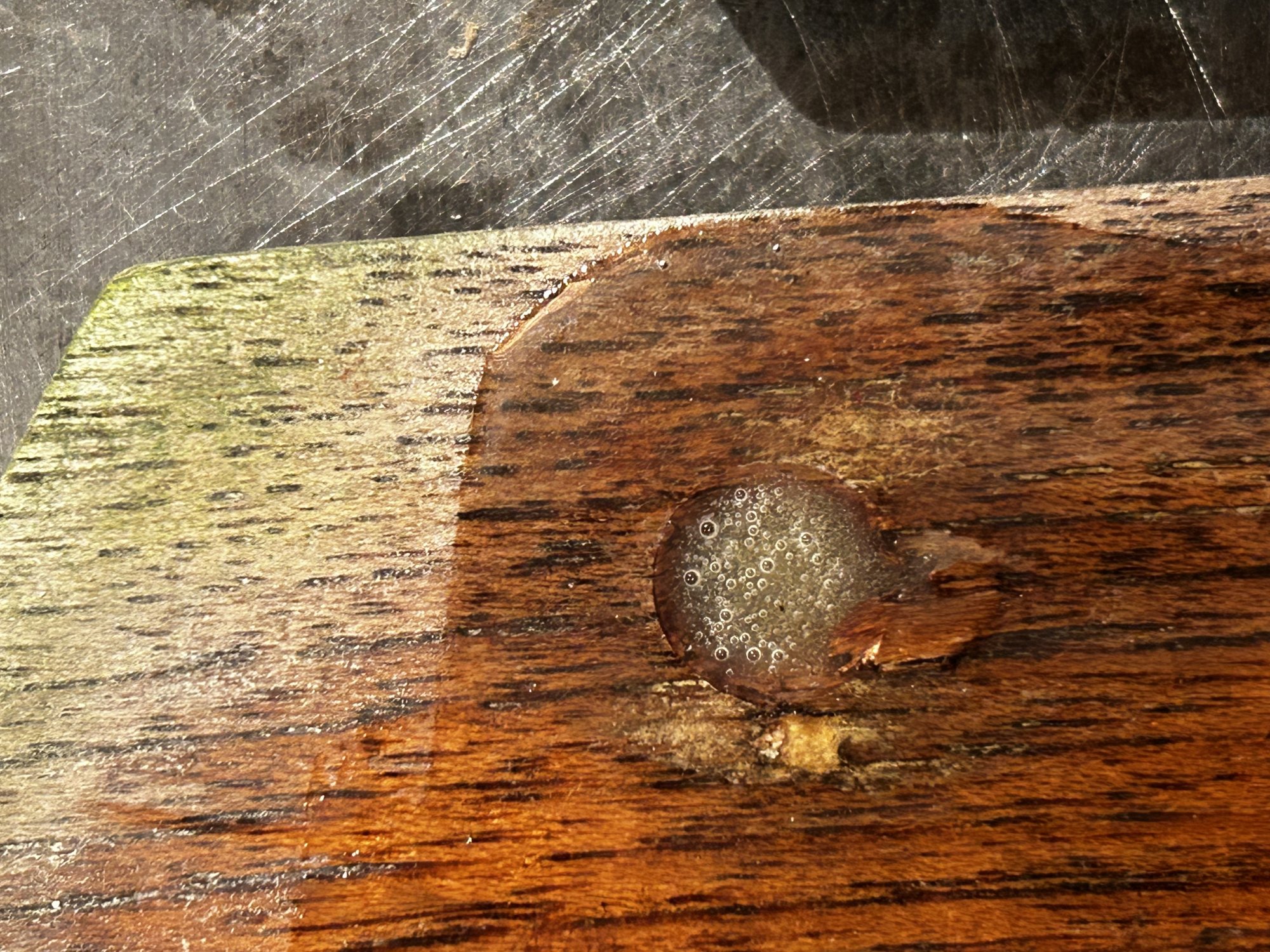

I drilled out and widened the screw holes in my slats. All of them. Fine sanded each one to accept a new finish.
And filled them with Total Boat 2 Part Flex Epoxy.
There’s not a lot of wood to play with in a 3/8 inch thick piece but this should bond well with the widened and scored holes for the epoxy to harden onto.
They have plenty of time to set up before I even try to drill into them and reseat the screws. I’ll take the time to clean the base of both seats as well.
I like the finish Ralph achieved using “System Three Epoxy and two coats of outdoor varnish”, so I will give that a try for myself after all have dried and hardened up. Thank you.

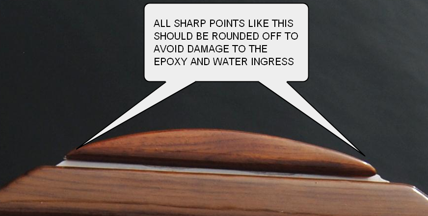

It also helps to ensure extra epoxy is piled on to anywhere the teak comes to a point on the slats. Actually, it's better to round off any points to be sure that a slight knock on the points won't break the epoxy and allow water to enter.

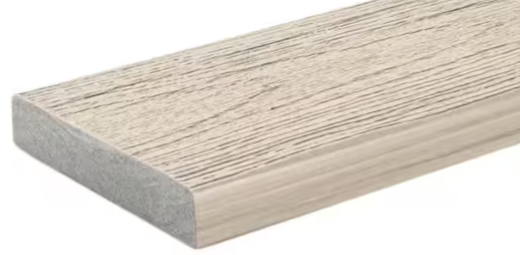

Personally, I like Trex.:)
Rip it into strips and screw it down.... save the strips with the rounded edges for the side facing into the cockpit... done for good. Never strip/sand/stain again. Who is looking at your end grain anyway?:cool:
