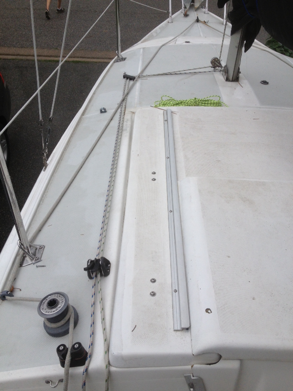

A word of caution about installing blocks on the deck. They need to be through bolted and sealed with butyl tape to prevent leaks. Anything with that much tension on it should also have a backing plate of wood or metal on the opposite side to prevent the bolts from pulling through the deck. Just drilling screws into the deck will certainly pull out and will be a constant souce of leaks.

The bolls with loads pulling on the screws (I forget the term) are hooked to the tabernacle. The deck organizer should only have shear load. But I agree any hole you drill is a potential leaker if not done properly.

My 26S has a double block on the cabin top leading to a 2 line deck organiser and back to a double clutch leading to the winch. The block and deck organiser can be bolted throught the cabin top with access inside the drop down area over the sink.
