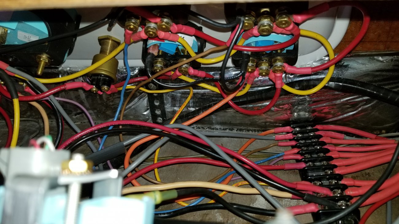

The wiring is all new - trailer plugs replaced with terminal strips, instruments all wired with #10 wire, crimped connections with sealed heat shrink. I have 13.1v on the back of the gauge, so I'm confident the gauge reading 12.2 is not due to the wiring.

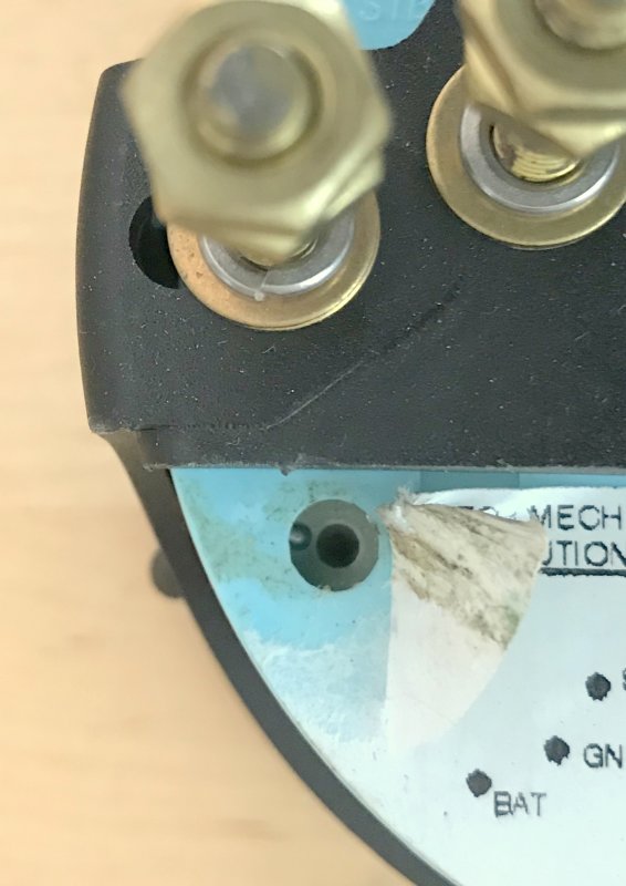

I'll wrap this thread up by saying Faria sent me a "special" adjusting tool that they used to ship with the tachs. It is like a plastic jewelers screw driver with a very tiny hex tip. I went back to the boat and spent 15 minutes poking around blindly inside the hole where the fine adjustment is supposed to be with no success. In frustration, I finally removed the entire instrument from the panel in order to see if I could engage the adjusting tool, then reinstall the instrument with the tool in place and make my adjustment. Once I had the instrument out it was apparent there is nothing inside the hole where the adjustment pot should be. Looking into the hole where the adjusting tool goes I see three tiny solder-rimmed holes around a larger hole, but there is nothing, and has never been anything soldered into the holes. I assume they are where an adjusting pot might go. To recap, then, I purchased five brand new Faria Euro instruments. Of the five, the water temp and oil pressure seem to function correctly. The fuel gauge requires a sharp flick of a finger to register every single time the boat is started, the first voltmeter read approximately 1 volt low from the voltage at the back of the gauge (the warranty replacement is only marginally better), and the tachometer is wildly inaccurate at each one of the gross settings on the back of the unit, and has no fine trim adjustment. The first time I spoke with Faria tech support regarding the tach and voltmeter, the technician told me these are budget instruments and I shouldn't really expect much more accuracy from the voltmeter. Originally I had planned to use VDO instruments but decided on the Faria because they use ring terminals under a nut for connection where the VDO use a female push connector. This winter I will replace all of the Faria instruments with something else, probably VDO. I don't doubt many others like @Maine Sail and @woodster have had success with Faria instruments, but this experience has left me pretty disgusted.

What model # is tachometer? Are you sure it was a "diesel" tach for alternator AC tap pulse? We've been using Faria and VDO gauges for years and never had an issue with Faria. You also don't need a special tool, it is nothing more than a 5/64" Allen wrench.
This is the adjusting pot hole on a TD9102 0-4000 RPM diesel tach with hour meter. You can barely make out the faint Allen head adjuster pot.
These adjuster pots are EXTREMELY sensitive and prone to damage if over turned.
Mine is a TD-9102 - no hourmeter. There is no adjusting pot and from what I can see it was never there. After I haul the boat for winter I will cut the tach open to see if there was ever a pot there - I suspect not.
