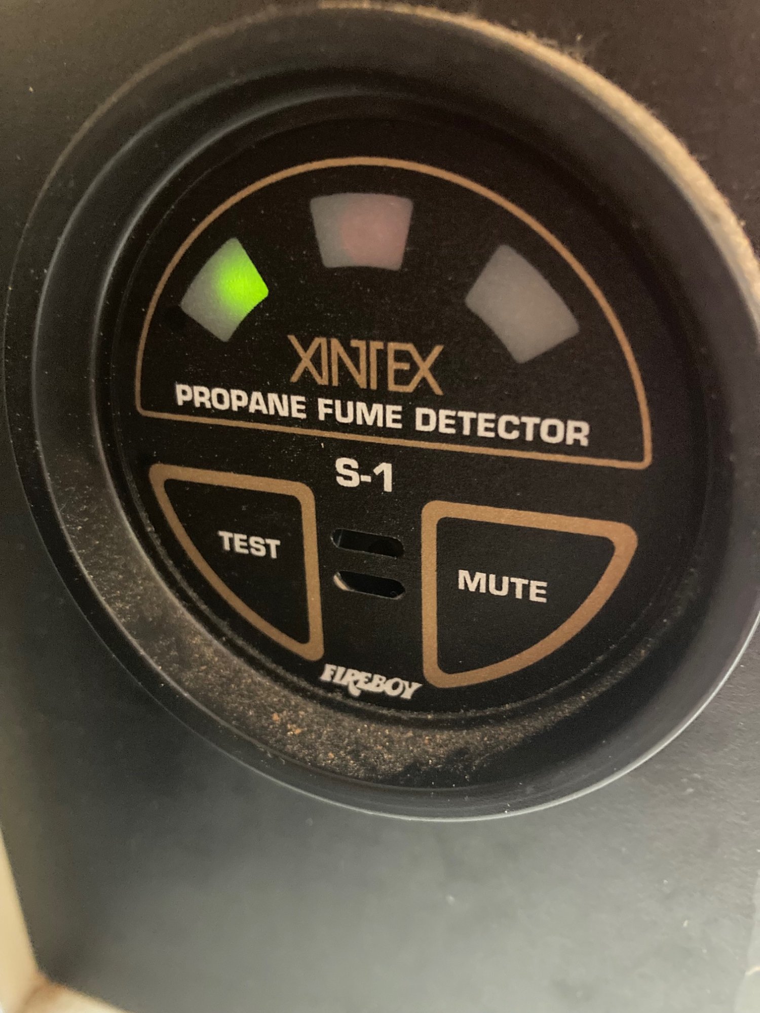

Just winterizing my Island packet and i always pour RV antifreeze into the bilge to run through the manual and auto bilge pumps.
Then my fume alarm kept going off, does the antifreeze have something in it that the alarm detects?
13,063
The alarms will detect almost any organic vapor, such as diesel fuel, alcohol, some cleaning compounds, and of course propane.
When Second Star developed a fuel leak the alarm went off. The other day my wife was cleaning under the stove and the alarm went off, the cleaning solution had some alcohol in it. Had to cut power to the sensor for an hour to clear the air.

propylene glycol
The primary components are either ethanol or propylene glycol. You may remember from your high school chemistry class that ethanol is the “kick” in Kickapoo Joy Juice—grain alcohol.
So I assume the vapor detector can pick up the ethanol vapor.

Yes, even charging batteries that off-gass have set a smoke detector off if you don’t ventilate the area. My wife found a new way last winter using an air-fryer. I’m glad we have a combination detector with voice alarms because I have lost my ability to hear the alarm.
