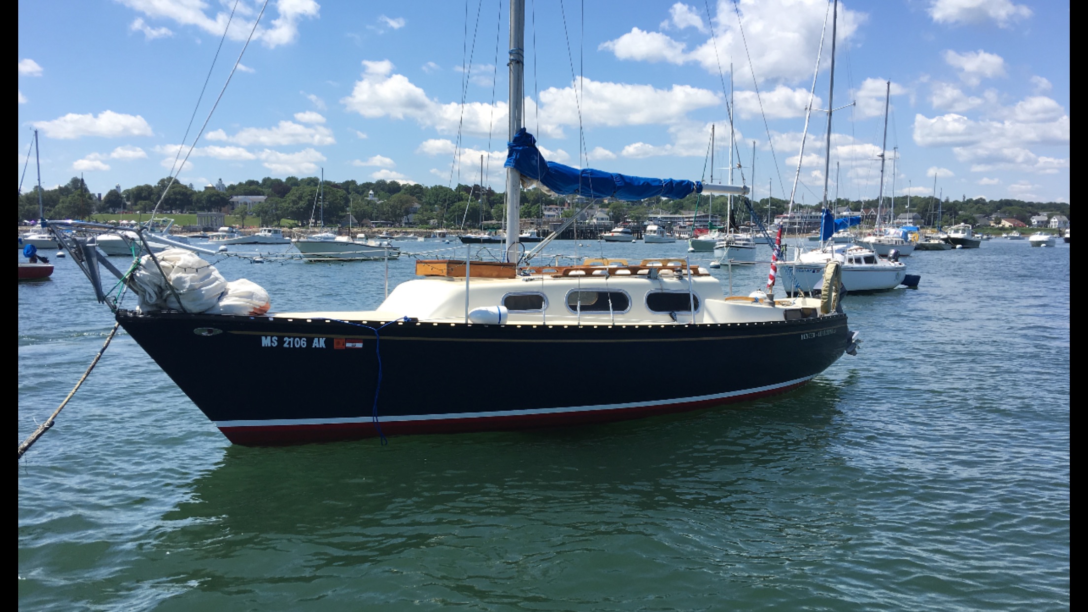

I've sailed for a number of years however I'm no expert on rigging. My boom has a topping lift on it which as most people know is nice since it keeps the boom from falling while the boat is stationary. However and obviously, it can't be attached while sailing since it impedes the mainsail from doing it's job. I need suggestions on how to prevent my mainsail from falling while sailing. Can I run a line from the mast head to the boom or would this act as does the topping lift, impeding the sails performance? Suggestions appreciated!

Depending upon how it is rigged a topping lift can remain attached. What is needed is a way to slack the topping lift so that it does not interfere with the mainsail. This can be done by placing a small block and tackle at the end of the topping lift. When sailing release the tension, when your done, take up the tension.
While sailing the mainsail leech will support the boom. If it doesn't then the sail may not be cut correctly or it may be the wrong sail.
Alternatively, the mainsail may not be at its full hoist or if the gooseneck is adjustable, it may be too low.
With respect to @Don S/V ILLusion suggestion of a boom vang, a rigid vang or a boom kicker will support the boom, but the main support should come from the leech of the sail.

I don't understand why you have a problem while sailing. Why does your boom drop when the sail should be holding it at the proper level? I can think of only 3 reasons why the boom should hang in an improper manner.
1. The sail is cut incorrectly.
2. You aren't raising the sail fully.
3. The sail has an excessively long leech by design - I've never seen this but I've heard that some designers have done this to increase sail area. The boom purposely drops at the end (so I guess this wouldn't exactly be "improper").
This assumes that the height of the boom at the gooseneck hasn't been altered from original design.
While sailing, you shouldn't need a topping lift or a rigid vang for the boom to be essentially at the correct angle. You will have to describe what is the matter.

Very nice looking boat! As said before, you shouldn't have a problem while sailing. How old is your mainsail? If the end of the boom droops unusually while sailing (with the topping lift slackened), I'd guess that the main hasn't been raised properly, probably due to shrunken bolt rope, as jsg suggests. No boat of this type and vintage has ever depended on a rigid vang or anything similar to maintain the proper sail shape and boom height.
14,197
Judging by how small the furled mainsail is, it is time to invest in a new mainsail. The cloth is probably very soft and stretched out. This lends credence to the shrunken bolt rope theory.
To make an adjustable topping lift, you can use one of these fiddle blocks at the boom, http://www.apsltd.com/29mm-fiddle-v-jam-cleat-tube-rivet.html, and a small block with a becket attached to the existing topping lift (which will probably need to be shortened). Then rig a small diameter line ¼" or 5/16" through the blocks. On the mooring, tighten the line, when sailing loosen it. Or in the conditions @thinwater mentioned, take up some tension to raise the boom.
Good catch. Shouldn't the main sail kinda fit on the whole boom? This one (admittedly inside the sail cover) looks like it only extends 2/3 of the way back? In the words of the famous Wendy's grandma lady, "where's the beef?"
