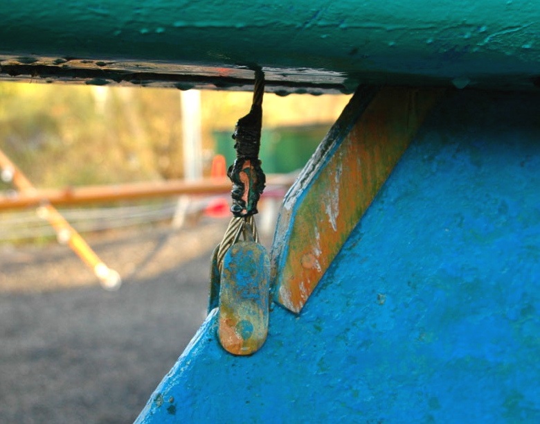

As many know, I changed my centerboard linkage and now use a SS cable from the screw gear to the board. Alden advisied me that I may have electrolysis problems with the SS. Niels was concerned that the connection at the board may have problems because it sits in stagnant salt water inside the centerboard housing when raised.
Since 2000 when I installed this cable, I've been careful to inspect it every haul as reccomended by Niels at Alden. After 7 Maine seasons, so far so good. I'll replace it this spring because of the obvious chafe on the nicro press fitting. I can't see anything that looks like galvanic corrosion on the bronze. Any thoughts on why electrolysis may or may not occur here? I assume the bronze would sacrifice itself if this were the case?
Inspection of the link plates and rivet to the bronze board look good as well. Has anyone had problems with these plates and rivet that connect to the bronze bar in the original configuration? The black covering on the nicro press fittings (doubled) is actually and amalgamated tape that was applied by the rigger in 2000. A very good tape I can see!

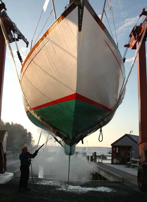

Love them or hate them (most who don't own them appear to be the latter), the Challenger has a formidable centerboard. With strong winds on a long sail just before this haulout, I sailed with a fully reefed mainsail (mizzen doused) and about a 120% (roller furled 130%)genoa forward.
This is a powerful combination for my boat going to windward in heavy wind and seas. In the strong conditions (heading windward in 25 knots, short steep seas) the other day, most noticeable is the lee helm from this combination of sail area forward. I was tempted to raise the mizzen to see it would add a bit of weather to the helm. But I had my hands full!
This is a good mental picture to have for this type of sailing. This extra depth and lateral plane (if that's correct) the centerboard adds is very evident in the boats sailing characteristics. While this may lack the new sections of todays keels, rudders etc., it feels like you've added a track below the boat to me. New sections, lift, etc. or not, this old design still will go to windward.
Of course she still likes to crack off a bit for the extra speed and power the boat needs to keep up steam in a seaway. And it's quite a wet ride, but she'll get you home.
