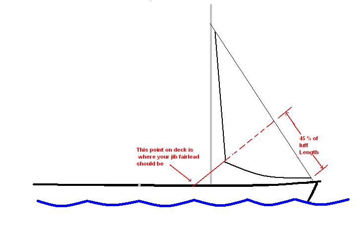

I don't think I was clear on what I was talking to Darrell about and I"m sorry I threw Jackdaw off. Adjustment was the wrong term. It was the initial setting a sailor would use going from one tack to the other -- a setting to get him in the ballpark. It's a ballpark because the wind is ever changing but he has to start somewhere. So, when I start out both fairleads are pretty much in the same position and we're probably only dealing with about 6"to 9" of adjustment anyway. I know the number pin hole I'm in (they used to be numbered until I converted to the Garhauer adjustable system) so depending on the way the sail "breaks" I know whether I have to go forward or backwards on the next tack to get me in the ballpark. Stepping on the sheet might be necessary to make the final adjustment -- I never liked that method but it was my only option until I purchased the Garhauer system, which happened to be 3 weeks after I bought the boat.
Nov 8, 2010
11,386
Ah.
The starting point is to have your sheet almost bisect the headsail. This will give an even telltail 'break' in most wind conditions.
A clever idea is to mark this line on your clew. Many sailmakers will do this for you, but if not you can mark your own with sharpie, or with strips of sticky-back dacron sail tape. Like this.
Back about here to de-power.

The designed sheeting angle is a straight line perpendicular to the luff that passes thru the clew, extending to the deck. Your picture was good.

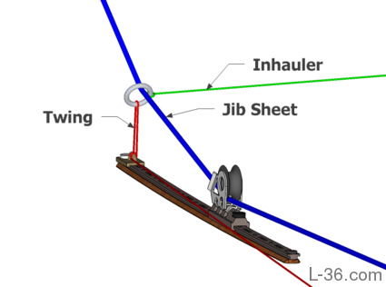

I've thought about adding a second sheet that goes straight down. Then the primary jib sheet car could be all the way back, and you just tighten the one that goes straight down until the sail shape is right. Yes, it would be an extra line every time you tack, it make adjustment on the fly much easier.
I'm with Daveinet on this. Low friction adjustable jib lead cars are really far down on my priority list, but I have most of the tackle needed to try this. This would be a variation on the inhaler used on modern race boats. I'd set the jib car at the aftmost position for the sail, then set the downhauler at 90 degrees to the sheet when close hauled, and lead the line back to the stern cleat. The load on the down haul may be low enough to adjust by hand. I think this would be fun to try. Can't wait for spring!

OK, I just deleted my whole post as I rethought this one more time. Originally I was picturing tying the extra sheet directly to the jib, but that looses some leverage. If one puts a pulley right at the end of the car track, and then have the extra line go straight up and attach to the jib sheet directly above the pulley, it would pull down on the jib sheet, the same way the car does. Since it is midpoint in the line, it shouldn't take much extra force to pull it down. Not only that, but the time when you need the most twist is when the wind is the lightest, so it should be easier to pull down.
This is the setup I was thinking about if you ignore the inhauler. I stole the pictures from a google image search.
svquest, your statement is incorrect. The illustration that Jackdaw posted was a method to establish a starting position for your genoa lead car on a beat. In most instances, the proper average genoa lead position would not be perpendicular to the luff. The illustration shows the starting point of the trim line on the luff at 45% of the luff length from the tack. Project a line from that point to your clew and you will have your average genoa lead position. What you described is the method of measuring the luff perpendicular (LP) of a headsail.

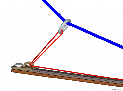

If you want to go on the least expensive side Pac is on the right track. They are variously called barber haulers, tweeters, lead goddamits and other salty terms by region, but all have the same net result of changing the sheet lead. A block on the toerail, a block on the sheet and some spare line to connect it all and a place to cleat it off. If you are cruising and are not trying to squeeze every fraction of a knot out they will work fine. You need to let off on them BEFORE a tack and make them up afterwards to reduce loading but will give you what you need by digging through the boat spares in most cases. Many a racer use them to increase spinnaker control.

PAC- I didn't quite picture it in that great of detail, but now seeing the pics, what you show is even better. I didn't get the slip ring part, but now having seen it, that means one does not need to adjust it every tack. There is also a little leverage built in with the multiple wraps of line. I've already got a loop closer to the clew, so all I will need is an extra jam cleat next the to jib sheet jam cleat. Should be cheap and easy.
Actually, my mistake was trying to answer a technical question a 2 am. You're right the angle is roughly 45%. What I forgot to add was to take that LP line and the line of the leech and draw a line thru the clew that bisects that angle. Which will give you the designed sheeting angle (the 45% of luff can be off due to the height of the clew or having a very low clew).
