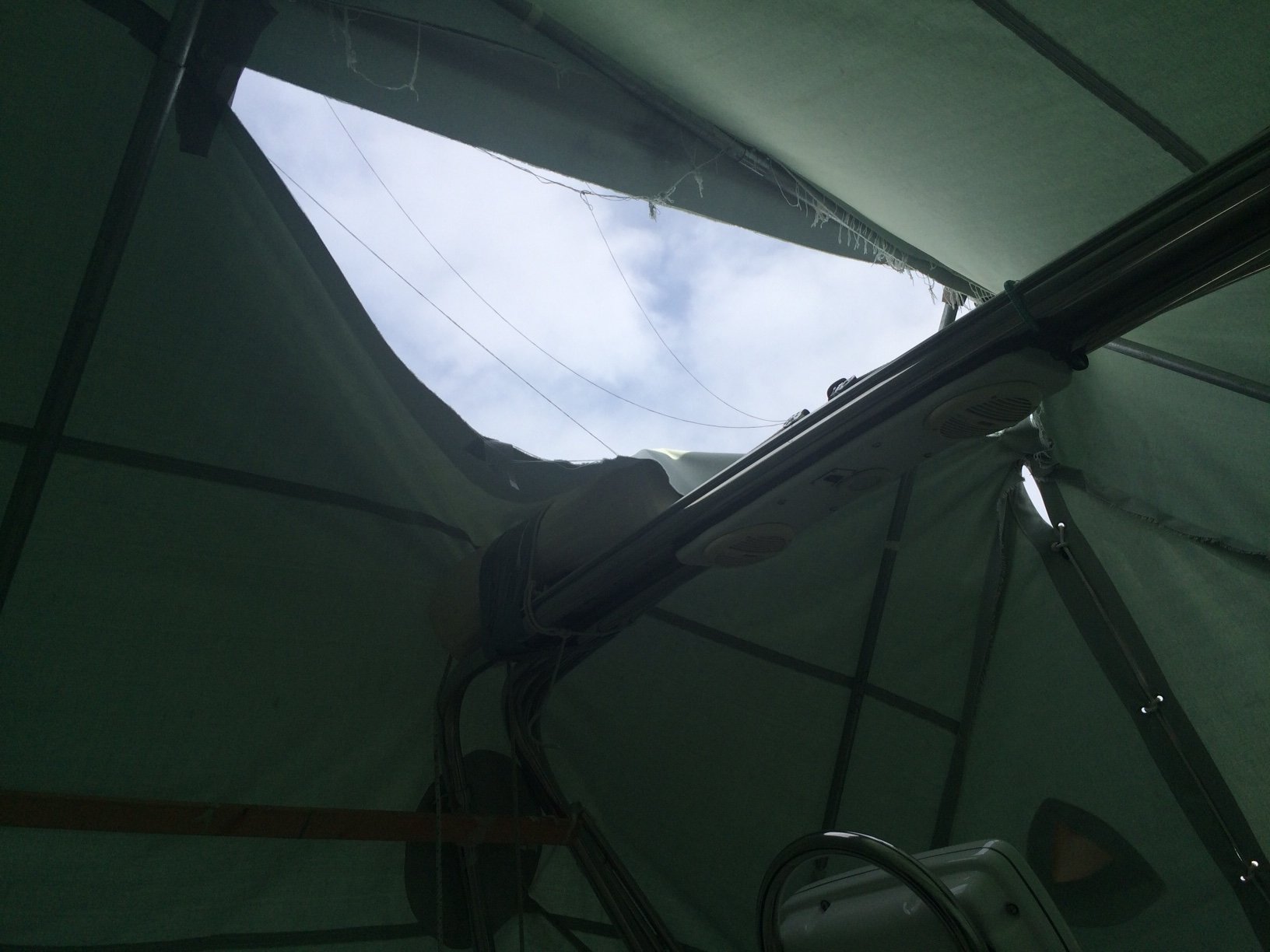

Looks like my Fairclough cover finally gave up after 10 years of protecting our boat. I've got about a 4 foot tear just below the ridge seem at the aft end of the cover. I'm thinking Fairclough may be able to repair it but closer inspection of the cover shows numerous weak and worn spots due to wear and tear. So the question is, do I try to have Fairclough repair the cover, have them build me a new cover or just go with shrink wrap from next season on out. The cover is actually a two piece cover and fairly heavy. I've been installing it each year with help from friends but its getting harder and harder as the aging process continues. Fairclough charges ~ $600 to install and an additional $600 to remove which works out to be roughly what my marina will charge to shrink wrap each season.

Check with a local canvas shop. They may be able to replace a panel for less than Fairclough, they tend to be expensive. $1200 to put the cover up and take it down? That's outrageous!

I have used a Fairclough cover for 19 winters. I have also experienced small and large rips, especially over the last 5-6 years. I have re-sown many of the seams and zippers myself on a SailRite sewing machine. Last winter I had a seam open up next to the ridge pole that stretched from stern to the mast. Because I was unable to restitch that seam myself I took the cover to Fairclough and had them re-stitch all of the panel seams in the entire cover. They told me that re-stitching is necessary about every 10-12 years.
The covers must be protected from any sharp edges. It looks like yours opened up at a seam and if that is true then it is typically a thread failure.
This last fall when I installed the cover I had a zipper fail. I did a temporary repair on it to last over this winter and I will be replacing all of the zippers this summer. I think that the UV over 19 seasons has damaged the plastic zippers. Unfortunately nothing lasts forever and everything requires maintenance. The people at Fairclough told me that they have seen covers last up to almost 30 years with periodic maintenance.

One thing to consider if you do have your cover repaired, Fairclough will cut it into 3 sections, which makes it much easier to get on and off. After our first season with a 2 piece setup we took it back and FC make it a 3 piece cover....so much easier to handle.
I also use pieces of the cheap foam pipe insulation you get at HD to protect any sharp points...

I had a 2006 H29 and a Fairclough cover. After Superstorm Sandy the boat was lost (see Avatar) but I still had the cover. Got a H33 and figured I would try and adapt the cover. I found the exact fabric and I added a panel and split one so now the cover has 4 pieces. Only really hard part was refitting the cover zippers around the shrouds. Much easier to handle the smaller lighter pieces putting them on and off.
1. I also started using zip ties instead of strapping tape in some areas.
2. Added some of the horizontal boards using 1"x3"x8' furring strips from HD $1.37 each
3. Added a couple of port to starboard skeletal framework pieces using the same size electrical
conduits (EMT) from HD. Lengthening them and the ridge bar using internal splines with rivets, and joining some with EMT set screw couplings (about a buck each).
4. Added grommets along the bottom edges.
5. Patched any weak spots making a double layer of fabric instead of cutting out pieces.
Used a Sailrite sewing machine and weather resistant thread. Seems to be working fine two years after the adaptation. The cover is 10 years old now.
