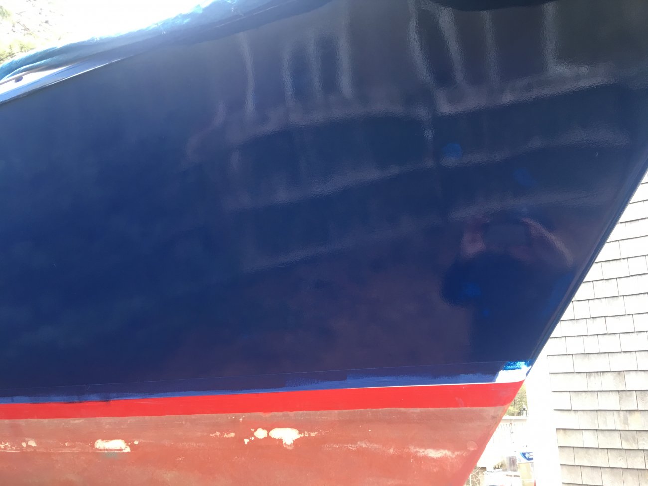

Taking a survey of those who may have had the same issue as I. Painted with oil based enamel, rolled then tipped and left substantial brush strokes even after thinning. Tried to roll over it now I have a combination of orange peel and brush strokes (painted 3/30/19).
Choices:
1. Sand down with finer and finer grit then repaint - (my choice and I believe the most effective)
2. Polish with a automobile grit polish no repaint
3. Use a windshield wiper and push paint into orange peel (as suggested by a forum member)
4. Or just leave it alone!
