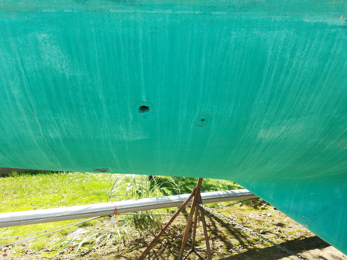

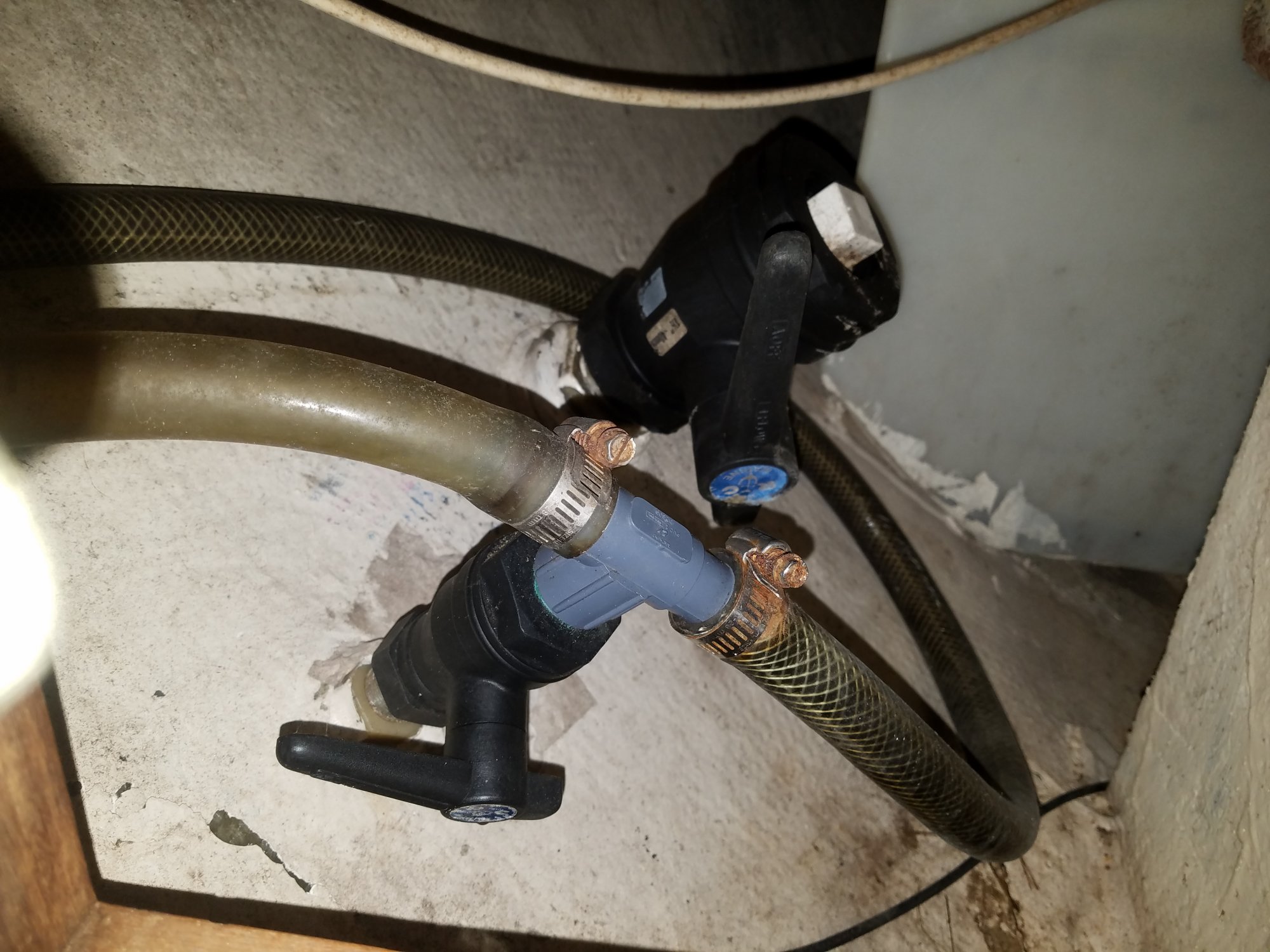

I was wondering if anyone knew what this thru hull may have been intended for on a C30 MKI. If you look at the picture of the hull it is the larger thru hull that is forward, and the pic of the inside it is the thru hull in the back with the white plug in it.
The original owner of the boat said that he never used it and when he bought the boat new it came like that. He said he thinks it was for some kind of option that they automatically put in, but I'm not sure what that could be. Does anyone know or have a guess what type of option would have warranted that thru hull? For reference the one in the fore ground next to it is the water supply for the head and the head sink drain.

I was wondering if anyone knew what this thru hull may have been intended for on a C30 MKI?

What are the dimensions of the thru hull. 3/4" to 1" is usually an intake supply line or drain. 1.5" or bigger is usually a Waste line.
How big are the holes?
Where are they in the boat? (i.e. near a waste tank or a compressor?)

They are both in the V-berth next to the water tank. The smaller one is either 3/4' or 1" and is the intake for flushing the head and for the sink drain. The larger one is probably closer to 1 1/2" and is not near any other gear. I am not sure if there were options that could have been installed on or by the water tank.

overboard waste discharge?
That's what I thought at first and that it was maybe a direct discharge, but the head discharge connection faces aft and the holding tank is aft of the head, where this is forward of the head.

Wash down supply for anchor locker? Just thinking, raw water supply to the head and overboard discharge from a wye valve after the head?

On my '86 MK1, that is the direct overboard waste discharge. Hose runs from a T to here...one direction from the T is to the holding tank, the other runs to here. Accessed through a low locker door in the head.
Thank you.:thumbup: I thought it was in the wrong direction to be a direct discharge but that does make sense the way you're explaining it.
Now I just have to figure what to do with it. For whatever reason, having a large extra unused hole in the hull really irks me.
