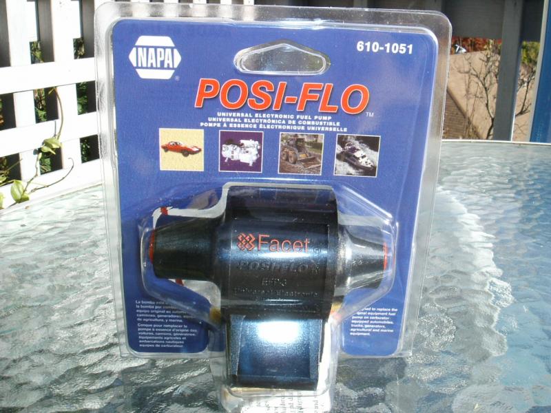

Sep 15, 2009
6,244
S2 9.2a Fairhope Al
i will post a pic of the Napa package tomorrow some time ...it was 46.00 before the governor took his part 7% sales tax.....i like the idea of the ball valves and toggle switch part too...i have the pump installed now and it is working great ...thanks to all ...oh and it is coast guard approved by the way ...directions said to fuse it with a 5 amp fuse...
regards
woody
Sep 15, 2009
6,244
S2 9.2a Fairhope Al
Re: Is that
yes it is Phil.....according to the directions you are supposed to mount it as to where the inlet and outlet are vertical...inlet on bottom and outlet on top....and it is coast guard approved.......

Thats a new one
Never heard of a pump that was both gas and diesel. Guess I'm just getting too old.
Sep 15, 2009
6,244
S2 9.2a Fairhope Al
sorta surprised me to.....i couldn't get over the fact that there are some that push and some that pull and some that do both lol.....
